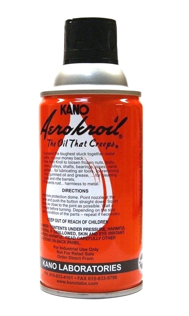

I would vote for Kroil being best, having used it in a shop, but price/availability steers me to using PBB for personal use.

Aero Kroil gets my vote too. Use a wire brush first to remove heavy debris that restricts the penetration. Aerosol applications for underneath use too!
The narrow spray tube concentrates stream to the fasteners joint. Better than PB Blaster IMO.

I worked for Boeing, Downey and Huntington Beach for 6 1/2 years. I worked in the Structural Test Lab at Downey, and at Huntington Beach. We tested Delta II and Delta VI Heavy rocket stacks. Of course these tests were non-fired and were performed outside.
The facility was located about 2 miles from the beach. The salt air was brutal there. The Kroil product we used was Sili Kroil. This stuff just melted the rust off the hardware that was left out in the weather for years. We bought it by the case.
If we had a stuck piece of hardware, we'd hit it with a liberal dose of Sili-Kroil, then the oxycetelene wrench, then more Sili Kroil and walk away for a bit. When it was cool enough to handle, it would almost unscrew itself.
The downside is, it's pricey. Anyway, give it a try.

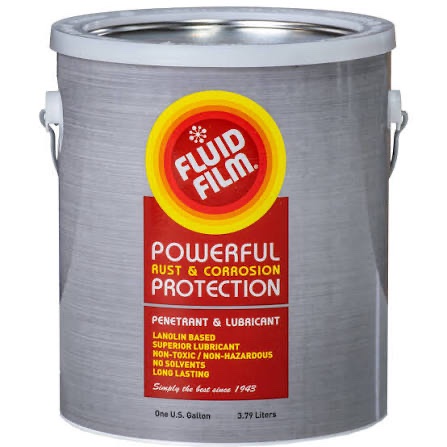

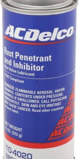

For the most part I use GM rust penetrant…used to use the same stuff years ago from AMC at the Jeep dealers I worked at. It was called heat valve lubricant then, for the old exhaust manifold heat valves. It works pretty well but sometimes the flaming nut buster is the only way. It’s not cheap but less than Kroil.
Another thing I have started using is Fluid Film rust inhibitor. I use it in a rustproofing gun a spray cars around here the help fight the salt. But it works pretty good on rusty bolts too. Has a wicking effect also. It seems to work good on rusty bolts that are in aluminum better than some things. Available at NAPA and Amazon. They make a spray can too.

I don't see an answer to your question.
"but this is a comparison question between two commercial brands."
I am also interested in the answer.
Does the PB work as well or nearly as well as the Aero-kroil??
The last Aero-kroil I bought, in the "economy" sized can was $40. Ouch. I see that its over $30 for a 16oz can.
I see that PB is $7 @ Horrible Freight. Or, maybe, I make my own.
If they are comparable, I would get some PB.
I use the Aero-kroil now. It works very well.

Re: Rust Penetrant
I read an article about the chemical makeup of Kroil. It used to be made by a small company in Tennessee. The owner held a patent for using a super-refined oil, which is what gives Kroil it's penetrating power. It really DOES sneak into a space as small as one millionth of an inch. They used to send me flyers all the time, and I bought numerous spray cans, and also 1 gallon cans of Kroil and Aero-Kroil, especially when they would send me their discount coupons, which arrived monthly.
A couple years ago, the family sold it out to some venture capitalists, who reorganized the company, and decided to raise the prices. The prices went up about 4 times, versus what they had previously been. I still order it, but now in just 8 oz cans, and I will probably never buy a gallon can again. I think my last gallon can, which I am at the bottom of now, cost me about $19.00, which included the shipping. I believe a full gallon of Kroil now is well over $100, and the shipping is additional.
Kroil IS very good stuff. It is the BEST penetrant I have ever used. It has NEVER failed to make even the most rusty assembly disassemble with just hand tools, with NO RESORT TO TORCHES, chisels, or other crude methods. I have not broken a bolt, or sheared a screw off, in MANY YEARS. Between Kroil, and then EVAPORUST, the parts I work with look as if they are new from the factory. No erosion, no sandblasting damage, all the rust completely erased, and the fasteners and parts look like they could have been mailed from the original auto factory as spare parts. The metal is smooth, and unmarred. (Except for obvious wear areas, which must then be repaired with bronze or steel insert rings in areas that show heavy wear, to return them to completely like-new condition.)
I know that people have said to just use some solvent with automatic transmission fluid in it, and it is "as good as Kroil" but my opinion is that it is NOT. The company that holds the rights to the Kroil formulas, possess the magic that comes from using the super-refined oils that the owners of Kroil developed and patented years ago.
Like Evaporust, Kroil is a special chemical that DOES possess special qualities, and these are unique to that special product. The problem I see with Kroil is the EXTREMELY high price per ounce of the material. I used to literally wash down an engine with it, and then let it sit before I tried to take it apart. NOW, I apply it with a delicate squirt can or syringe, directed only onto the specific part I am trying to disassemble, and repeat the application dabs over a longer time, to achieve the same results, but at a more reasonable price. It takes longer to disassemble mechanisms, but it still is the difference between success and frustration, damage and simple disassembly into component parts. After 50 years of using it, I am very sure that anyone who has used Kroil for an extended time will agree with me.
I just want people to understand that it is NOT just salesmanship, or advertising, that makes Kroil a good product. It is intrinsically good, just from it's very makeup. That is what makes it special. As with EVAPORUST, there IS a specific difference you will see when you use it.
I have no interest in the Kroil business, or any connection with them, beyond being a long-term purchaser and user of their products, which I have always paid the prevailing price for. I can only say that Kroil lives up to every claim they ever made for it.
