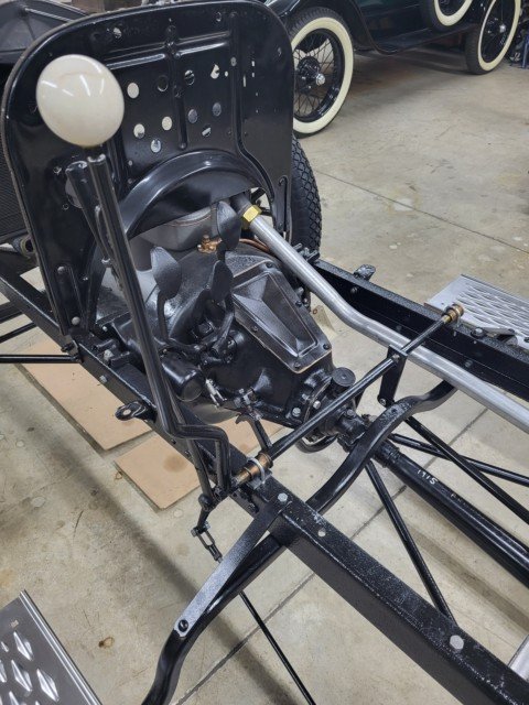

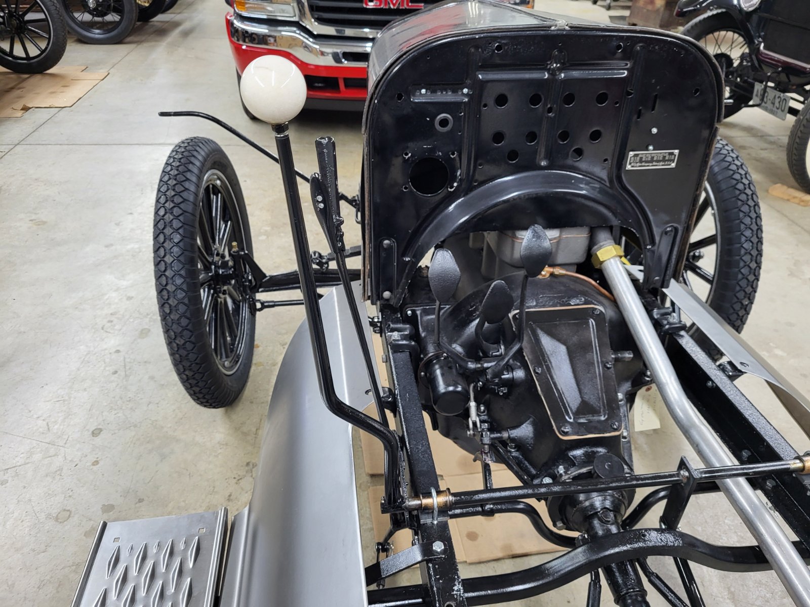

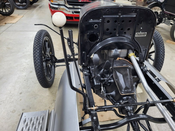

Take a spare parking brake unit. Mount the pillow blocks right behind, in line with the car's parking brake.
Remove the clutch cam. Remove the brake ratchet disconnect lever, pawl & rod. Weld up the holes.
Get fancy & do some shaping to the handle base until it looks like the second lever off an early 09.
Bend outward to clear the parking brake lever.(optional)
On the cross shaft, you will need to add a length of 1/4 x 3/4 iron stock to connect to the Rux shifter rod.
Direct will be back on the lever toward the seat.
Makes for a cleaner looking set up than the available kits. Rux shifter.jpeg[/attachment]
Note the shifter rod has an adjustable clevis to fine tune the lever's location. The bar it attaches to has multiple holes to set/change the lever's throw.
The rod has a fixed clevis in the Rux end & is made from 1/2" thin wall conduit.

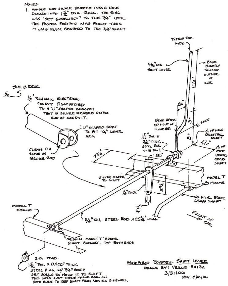

Re: 26-27 LEFTHAND RUCKSTELL SHIFTER
I saved this picture some time ago, can't remember where from, says it was drawn by Verne Shirk so obviously not my work. Was going to try and make a similar shifter when time permits.
