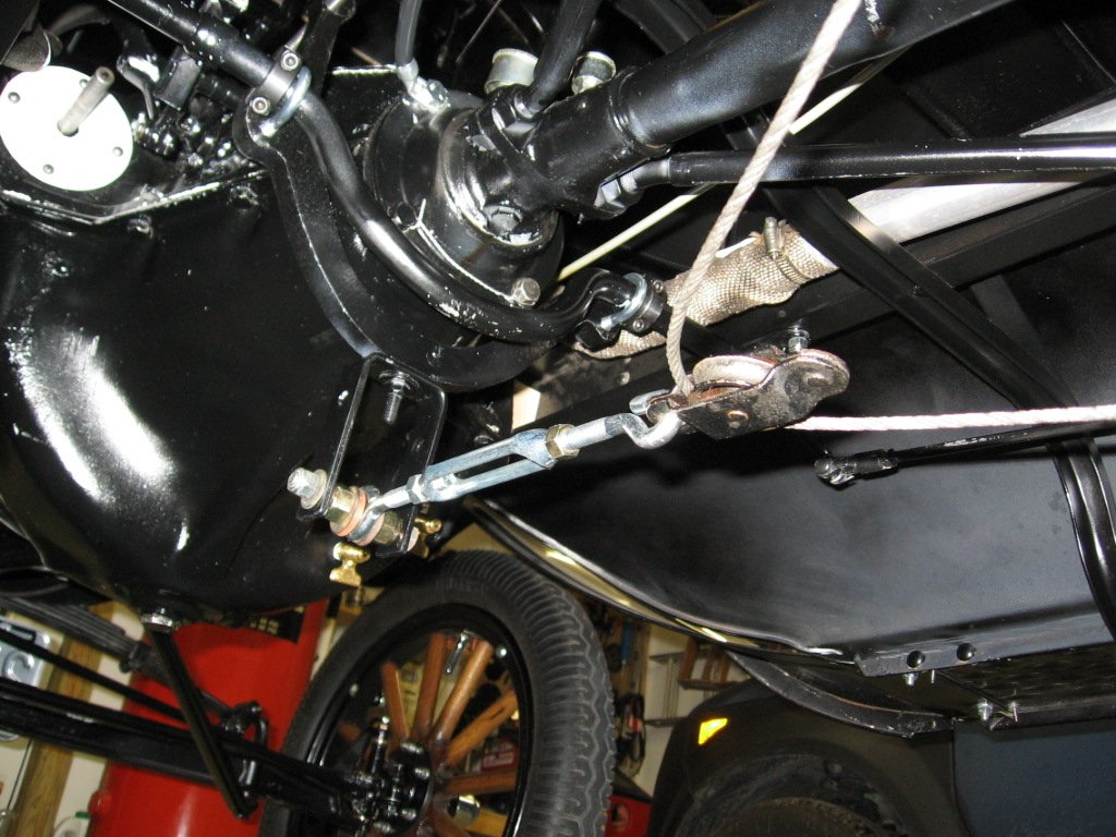

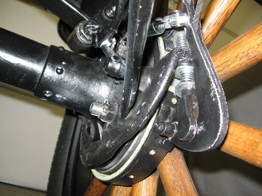

I use one to actuate my homemade pulley & cable setup that goes to my original AC brakes. Works well for me.

The original RM & other brands used a cable set up & equalized by pulling the center of the cable with a pulley. No additional equalizer needed.

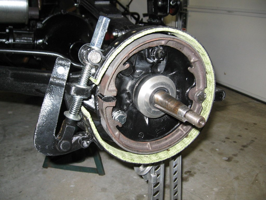

As far as converting lined small drum parking brakes to a service brake. Its doable, but you would want to sync your transmission brake so they work together. I have a small drum outside lined brake band (like an AC). The transmission brake is synced to it. They work excellently. I still have lined parking brakes as a separate system.
