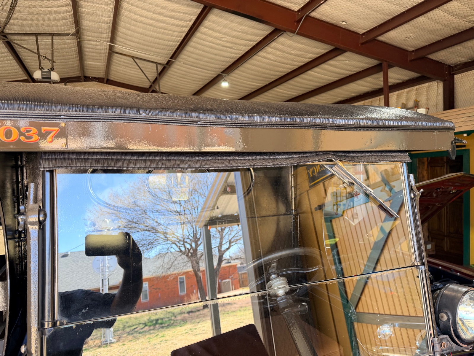

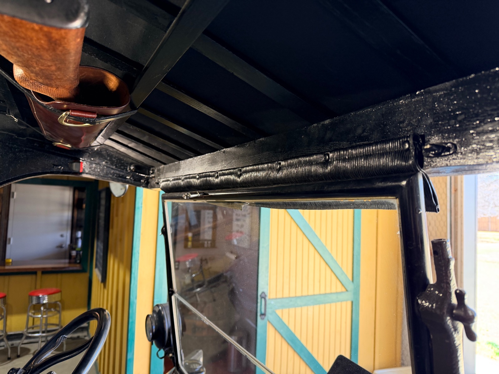

Post by abcarswell » Mon Mar 02, 2026 3:36 pm
I figured since I was posting today, I’d revive this old post and show how my Visor turned out. My sister is a pretty good seamstress so helped with sewing up some of my excess top material which I finally got around to installing today. I’m happy with the results.
