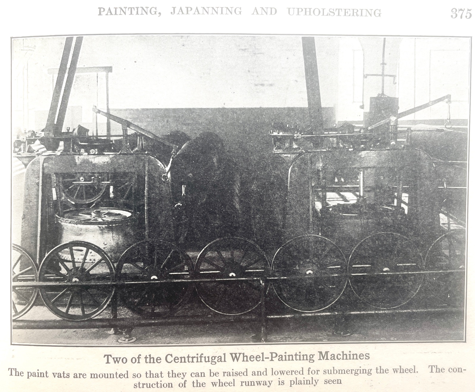

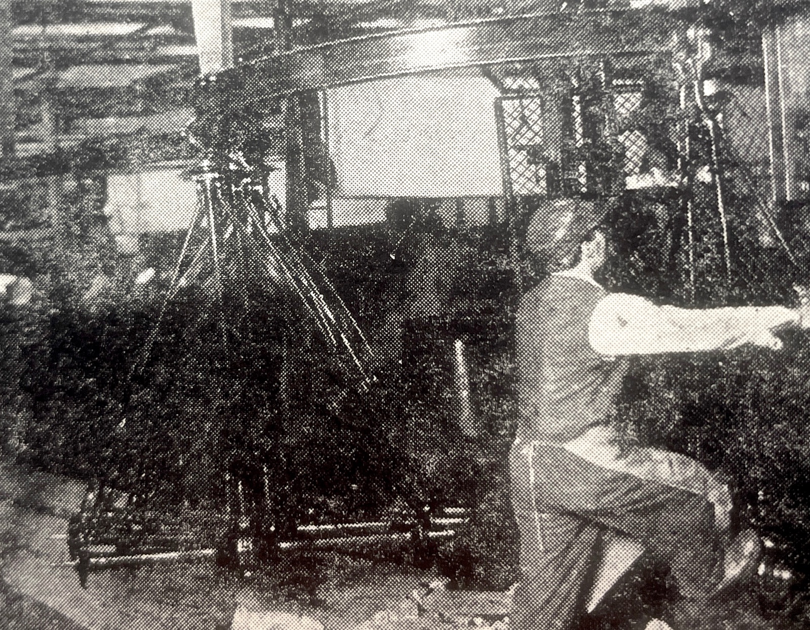

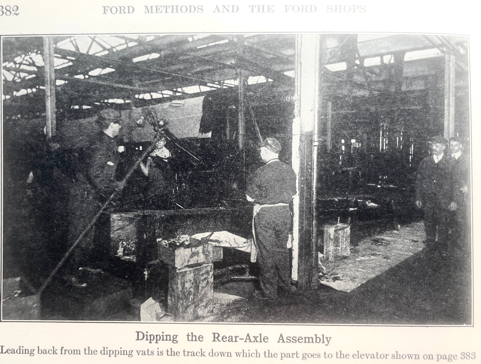

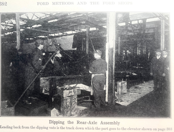

- Posts: 4084
Re: Wheel color
Photos from 1914 of the painting process for wheels and rear axles, Ford Methods and The Ford Shops.
Wheels were spun painted, at 750 rpms first coat, then lower rpms for second coat. Stacked and dried.
4000 wheels a day by 27 workers.
Rear axles were assembled and dip painted.
