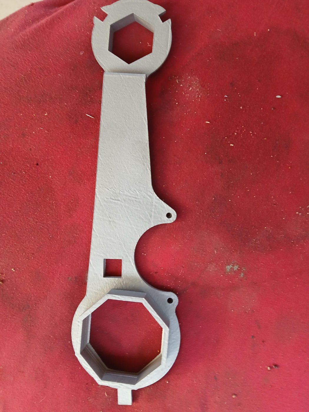

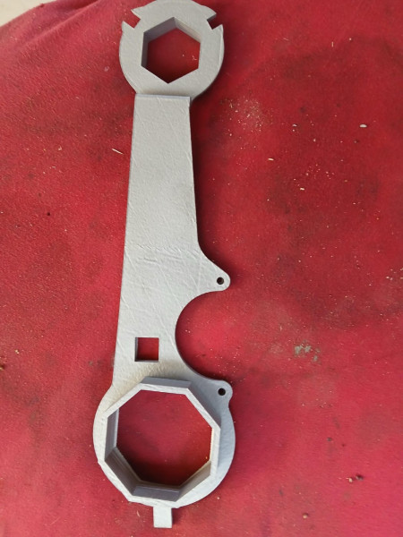

This was made from picture of the wrench, creating a cad file and sent to a 3D printer shop and printed out of stainless steel for ~$120 . All I know for certain is the hub cap end of the wrench fits and I have pressed pins into the spanner pin holes. I haven't a clue what the rest of the wrench is supposed to fit thus I haven't checked it for proper fitment. The wrench is now painted

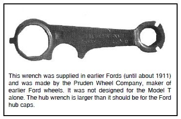

I am not an early car expert but here is what the Encyclopedia has to say about this wrench.
It's more of a non company specific universal wrench.
Hopefully someone knows that the features actually fit.
