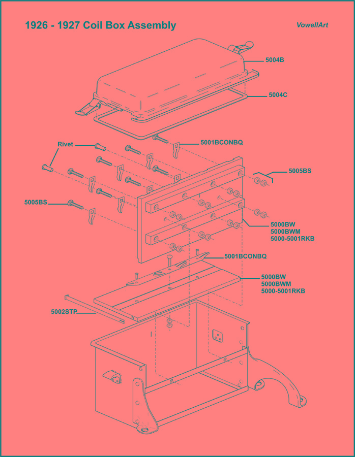

I'm assuming that you have a 26' coil box since that's mentioned in your profile. If not this link has all the other diagrams https://mtfca.com/phpBB3/app.php/gallery/album/9
