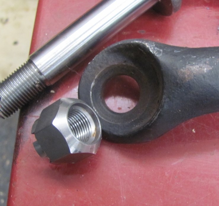

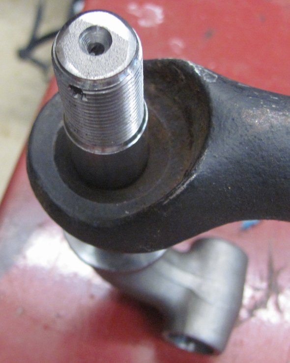

JZSlenker wrote: ↑Sat Mar 14, 2026 3:46 pmHello everyone,
I'm trying to find a picture of the perch nut end of a wishbone that uses the tapered nuts. Back story... I still have a death wobble at 20mph after changing king pins, king pin bushings , perch bushings and shackles, steering bushing, tie rod bushings, wishbone cap, pitman arm and tie rod ball end. Everything is nice and tight but I still have a wobble. Today I noticed the wishbone ends were a little bit walled out. The shoulders on the perches are pretty good still, although I'll likely replace those. I figured I would add some material back to the end of the wishbone area by tig welding and re drill and machine back into shape to tighten it up. Unfortunately I can't seem to find any good pictures of what it should actually look like. I have an idea but would love a picture of one that is in reasonable shape. Thanks in advance.
JZSlenker
Topic author - Posts: 48
- Joined: Sat Jul 26, 2025 7:15 pm
- First Name: Jason
- Last Name: Slenker
- * REQUIRED* Type and Year of Model Ts owned: 1924 Model TT
- Location: Harrsiburg, PA
Re: Wishbone End Picture - fighting death wobble
Mick, thanks! That is perfect. Pretty much what I thought but wanted to be sure.
I have new nuts on the way.
Axle is straight.
Holes were tight just bushings shot.
Out of curiosity, what is the Stevens front axle tool?
Axle is straight.

- Posts: 5557
These might help if the taper in the wish bone is worn.
https://www.snydersantiqueauto.com/prod ... &cat=41626
Dan, that’s really cool. I can see that that would be a great solution if the steel itself were damaged. Thanks for sharing.
Mark, I saw those, but I think I can handle machining new tapers after welding more material in. I have a mill at the shop in my office.
