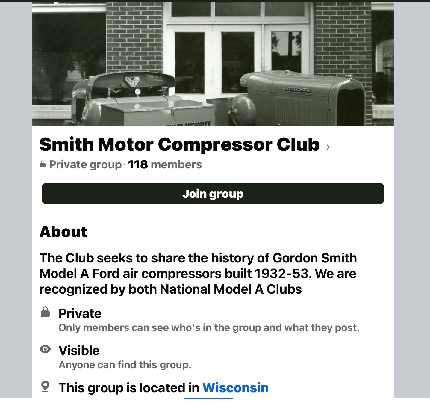

Here is one pdf file with good discussion.
https://share.google/6DB88t8Wo2PztQ5Gh
And there is a private FB page pertaining, you could join to ask for assistance.

thanks for this link ... i am mostly concerned about the unloader configuration ... i have several model A Gleaner combine engines with the governors and carburators inplace , this would be a good base for throttle control ... the unloader valves are inplace on the cylinderhead , but no control valve ... will contact the club to see what they have available or have adapted ...there were several of these units around when i was a kid , i remember that they did move a bunch of air ... Gene French
