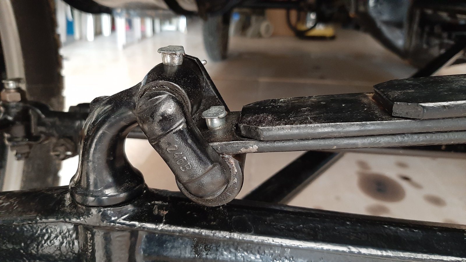

Hi all - I purchased a new 26/27 front spring from Langs and it doesn't fit right. When I attempt to put the shackles on, the oilers on the spring get hung up on the perches on both sides, so the movement is very limited. Doesn't seem to be enough clearance between the perch and the oiler. From what I can tell, the main spring leaf is thicker than my original. Any help or advice you have would be appreciated. Thanks.

A picture would help. Are the oilers driven in too far? Is the issue that you can't fit the Shackles?
- Posts: 5278
Re: Front spring 26/27
Yes to the picture.
As I read it, the oilers are not installed deep enough.
There isn't much room between the top of the oiler & perch. The lids have to be pointed toward the spring center.
There is just enough room to open the lid to get your oiler tip in.

Thanks, all. It could be that the oiler needs to be seated more within the spring leaf. If you look at the picture, the oiler gets hung up on the perch on both sides.

The oilers will need to be fully seated. When the weight of the car is on the spring, I think the oilers will have a little more clearance.
Many new springs are on the stiff side. A few hundred loaded road miles will usually limber them up and they will usually settle a little. Tightening the spring to cross member clamps after a couple of hundred miles is a good idea.

Thanks for the picture. Now i understand. I thought you couldn't get the shackle in. Get the oiler in deeper and put weight on the suspension and It should clear.

The oiler in the photo is put in incorrectly.

Larry, obviously the oiler isn't driven in far enough, but does the orientation of the flip top lid matter, or are there other issues with the picture?

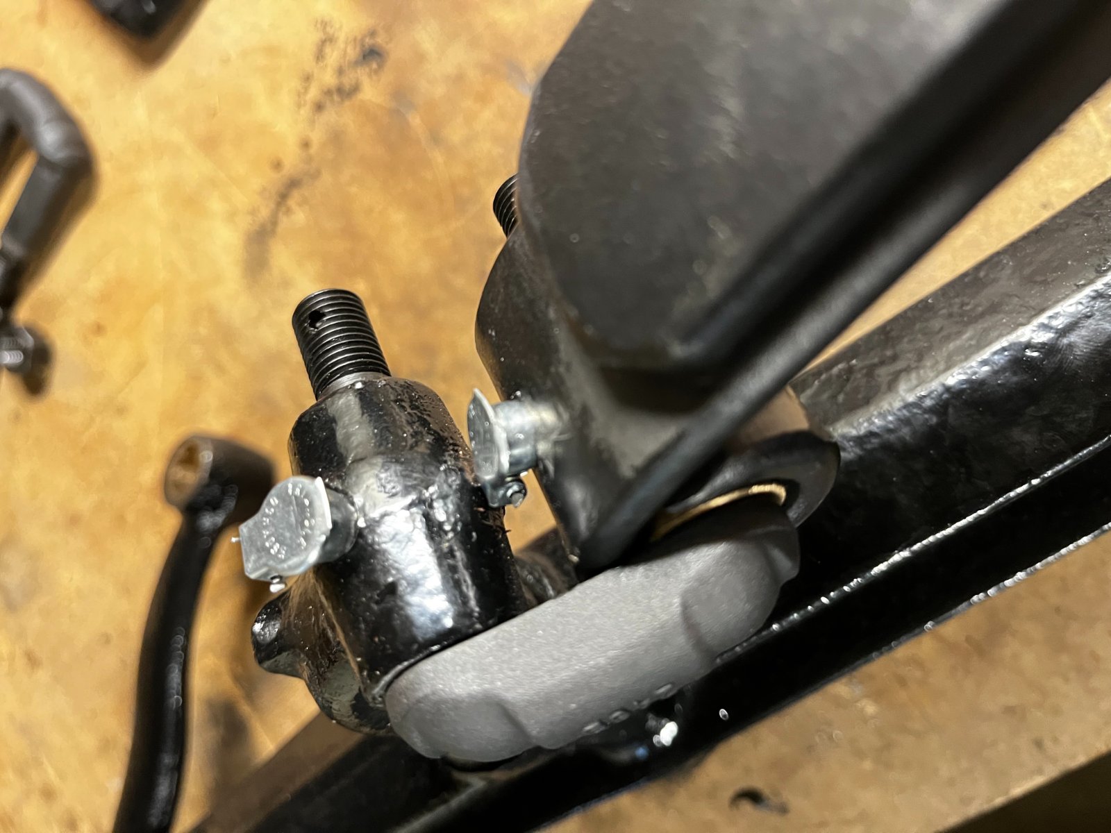

The oilers shown in the service manual appear shorter than those sold by the vendors. I mounted them with the cover opening from the front, but even so, they open fully on my original (or at least old) 8 leaf front spring.
Eric Sole
- Posts: 151
- Joined: Mon Jan 07, 2019 4:25 pm
- First Name: Eric
- Last Name: Sole
- * REQUIRED* Type and Year of Model Ts owned: 1927 Roadster
- Location: Barcelona, Spain
If memory serves (which it doesn't do much lately) the reason I mounted the oilers 90 degrees off was that the hinge contacted the shackle.
