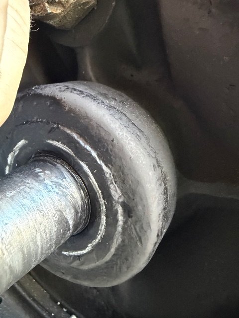

When I tighten the rear axle nut on my 14 the wheel locks up. I put some black paint on the axle seal cap and when I tighten the axle nut it shows the back of the hub is rubbing the axle cap. What is the problem and the fix here?

You don't have a felt under that modern seal cap, do you ? Not enough room if so.

That photo doesn't show a real Ford part. Why not try doing it correctly?
