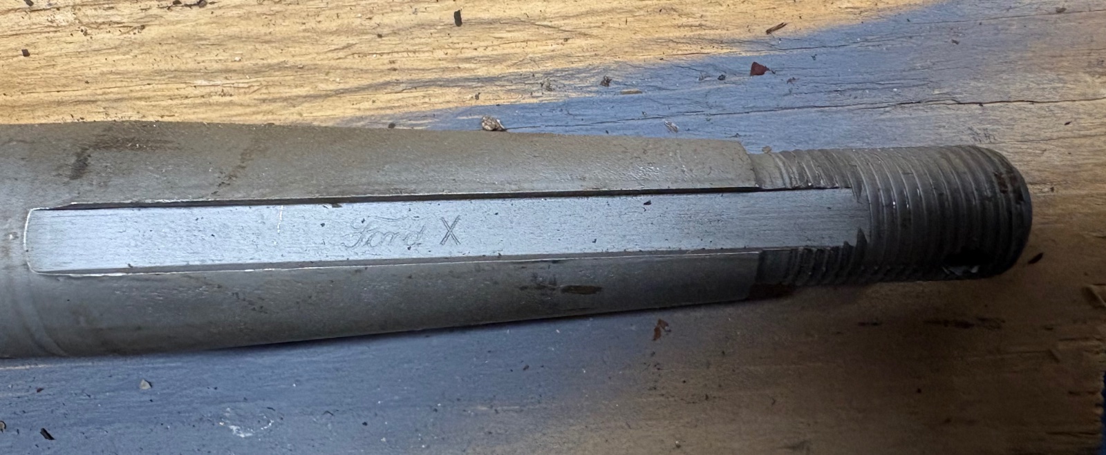

The following is an excerpt from The Reminiscences of Mr. John Wandersee:
All during this period from 1908, when vanadium had been perfected in the heat treat process to be used in the Model T car, we were experimenting constantiy on metals. On a lot of parts, like axle shafts, we got much better service and life on the manganese carbon steel properly heat treated than you could get out of a fancy alloy steel. For instance, when we were using chrome vanadium steel
for the rear axle of the Model T car, after we had about 10,000,000 cars on the road, you could drive from here downtown any day you wanted to and see two or three rear wheels laying on the pavement.
We had to stop that. We couldn't redesign the Model T car but we had to stop that. We cut out the chrome vanadium。It wasn’t so much cutting out the chrome vanadium, it was going to a different heat treat. We devised by proper analysis manganese carbon steel and then heat treated it to give us the desired results. We dried up everything. We dried up our rear axle trouble and our crankshaft trouble. We had a lot of crankshaft breakage. We substituted manganese carbon there too, properly heat treated.
- The Reminiscences of Mr. John Wandersee, page 47.
Ford designated carbon manganese steel as type EE steel. Vanadium steel was designated as AA or AAX steel. According to the drawing for the rear axle shaft, shafts made from EE steel were identified by stamping the name “Ford” in script in the keyway of the axle.

- Posts: 7330
Re: Breaking a rear axle on a Model T
That's interesting Trent.
I have a number of axles with the Ford script in the keyway, but I was not aware of the significance. In mining stuff from my stash at the farm, my spares could have come from any rear axle assembly, but while i do have Ford axles so stamped, I do not have many big brake drum housings.
