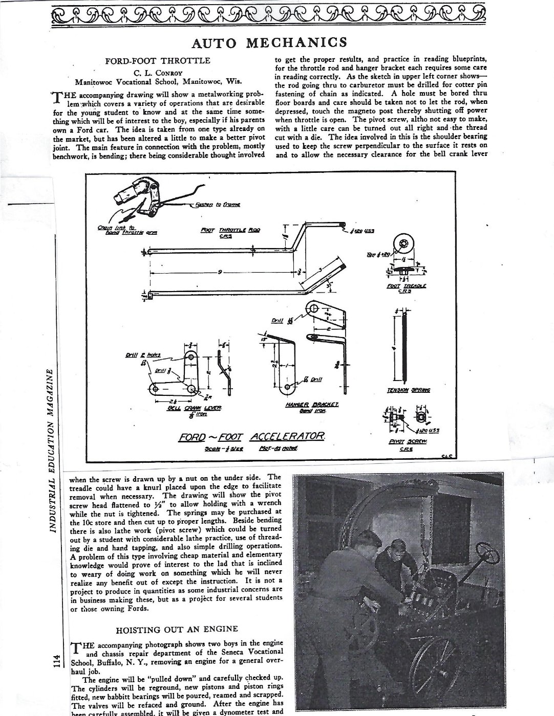

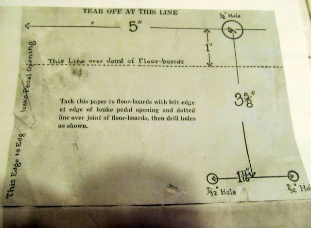

A shop project for the Model T -
By 1925 the Model T was showing its age. The newer cars had features that made driving an automobile easier. The move from a hand throttle to a foot throttle was one improvement.
The 1924/25 Industrial Education Magazine prepared an article that was showing future owners of second hand cars how they could improve the ride.
Attach is a copy of instructions of a foot throttle using scrap material.

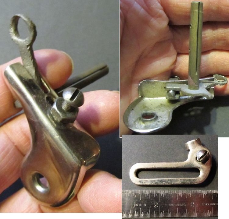

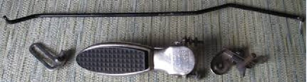

I posted these on the discussion about a DIY foot throttle
