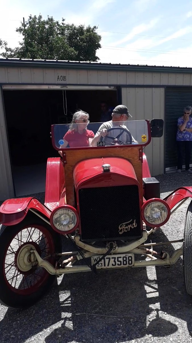

Can someone tell me about this axle? It's on a speedster I just bought.

It’s a dropped front axle which lowers the height of the speedster. The ends of a standard axle are reshaped using heat and a press to make the offset.
