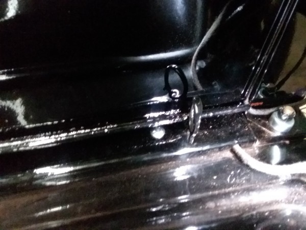

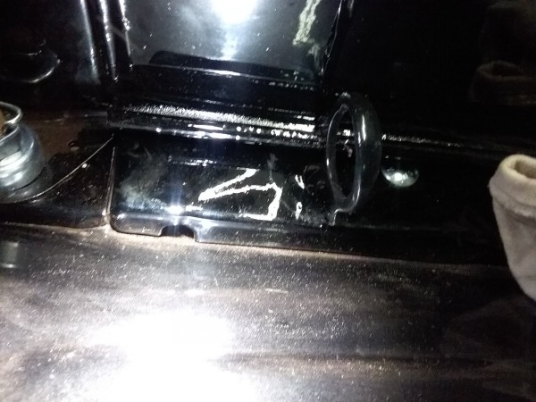

- Posts: 22
- Joined: Sun Jan 06, 2019 12:41 pm
- Last Name: Barclay
- * REQUIRED* Type and Year of Model Ts owned: 1920 coupe
- Location: West Michigan
Re: Routing headlight wiring
Pictures of the notch in the bottom of the hood shelf, one with the wire one without.
Tractordoc, Thanks for the pics. Jed
