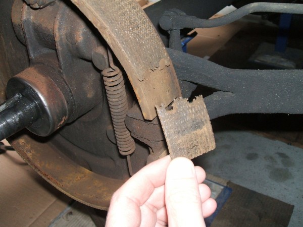

I had to glue the ends down because they would otherwise continue at a tangent and rub against the drums. I used JB Weld successfully. The photo shows what happened first time round when I didn't bother gluing them.
Having said that, the repro linings did not function as well as the original asbestos type, so I now have modern bonded linings.
