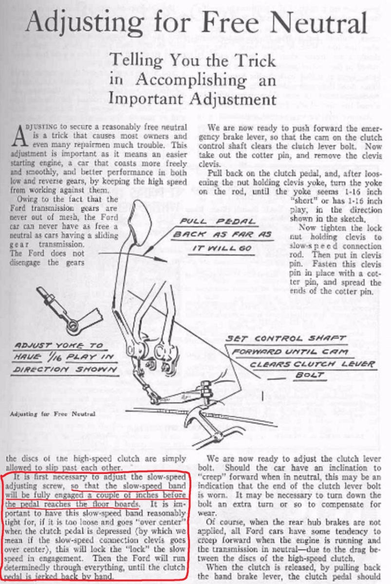

Re: Low speed clutch sticking - Need Help
Note the red highlighted area for setting 'Free Neutral"
May be as easy as Duey posted.
A sticking low pedal, having to pull it back with the toe, is many times due to worn linings, or low band adjustment too loose.
That will cause 'over center' and lock the pedal down.
The low pedal should be adjusted with the screw on the hogshead until the lining on the low drum is tight when you depress the pedal to about 2" or so from the floorboard. Don't allow the low pedal adjustment to be too loose, as the band lining won't be able to grip and hold the drum from rotating, and that will wear the linings way too fast.
Certainly sounds like the clevis is going over-center.
Just adjusting for Free Neutral isn't always the entire story. So many cars are sporting worn out hog's heads that in many cases the clevis simply cannot be adjusted long enough, and a new, longer "L" piece must be made.
Thanks for the info, yes, the clevis going over center is a fit description. I will adjust the low speed to engage a little higher without over tightening the band and try adjusting the connection longer this weekend.
Diet was right. Giving the band adjustment a half a turn tighter solved the issue.
