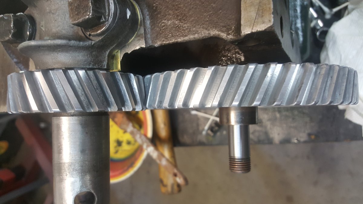

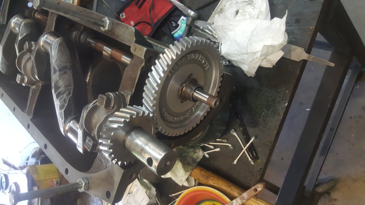

I've been a huge fan of Time Saver for years. Today I found another use. Timing gears. When I got a newly babbitted block back from the rebuilder and installed the crank and cam with the timing gears installed, it was was evident the gears were too close. They were binding a bit making marks on the large time gear. I tried a number of other timing gears I had, bronze, aluminum and fiber and all were too tight. I decided to lap the gears using green Time Saver on an aluminum large time gear and hardened steel small-time gear. The result was very good. There is no detectable play and the gears run against each other without binding. Because I used an aluminum large time gear, I could have used yellow Time Saver. However I wanted the compound to cut so I opted for the green. It turned out to be a good choice. Except for the fact that you need to be very careful and clean the gears thoroughly, removing every speck of the compound, I was very pleased with the outcome.[attachment=1]20190728_101247.jpg[/

I strongly recommend that you do not do this to correct insufficient backlash in a set of timing gears. My gears are accurately cut to run on the standard Ford center distance of 3.937" with correct backlash. If you have an issue with too much or too little backlash, we normally have both undersize and oversize gears in stock to address issues such as this. Personally speaking, I would be having a long conversation with the person that line bored that block, as its not that time consuming to check the center distance before boring the mains.

Dick, it took me about an hour all told. Includes mixing the Timesaver with motor oil and painting the mix on both gears before lapping. I did a little at a time working the crank back and forth about fifty times in each position. At the end I rotated the crank in one direction about a hundred revolutions and then reversed the direction for another hundred. I noticed a difference after cleaning all the compound off the gears. The cam gear entered and exited the crank gear much easier. The gears moved without binding or having any tight spots. And the front cam bearing with relatively easy to move with a drift to locate the hole for the set screw. Information about lapping gears with Timesaver can be found on line.

Final assembly shows a .0025" timing gear lash. Ford Service Manual shows an acceptable lash of .0005 to .003" for new gears and builds. That figure is for using Fords steel gears. With an alum cam gear, there will be slight expansion over steel, but the swelling will be minimal. It is remarkable how easy things turn.
