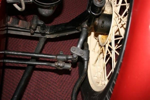

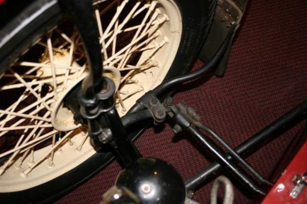

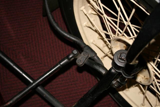

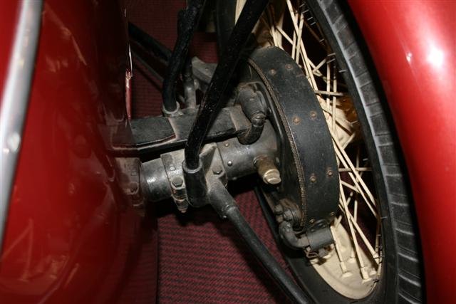

Below are photos that Mike Bender provided of the Mercury fenders mounted on a Mercury from the late "Speedy Bill's" collection:

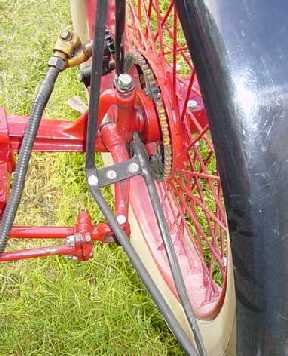

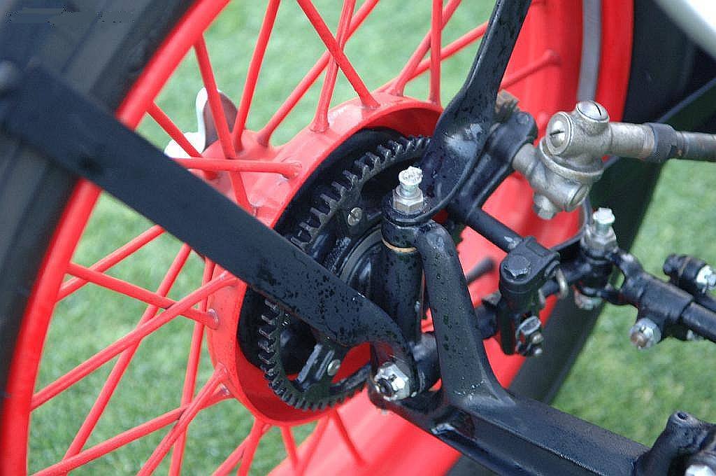

Frank, I would be wary of mounting fenders in the manner shown which features a 26-7 T wire wheel. Strap iron lacks rigidity at the best of times. The long straight section of strap from mounting point to fender gives plenty of scope for movement. Also, each of those mounting straps is free to flex in any plane on those two 90 degree twists. While the spindle arm mounting is solid and the nut will take considerable tension, that is not the case at the top of the king pin bolt. Excessive tension here will put load on the kingpin bushes, making steering tight. Leaving the king pins loose enough to cope with required steering forces will mean a less than tight mounting for the fender.
I was more interested in the cast steel Corbin speedometer swivel used. If the speedo is Corbin too, that is one quality installation.
