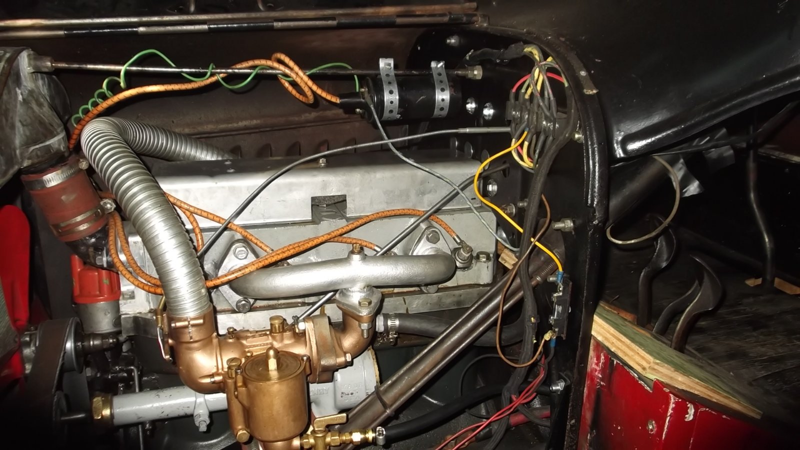

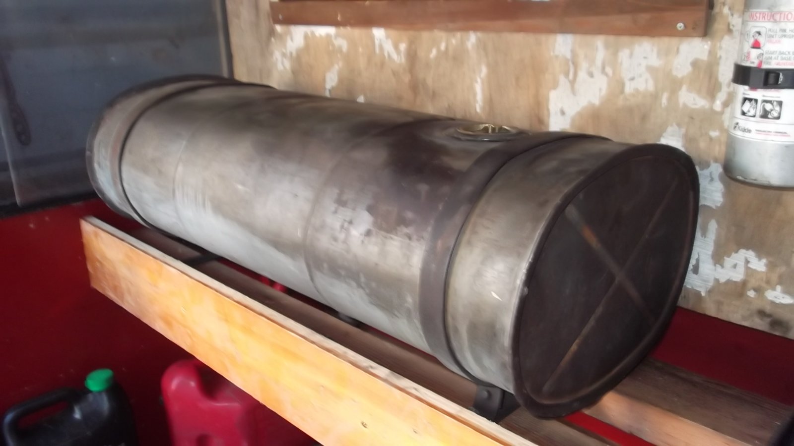

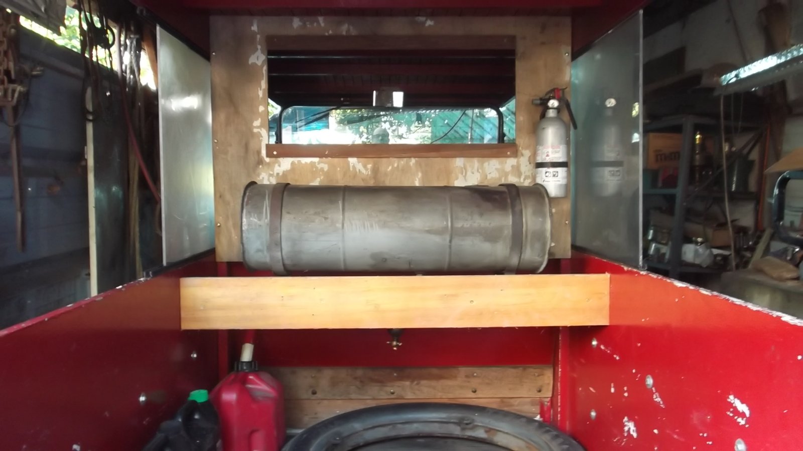

I am running the modern rubber type fuel line all the way from my tank to carb. Two weeks ago my electric fuel pump gave out. I did not have time to source a 6 volt pump so I mounted my tank in the bed of the huckster. With the Chevrolet over head the carb is on the drivers side so the line runs along the drivers side (US). I could have put the tank lower then how I mounted it but wanted to be able to drain if needed.
