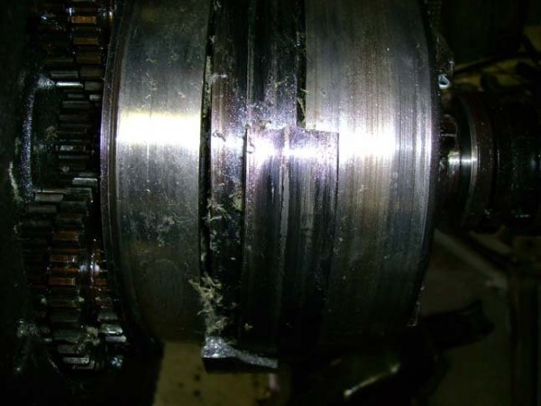

I’ve repaired several engines with cracked low speed drums and Kevlar lining. I have not yet seen any cracked low or reverse drums.
The problem IS NOT the Kevlar linings. As a matter of fact, I highly recommend Kevlar linings.
The cause is is generally one or a combination of the following 3:
1) Adjusting the bands too tight.
2) Driving the car wrong (slipping the band to regulate speed)
3). Clearance or geometry issues inside the transmission that were not realized during assembly.
If you do any of these things with cotton bands, they glaze or rapidly wear (in the case of item 3, sometimes only in the “problem spots”), thus saving the drums, but causing frequent “band issues”.
The low speed drum has a higher tendency than the other drums to fracture for two reasons:
1) Its web is off to one side and doesn’t heat-sink the band surface evenly.
2). It is the middle drum and does not get as much (cooling) oil flow to the webs and inner drum parts as the other drums do.
A couple years ago, I began installing new ductile iron low speed drums from Nolting Machine in every complete engine and transmission assembly I build. It is an extra measure of durability and insurance in case the end user doesn’t drive the car right, or makes incorrect adjustments. The new ductile iron drums are able to withstand extreme overheating and still maintain their structural integrity.

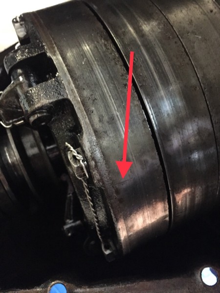

Yes, it has happened to me. About 30 years ago I was driving my dump truck loaded heavy to our club swap meet. It had a Ruckstell, Warford, and no auxiliary brakes. They were not available new at that time and I had been unable to procure an original set. Spare me the lecture, we all know it was a dangerous situation. I knew it at that time and found out just how dangerous it was. Coming down a long hill into town I was keeping the speed down alternating between the brake and reverse pedals. Yeah, with the benefit of experience I know that’s not a good idea either. I touched the reverse pedal at one point and may as well have pulled the pin on a grenade. The sound was apocalyptic. The drivetrain locked, now my rear wheels are skidding and the truck is beginning to swap ends on the highway. To restore control my only option was to slap the Warford into neutral. Now the ride really began. The effect of the “emergency” brake was minimal at best. I rode that sucker about half a mile and blew through two red lights with my air horns tied wide open at about 50 mph. I owe my survival to the fact it was 5AM on a Sunday and there was near zero traffic. The devastation was complete. Punched holes in the pan and hogshead, broke the cylinder block and crankshaft. Almost every moving part was scrapped. After that my father said even when I put in another engine I wasn’t going to drive it again until I had some kind of brakes.
- Posts: 7352
Re: Have you had a drum failure ? POLL

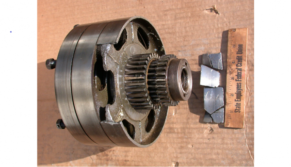

I assume the question is prompted by my adventure Thursday afternoon, so yes, I've had a drum failure and the lining was Kevlar. But I think Adam is right on the subject. If drum cracks are caused by overheating, and overheating is caused by friction, and friction is caused by the drum moving against the lining (slipping), then allowing only enough slipping to get the car moving without stalling and then stomping down hard on the pedal (no friction when the drum is stationary) should not produce enough heat to be a problem. I think the perceived connection between Kevlar and broken drums may be a case of post hoc ergo propter hoc. The rooster crows and the sun rises, therefore the rooster causes the sun to rise. Kevlar bands are present and the drum breaks, therefore the Kevlar caused the break. I think the other reasons Adam listed are far more likely.
That's amazing. After checking a dozen or so reverse drums and finding all of therm cracked I gave up and bought one of Dave Nolting's new ones. I may do the same with this low drum.
I haven’t seen a cracked drum in any of the old transmissions I’ve taken apart.

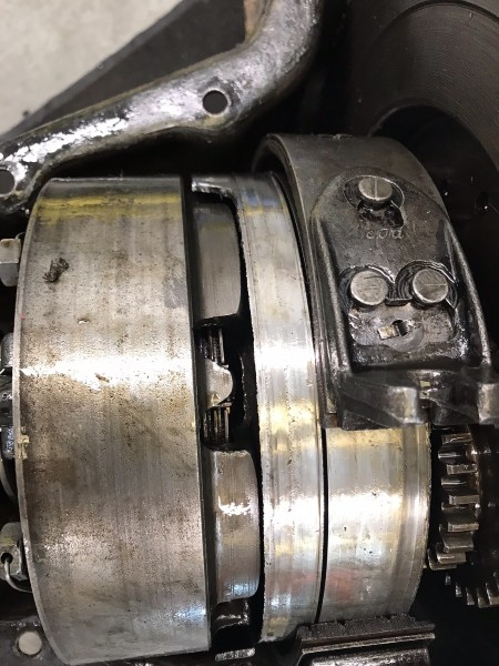

I did have kevlar bands, but that was not what caused it! When I first placed the new bands, I noticed the low drum was bluish color. This was caused by overheating. It finally led to the catastrophy shown in the picture.
The actual cause was worn low cam and low notch. These are the tapered parts which cause the low pedal to move right when you push the low pedal in. They were so worn that the band could not be tightened enough to keep the band from slipping. It would operate when the pedal was below the level of the floorboard. Consequently, in order to get the low to work at all required tightening until the band was dragging even when in neutral, high or reverse. Of course it required frequent adjustments to even have a low gear and finally the drum collapsed. When I pushed the low pedal, the car skidded to a stop and could not be moved even in neutral or by pushing without jacking one rear wheel with a rolling jack.
After I replaced the drum, the shaft, the cam and the notch, I still have kevlar and no recurrance of the problem.

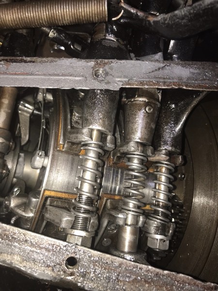

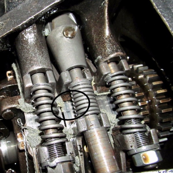

something else that shows on your photo is alternately insufficient "stick out" of band material, and far too excessive stick out, depending on which band you look at. Steve's showed excessive stick out, too.
If the band (regardless of cotton or Kevlar) is not installed properly, ie with a very tightly compacted weave, bands can act very strangely. I once got a car in that had dragging bands, yet mushy pedals. As installed in the car, I found the band material nearly met in the center and when removed, the band material stretched from rivet to rivet...there was clear air between the material and steel band. Wrongwrongwrong.
I have no idea what caused Steve's problem, but it is certain that Improper material installation and worn out hogs heads have been breaking drums since Henry's engineers designed them. Dave Huson used to say that he'd go through many many transmissions and find mostly broken low drums, and these transmissions gave their lives long before the advent of Kevlar.

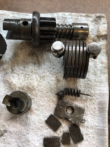

Yes. Not just cracked, exploded. While doing 40mph, so not under stress so to speak.you can see the wear line in the center of the drum, and when I got the car I wondered about that wear line.
And they were not kevlar bands. Have Kevlar now.
The pieces ended up everywhere in the motor and mostly in the bendix cover. You can’t imagine the racket when it let loose...
The first pic was taken the day I got the car and you can clearly see the wear line.

Wow that stuff in the Bendix cover is impressive. Mag contact, magnet keeper, and shards. They don't look like drum shards, but I have to believe you on that.

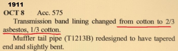

Different materials have been used. And as Scott posted, broken drums have been around long since Kevlar.
And Ford didn't use plain cotton either......the woven material for Ford linings over a long time contained a percentage of asbestos. That is a pretty rock hard fiber

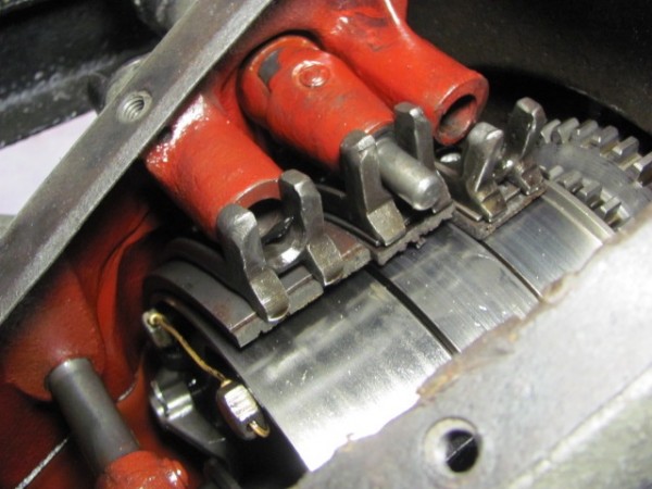

Any band lining will wear the metal surface of a drum. The physics is friction. Metal gives. Drum surfaces wear down. Can be more rapid by poor rivet technique or sprung metal bands, worn pedal cams, etc. or driver allowances too
My brand new cast iron drum surface was worn to finger nail hitting grooves, where the Guinn wood band oil relief rides on the smooth new drum surface. Proof that drums wear down, and cannot last forever. Amazing to me that many drums have lasted 90+ years in our Fords! Some are in need of replacement, and you find that when an old one cracks.
Low wood lining with its imprint of slightly worn down grooves beside the oil relief.
Wood wears metal too, why wood workers have to re-sharpen turning tools from time to time.

looking at the pits and rough edges on those drums, Kevlar was the least of your worries. Hopefully the Guinns have turned out to be what you'd hoped for.

Yup, that’s drum material. Anyone know what the bands are in those pics? Wood?
I’m monitoring the wear on the new trans with the Kevlar and so far I see no wear after a couple thousand miles (I drive this car every day, and hard- a mile of steep low band hill each time). I’m honestly of the opinion that the last failure was the PO’s driving style and wood? Bands...

The photo shows the failure of the reverse drum I experienced over 10 years ago with Kevlar bands. I drive my T between 25 to 35 MPH and was in highway traffic when it exploded.

I had a reverse drum break on my 1919 about 20 + years ago. At the time I had been running what we called "hard" lining. I believe it was asbestos lining that was commonly used in Caterpillar bulldozers. They chattered terribly, but I could stop on a dime. I also used to alternate using the brake and reverse when going down a long hill. I used to burn up cotton linings like crazy 40 years ago...
Today all my cars have Kevlar lining, and run as smooth as silk. The low range on the Ruckstell helps me to go down hills using minimal use of the brake pedal.
If there ever is a next time I have to rebuild a transmission I will certainly use new transmission drums. With 90+ year old cast iron drums you are gambling every time.
There is no way to know if the asbestos lining contributed to the drum failure, but would not use any "hard" type of lining today. I am an avid Model T driver and have Kevlar lining in all my cars. Just drive it as if it has cotton lining.
Scott,Scott_Conger wrote: ↑Sat Jul 27, 2019 11:25 pmDan B
You are right. I knew a lot more the second time around building the transmission and found a good set of donor drums. Straightened out a lot of things including bent pedals, which was probably the leading cause in the drum breaking in the first place.
The Guinn bands definitely have a different feel to them than the Kevlar. I felt like I was learning to drive all over again. The also have not seated as quick as the Kevlar bands. I have had to adjust my brake band several times since installing them.
- Posts: 6605
Dan
your picture looked familiar...not sure if you had posted way back when...
experience can be a tough teacher, wouldn't you say?
I am glad things are settling in for you
