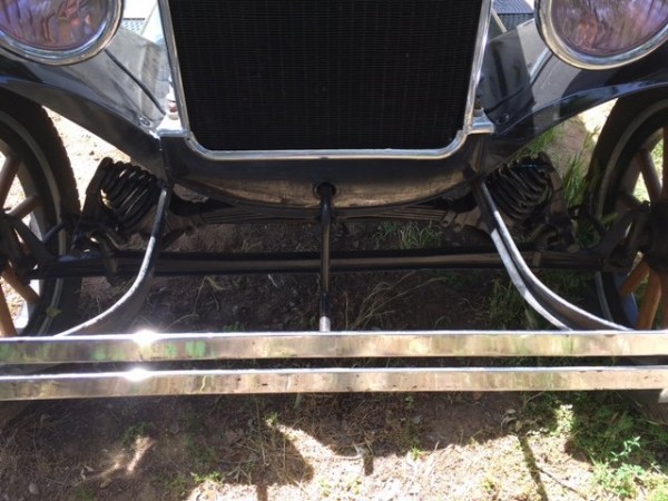

Post by kmatt » Wed Aug 21, 2019 4:43 pm

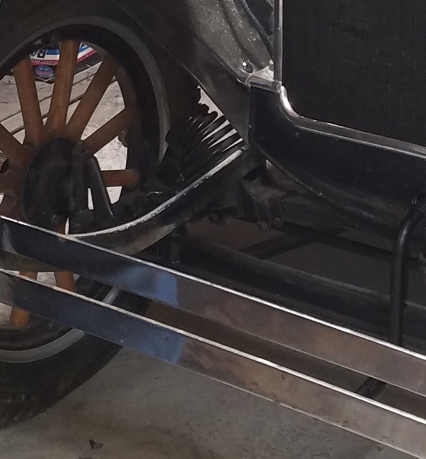

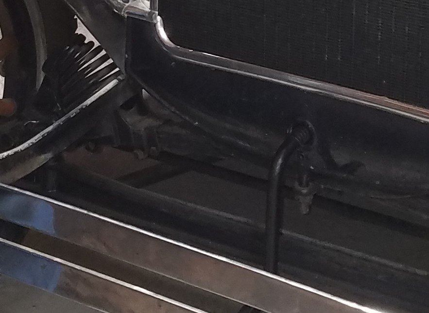

Michael Jewell : If you want both bumper and Hasslers on the front of your 26 T it can be done. This is a picture of my 26 Cp that has both,it came to me this way.

Post by Mark Gregush » Wed Aug 21, 2019 9:18 pm
Kevin's photo is a good example of both being used. Mike how about posting a photo of your setup now and the bumpers you are thinking about installing, maybe we can spot something. When this question was asked before I never could picture in my mind how the two would interfere with each other. The Hasslers are at the ends of the springs and there should be plenty of clearance.

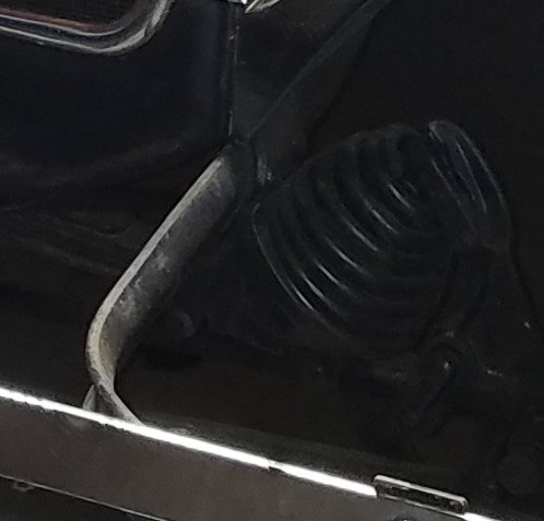

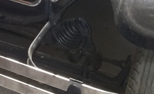

Post by Mikey1968 » Thu Aug 22, 2019 2:53 pm

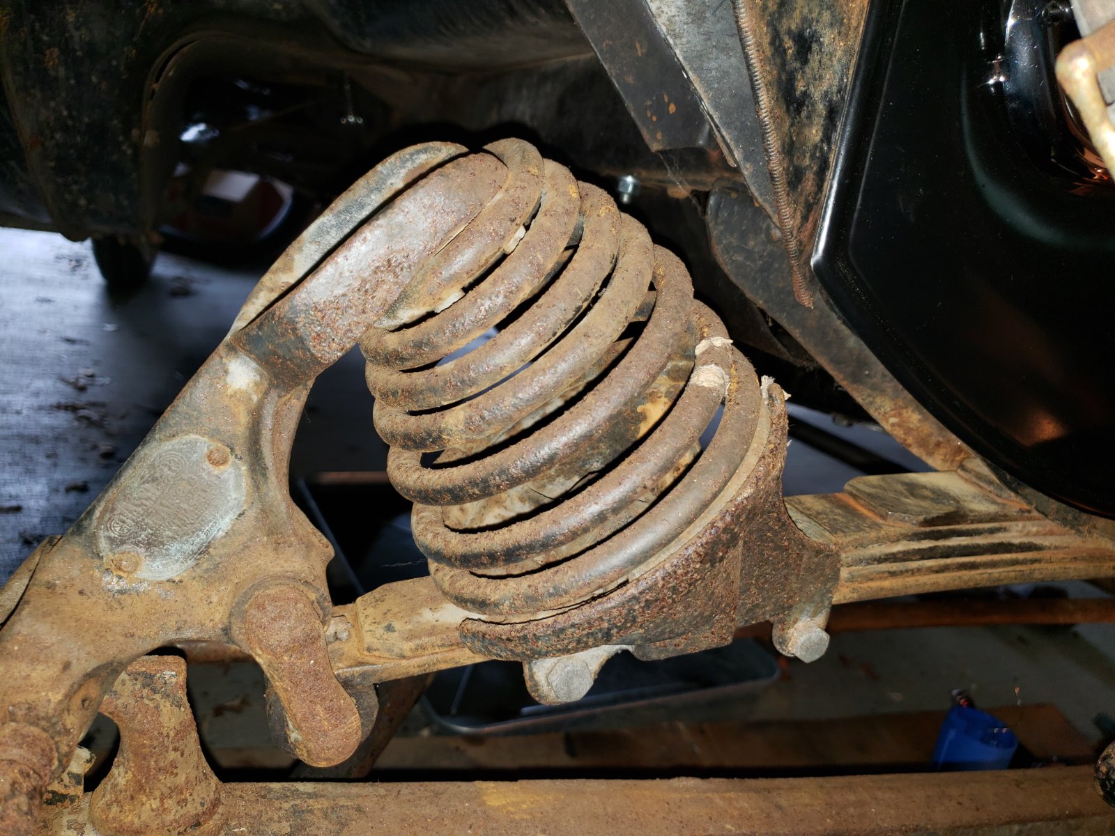

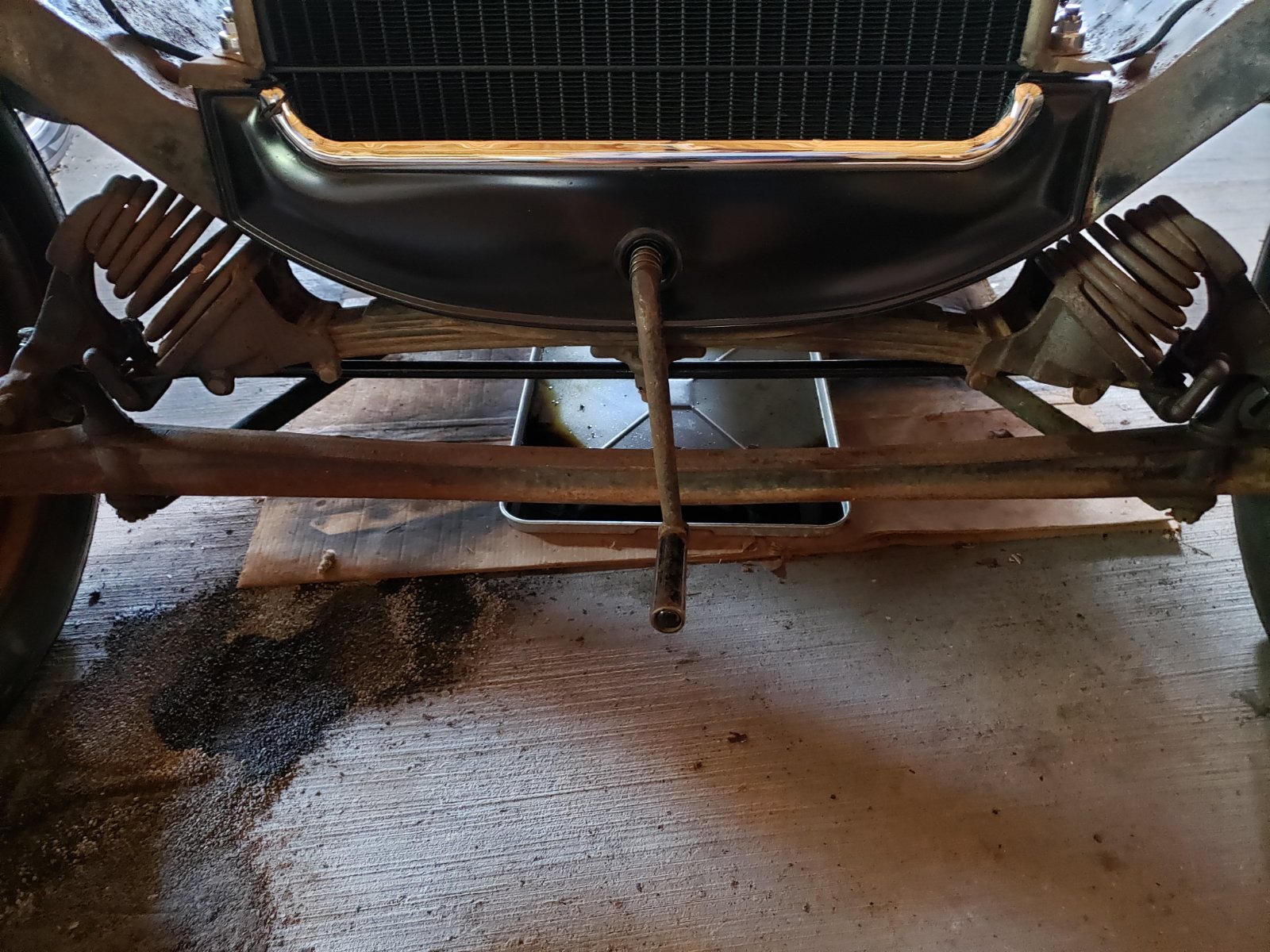

Hopefully these photos loaded up...uh hem....I had an oil leak that I fixed but haven't emptied the pan yet....that's my story and am stickin' with it! :)

Re: Front Hasslers or Bumpers...Which Would You Choose?
Post by Henry K. Lee » Thu Aug 22, 2019 3:33 pm
Mike,
Looks like your main leaf is real weak!
Hank

Post by Mikey1968 » Thu Aug 22, 2019 4:28 pm
Hank,
So you are thinking the lack of arch to the spring is allowing the Hassler to be too close to the frame?
Posts: 5620
First Name: Henry
Last Name: Lee
Location: South Pittsburg, TN
Post by Henry K. Lee » Thu Aug 22, 2019 5:08 pm
Your Hasslers being flat with that front spring are taking up necessary space for clearance. Spring arch is very important.
Hank

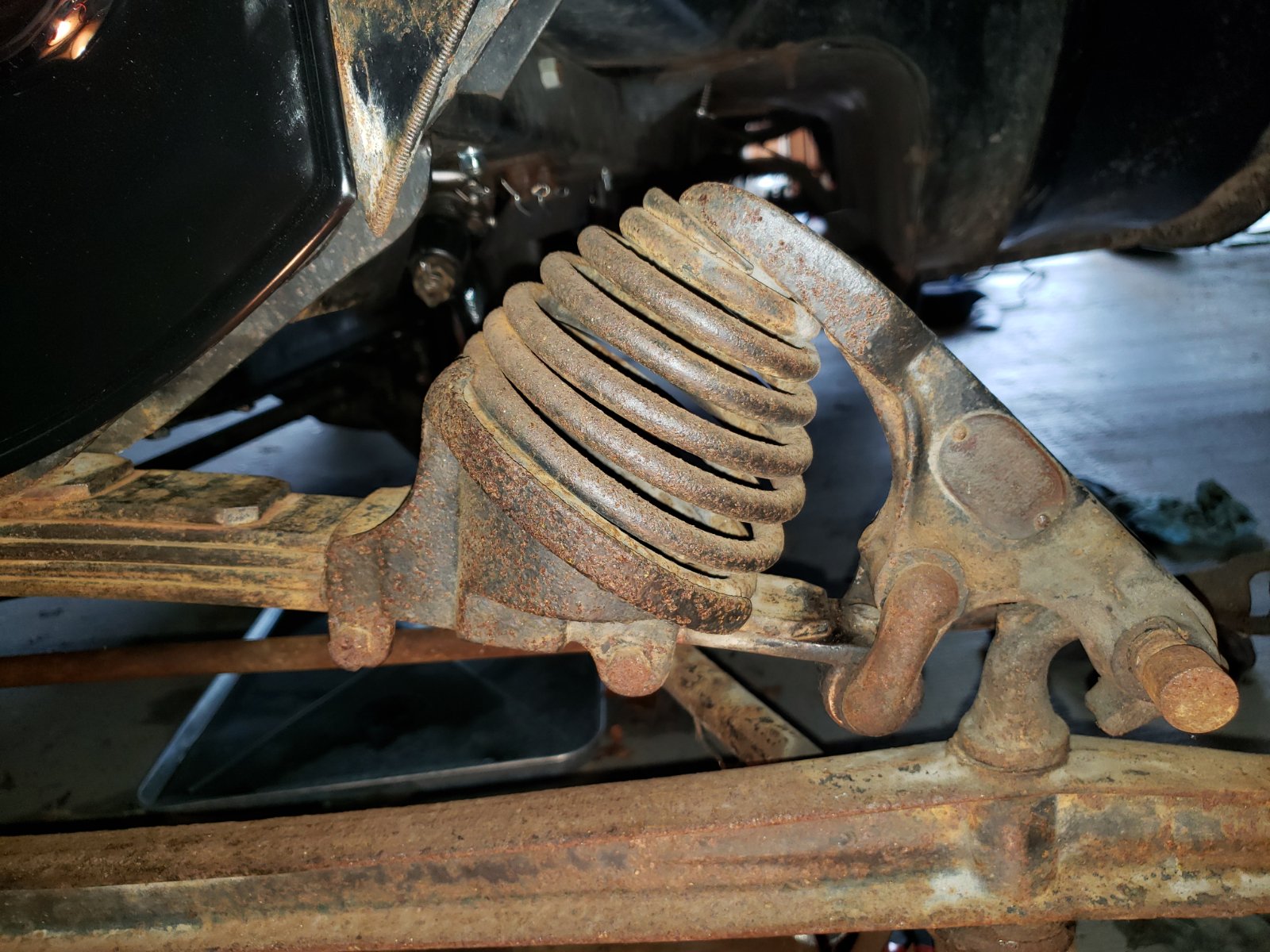

Post by kmatt » Thu Aug 22, 2019 6:55 pm
Michael Jewell : I am attaching some pictures of my 26 CP as requested. I noticed that my Cp is using 1925 type spindles but I don't think they have any effect on the Hasslers. My spring arch is higher than you car's spring pictures show but not as high as a 1925 spring, maybe my spring has a extra leaf on top as a spacer.

Post by Henry K. Lee » Thu Aug 22, 2019 7:03 pm
Thanks Kevin! Really helps for everyone.

Soooooo....the conclusion is that my spring is worn out and needs replacing. If I get the new spring, will the Hasslers and bumper fit like Kevin's or will I need a spacer on top of the new spring to clear the bumper bracket? If so, how thick?
