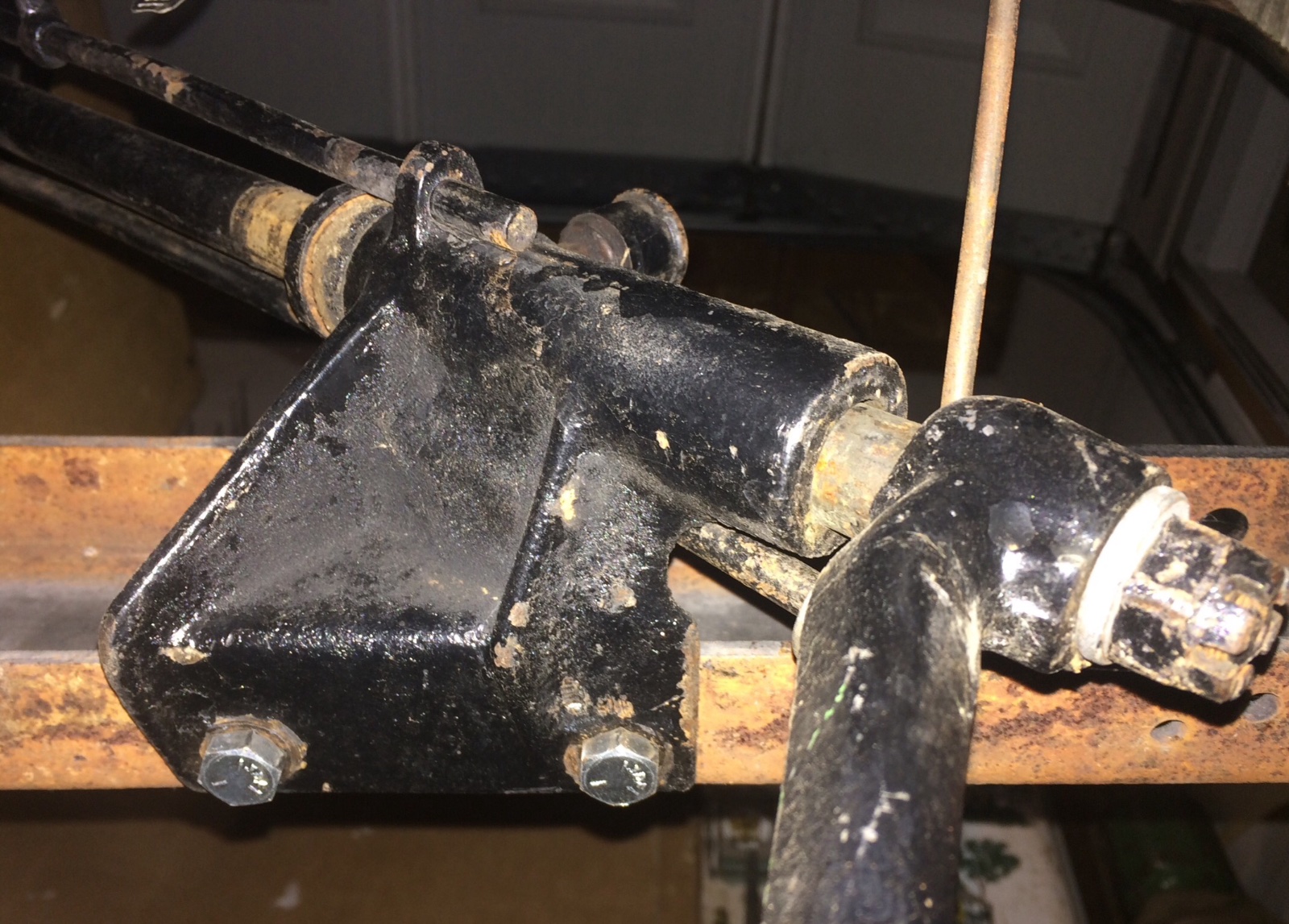

Posts: 823
Joined: Sun Jan 06, 2019 5:42 pm
First Name: Matt
Last Name: G
Location: California
Re: Need photo TT truck lower steering column mount
Post by Matt in California » Fri Aug 16, 2019 2:04 am
Here is what I have. I am not sure if it is correct.
I will let viewers determine if it is correct for TT.
Yes, I got this on a project car and the linkage is not Ford. I hope to replace it eventually.
Matt
Mark Nunn
Posts: 1289
Last Name: Nunn
Location: Bennington, NE
Post by Mark Nunn » Fri Aug 16, 2019 7:59 am
This is the wood block. It goes inside the frame and a bolt in inserted through the outside of the frame, through the block and the hole in the side of the steering bracket. Matt's lower photo has a round spacer where the block should be.

And Matt - that is a correct TT lower bracket.
