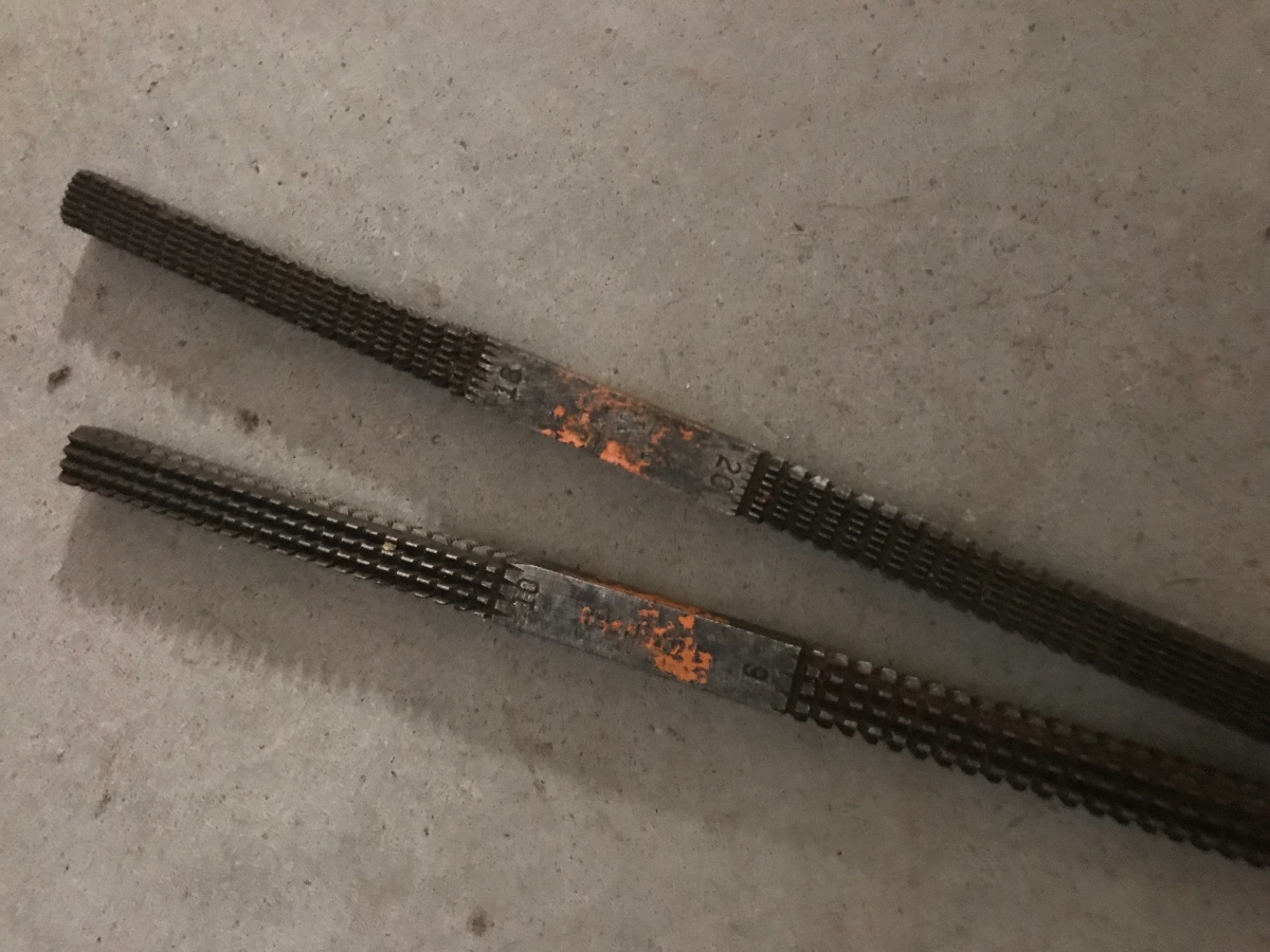

The rear hubs are 16 TPI.
Yes, and if you don’t already have a set of these -
- you ought to get a set.
They can clean up about any external thread from about 8-32 TPI. They work like a file using any remaining thread grooves for alignment. Just work your way around the hub til you get it cleaned up.
I believe amazon even has them now.
