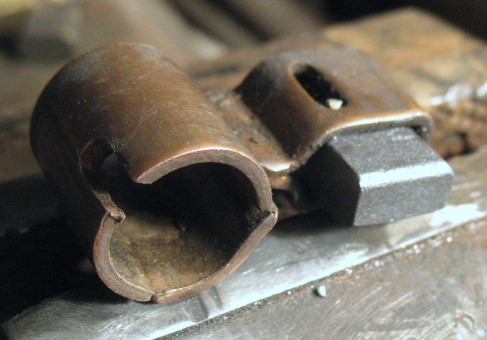

Bronze. I use carbon, a piece cut down from a generator brush.
First attempt. It worked OK, but I cut later ones to fit better.
