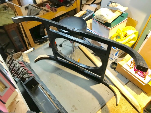

Yes. There is a piece of metal screwed to the rear belt rail under the center line of the rear window that a metal strip on the rear backrest spring board slips into
The belt rail is upside down in this picture (it’s towards the top of the photo) but you can see it.
