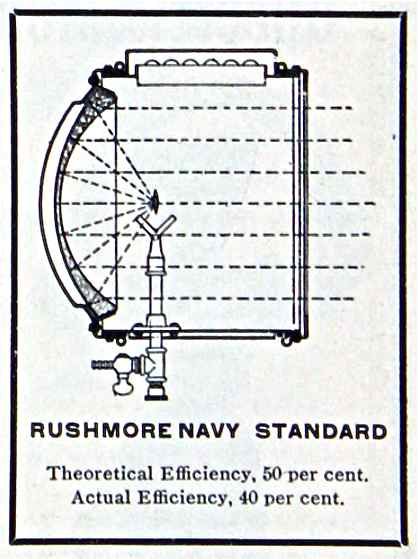

Jem, The later lights you mention have parabolic reflectors which operate quite differently from the glass reflector at the back of a gas headlight. The light is reflected in different ways. The gas light reflector relies on a near pinpoint light source to reflect that light forward. I know of no LED configured to do this. Converting to conventional electric or quartz bulbs is likely to be far more satisfactory.

As Allan says, Mangin mirror reflector.
Gas is about as simple and reliable as it could get using a Prest-O-Lite setup

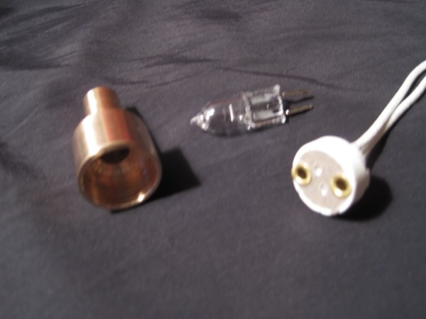

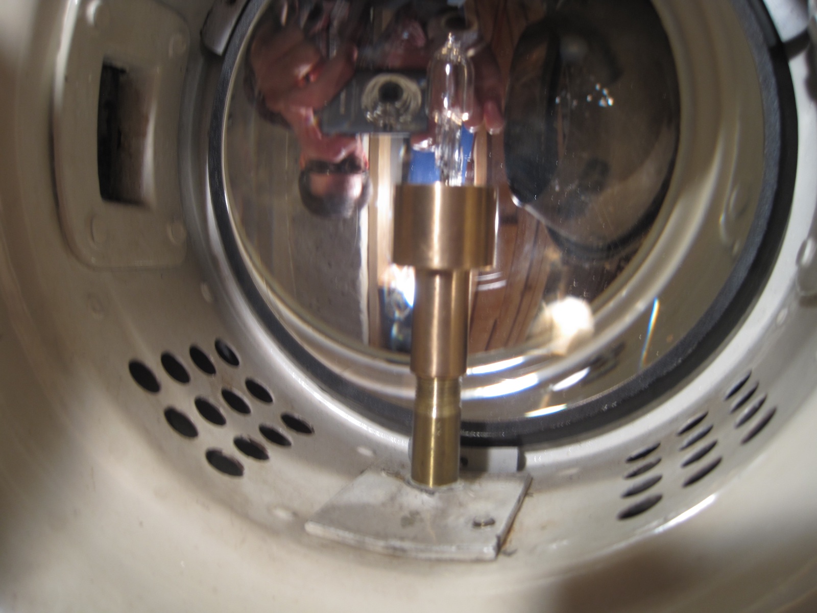

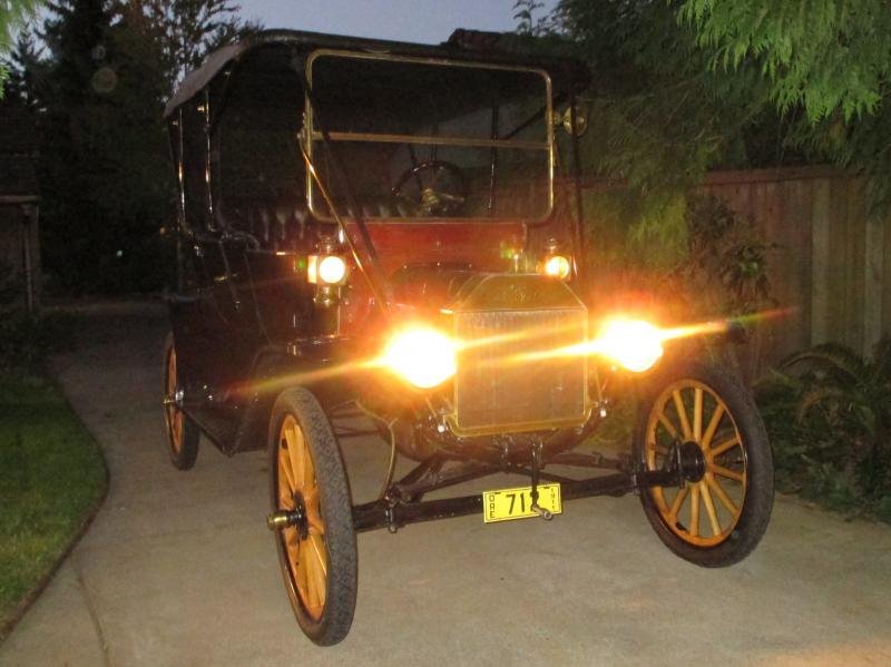

Re: Has anyone had experience with LED bulbs in a acetylene headlight?
We converted the acetylene lights on our 1913 T to halogen a few years ago. Sockets and bulbs were purchased off of the internet at very reasonable prices. We removed the original burners and made socket holders on the lathe from brass. The socket is 3/4 of an inch in diameter and the socket holders are threaded on the bottom end and screw onto the original burner stand. An original, period runningboard tool box was purchased from a forum member and it is used to hold a 12V deep cycle battery.
