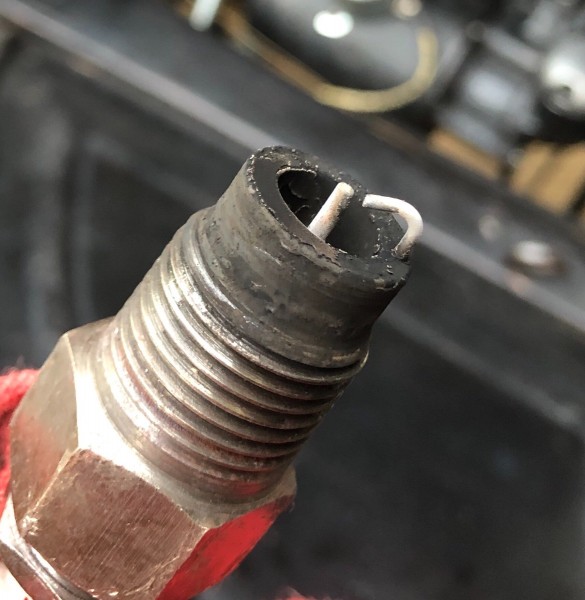

Been driving around with the U&J and it’s been better, but I still have some throttle movement on the upper end that should give me a little more. Tonight I finally got around to installing a 5/16” steel gas line by reaming the opening on the inlet elbow on the carb and the opening on the stock gas sediment bowl (potato). This was a more elegant solution than using lots of modern fittings to convert from 1/4” to 5/16.” So, it looks stock ... just a little thicker.
I drove around for about an hour to give it a good test. Seems pretty much the same, maybe just a little better. However while the engine was hot I was playing around with the choke. Pulling it very slightly gave me an increase in rpms. Holding it out at the same place while pulling down on the throttle gave very smooth powerful uninterrupted acceleration. So, it looks like I still need a little more fuel. Thinking I either need to open the needle adjustment on the bottom of the carburetor a little bit more ... or install a remote choke control on the steering column as used for the OF and other speedy carburetors. I saw that Stan had a reproduction dashboard choke for the U&J. Not sure if this is just for starting and initial warm up or for actually running richer while driving. Fun to play with this stuff.

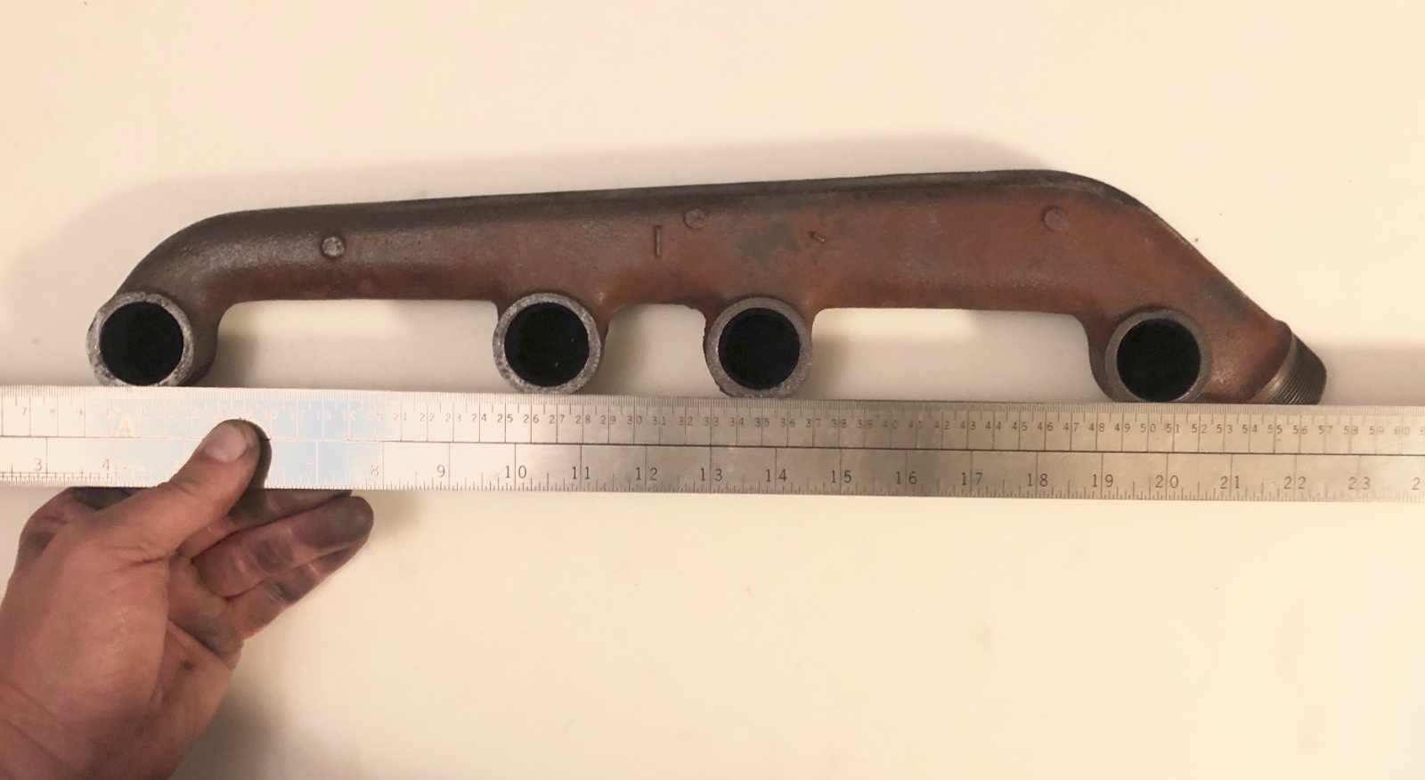

Looks like the only way I could get enough gas for this carburetor was by using the choke. But when I pulled the plugs they looked like I’d been running lean. So I wondered about a possible intake leak in the manifold gasket. I pulled the manifolds, cleaned them up and reinstalled them with new gaskets. I had a very difficult time starting. Got it running on number one and two cylinder only. Thought the manifolds were not tight enough and stripped the threads on one of the manifold clamp nuts/studs.
Took off the manifolds again and saw the gaskets were not compressed enough and one of the steel glands was mangled. So, checked the exhaust manifold and found it warped. Interesting as I’ve been able to get it tight in the past. Guess it was when I first installed this carb that it wasn’t quite right. No wonder I had a difficult time getting it sealed. So am thinking this might have been the cause of insufficient fuel to feed that carburetor. Ordering a new manifold today. Anxious to see what I discover with better vacuum in the intake. An interesting series of events.

I just went through about the same thing, just an exhaust leak, but about the same thing on the center ports upon reassembly. My manifold is pretty darn straight however.
I used the old steel rings the second time and all seems good.

I hear ya Bruce. I went through all of that. It’s an NOS exhaust manifold and a well seated intake manifold so I don’t see any way for a vacuum leak unless there is a crack I can’t see. Stan made the float the way he makes all of the ones for the U&J. So, I don’t think it’s anything related to Stan’s rebuilding and I don’t really mean to imply that. Might just be this particular carburetor and I only thought that maybe tweaking the jet might be an option. Are you interested in giving it a try?
I did like the NH straight-through carb a lot, but this U&J does give me some more hill climbing ability and the idle is very low and even.
