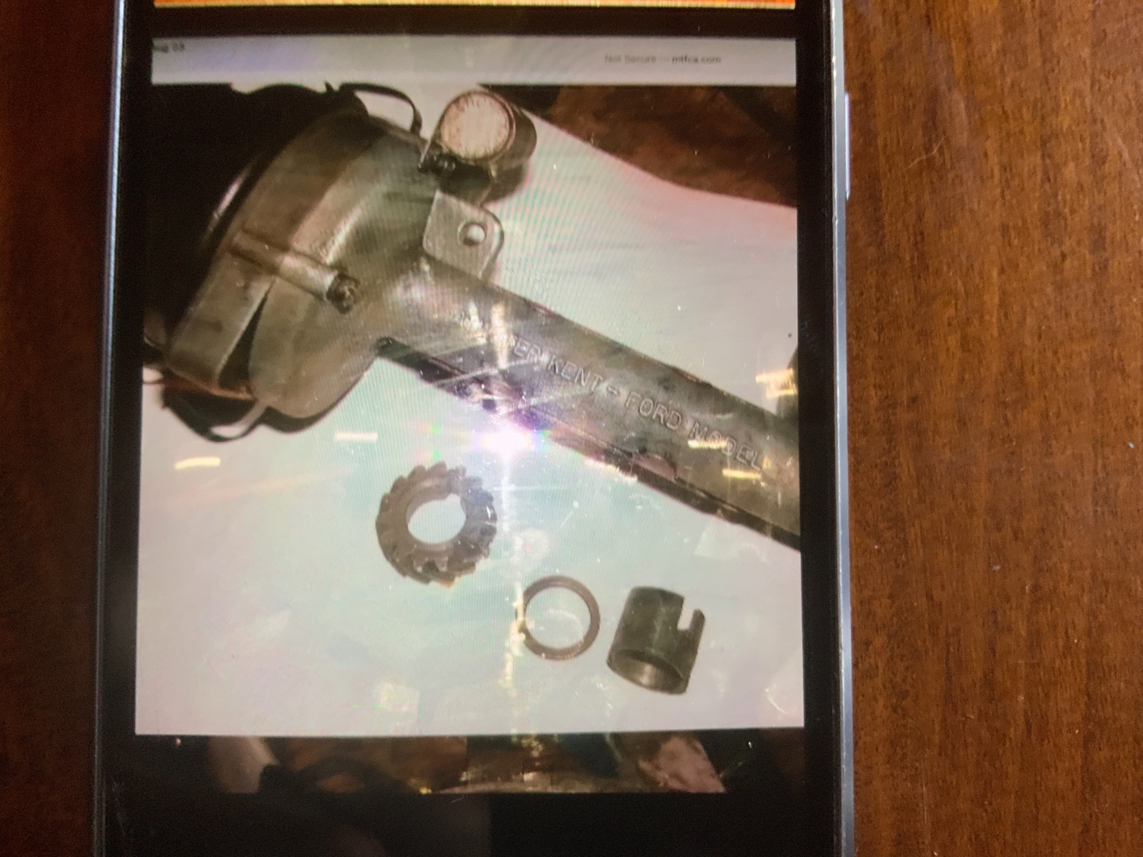

I purchased an Atwater Kent model LA distributor. It’s in excellent condition but
1- I need the condenser
2- missing the spacer and washer
3-any advise on proper installation, timing and setup
Any help that you can give me would be greatly appreciated. The photo attached is not mine but a similar one for reference

I think he must have found one of the links shown in that posting, I think the screen shot is mine.

Mark gregosh, yes it is from your post. I looked back in the archives and still looking for help. Thank you
