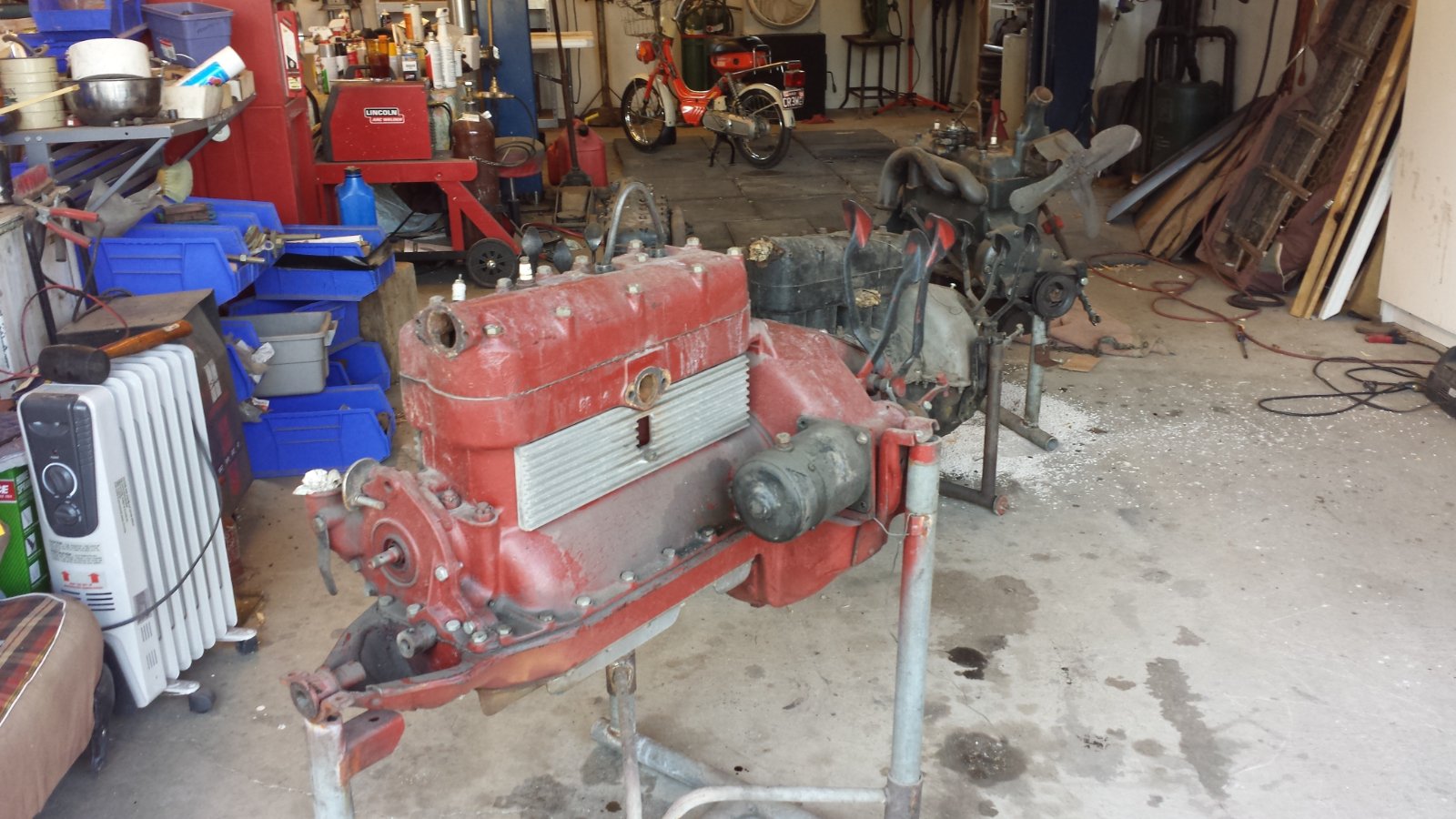

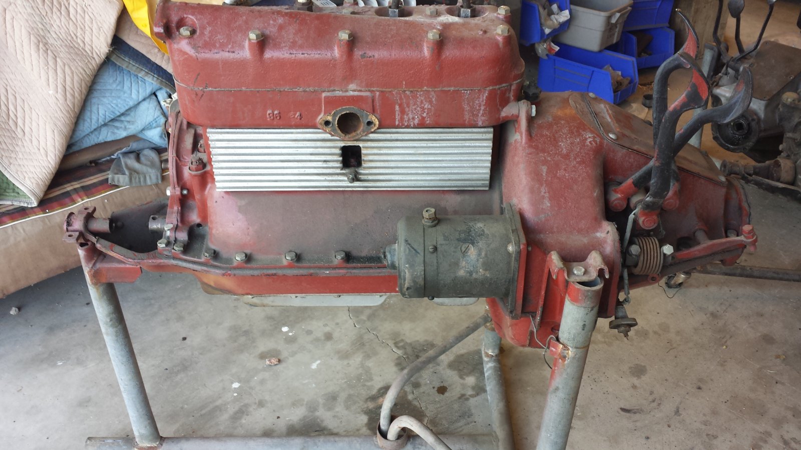

1927 Engine with Model A crank ??
Post by Michael Davis » Sun Aug 25, 2019 8:18 pm

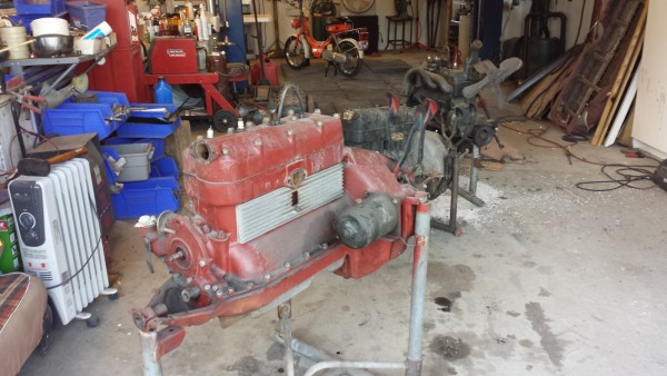

I purchased a 27 engine which is suppose to have a model A crank. What is the best way to tell if it an A crank??
Thanks Mike

I would drop the inspection cover at the bottom of the pan and peek inside.

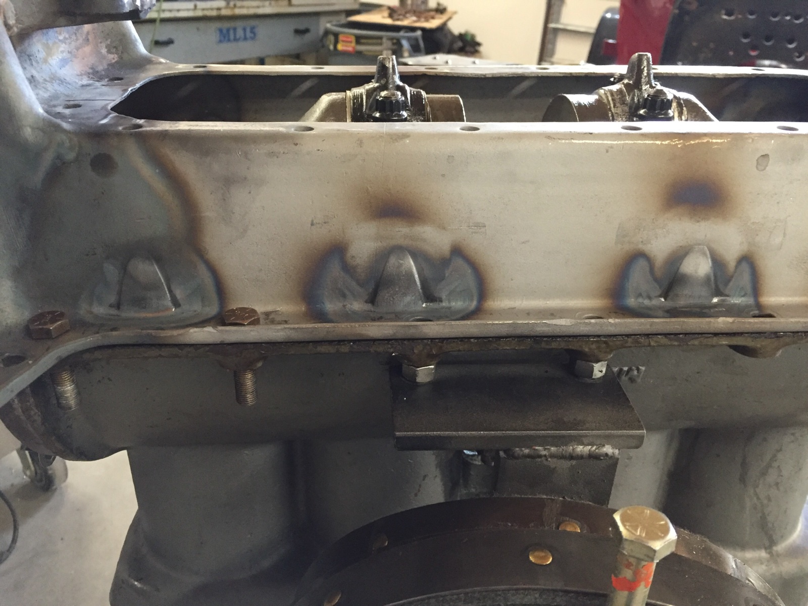

A good first clue, the pan should have 4 dents out on each side in line with the connecting rods just below the block skirt. The extra stroke and bigger bearings needs the extra space

Here’s a pic of pan dimples. Will usually have a 3/8” - 1/2” thick spacer between the pan and dipper tray also

Thanks every for all the information. I guess I have a hopped up looking 27 engine. No model A crank.

Andy makes a valid & easy observation - what's so "hopped up" about it ???

Sure do not see any dimples! Just saying.

Or spacer for the lower inspection cover.

With those “SPIFFY” aluminum side covers it is OBVIOUSLY hopped up!!
Uh huh.

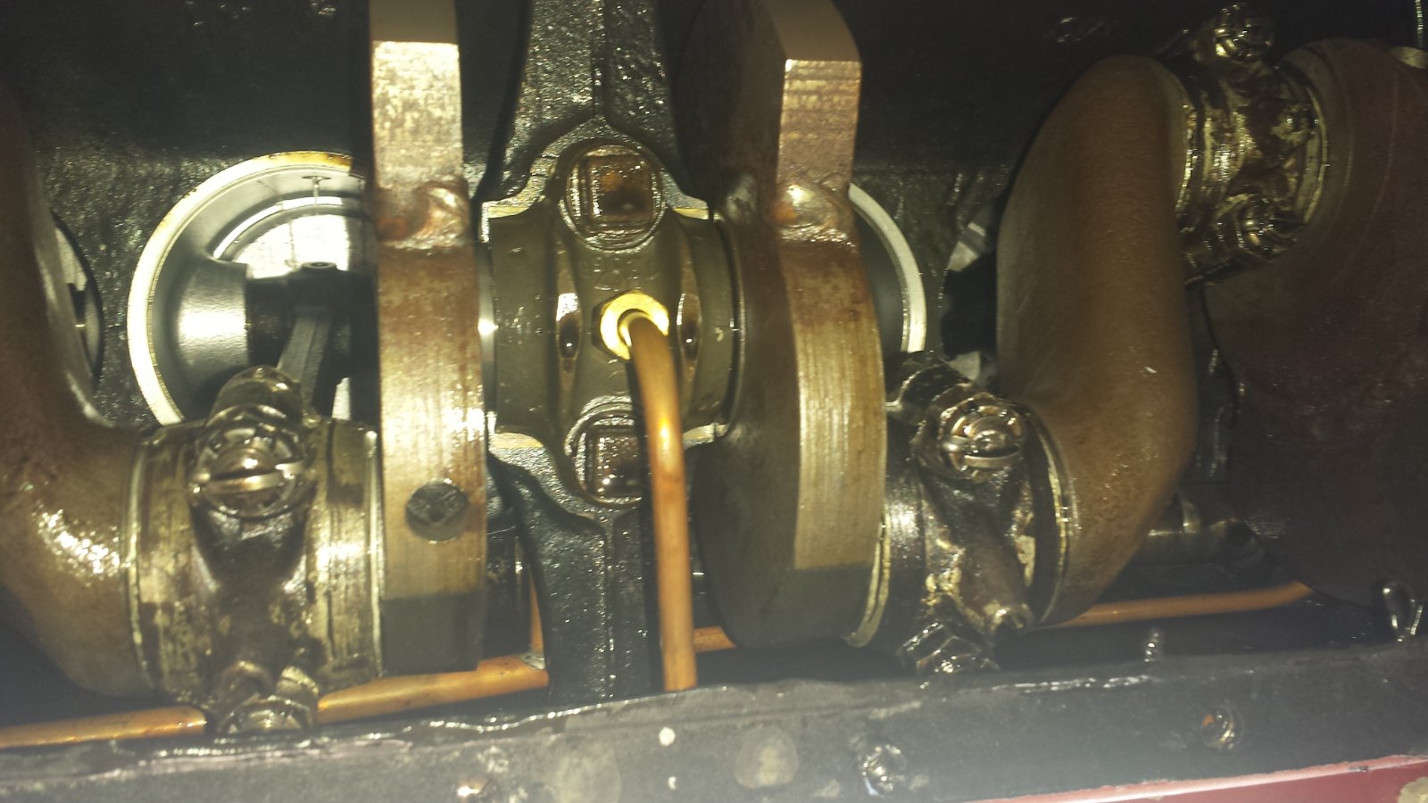

Michael Davis
Posts: 297
Joined: Fri Jul 26, 2019 8:18 pm
First Name: Michael
Last Name: Davis
* REQUIRED* Type and Year of Model Ts owned: 1923 Center door
Location: Montrose CO
Re: 1927 Engine with Model A crank ??
Post by Michael Davis » Mon Aug 26, 2019 7:33 pm
Time to pull pan cover and take pictures.
Kevin Pharis
Posts: 1655
First Name: Kevin
Last Name: Pharis
Location: Sacramento CA
Post by Kevin Pharis » Mon Aug 26, 2019 9:58 pm

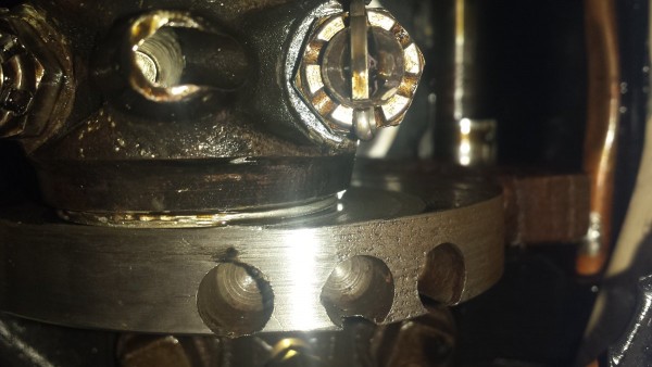

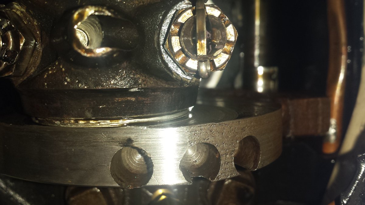

Your first pic shows the threaded hole in the crank snout... definitely a model A crank. The finned aluminum inspection cover is made to clear the A crank and rods... no spacer required. A crank may have been ground down to T rod and main journals... wouldn’t need dimples then

Post by Kevin Pharis » Mon Aug 26, 2019 10:53 pm
The pan dimples are usually required as the rod nuts tend to hit the pan. If you look closely at my pic above, you will see that I use 12 point aircraft nuts on my A rods to minimize the size of the pan dimples. Never seen one that didn’t hit before. And I can’t imagine how much material you would have to grind off the rods to clear the pan without dimpling
Michael Davis
Posts: 297
First Name: Michael
Last Name: Davis
Post by Michael Davis » Tue Aug 27, 2019 2:19 pm
Thanks again for all the information.

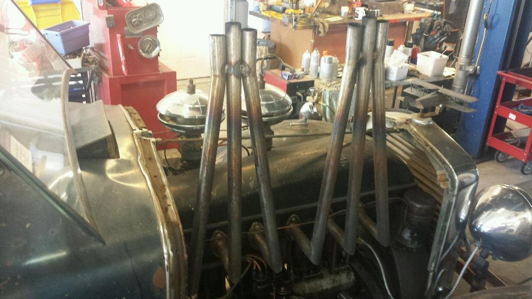

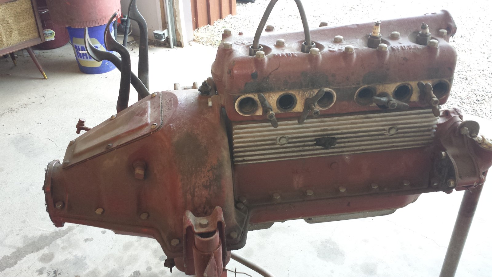

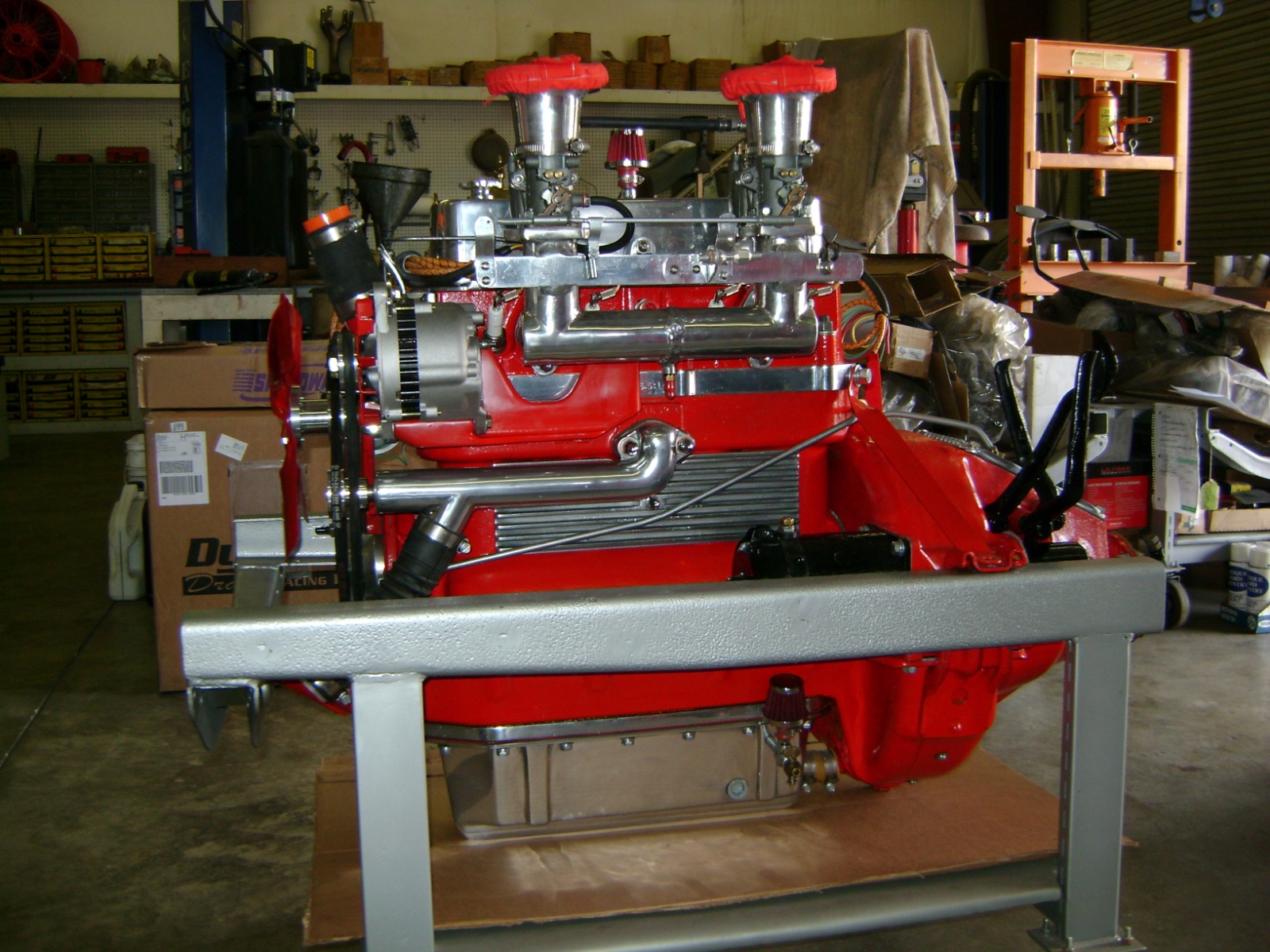

PS I said hopped up LOOKING Does not mean it was hopped up. The picture i am posting is a HOPPED engine.
Mike

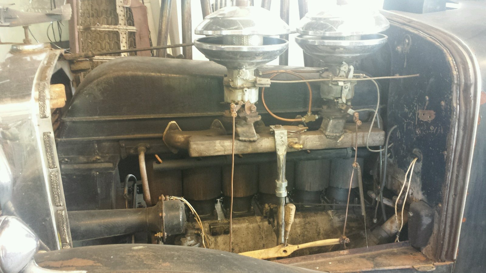

Never seen a hopped Franklin before. 1929?
Michael Davis
Posts: 297
First Name: Michael
Last Name: Davis
Post by Michael Davis » Tue Aug 27, 2019 6:16 pm
29 130 sedan. Daily driver
Michael Davis
Posts: 297
First Name: Michael
Last Name: Davis

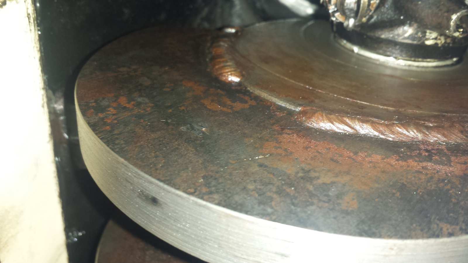

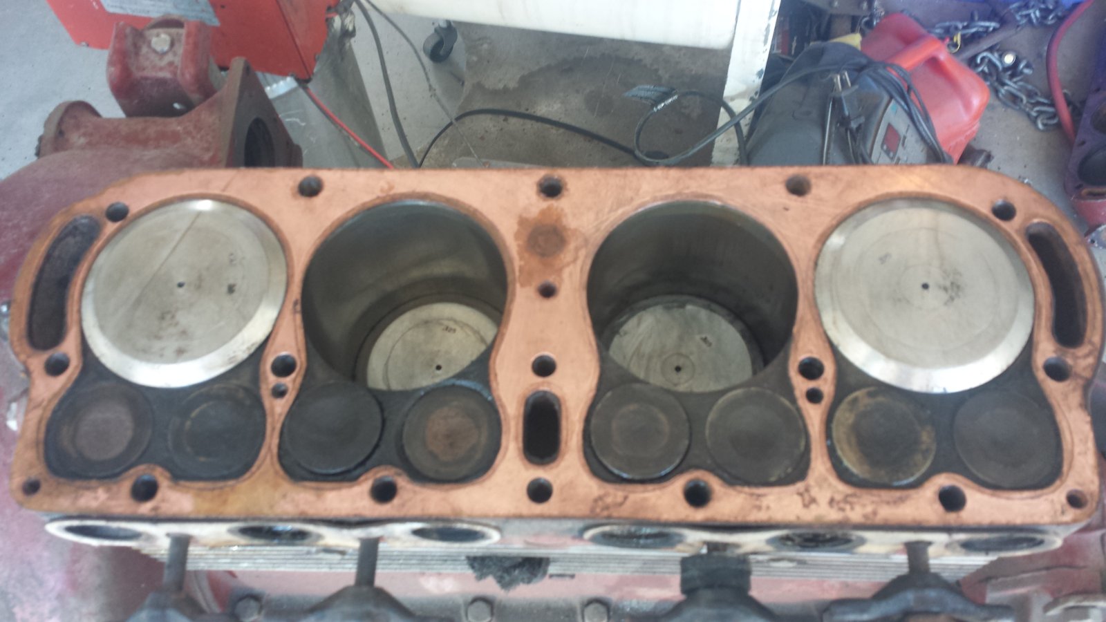

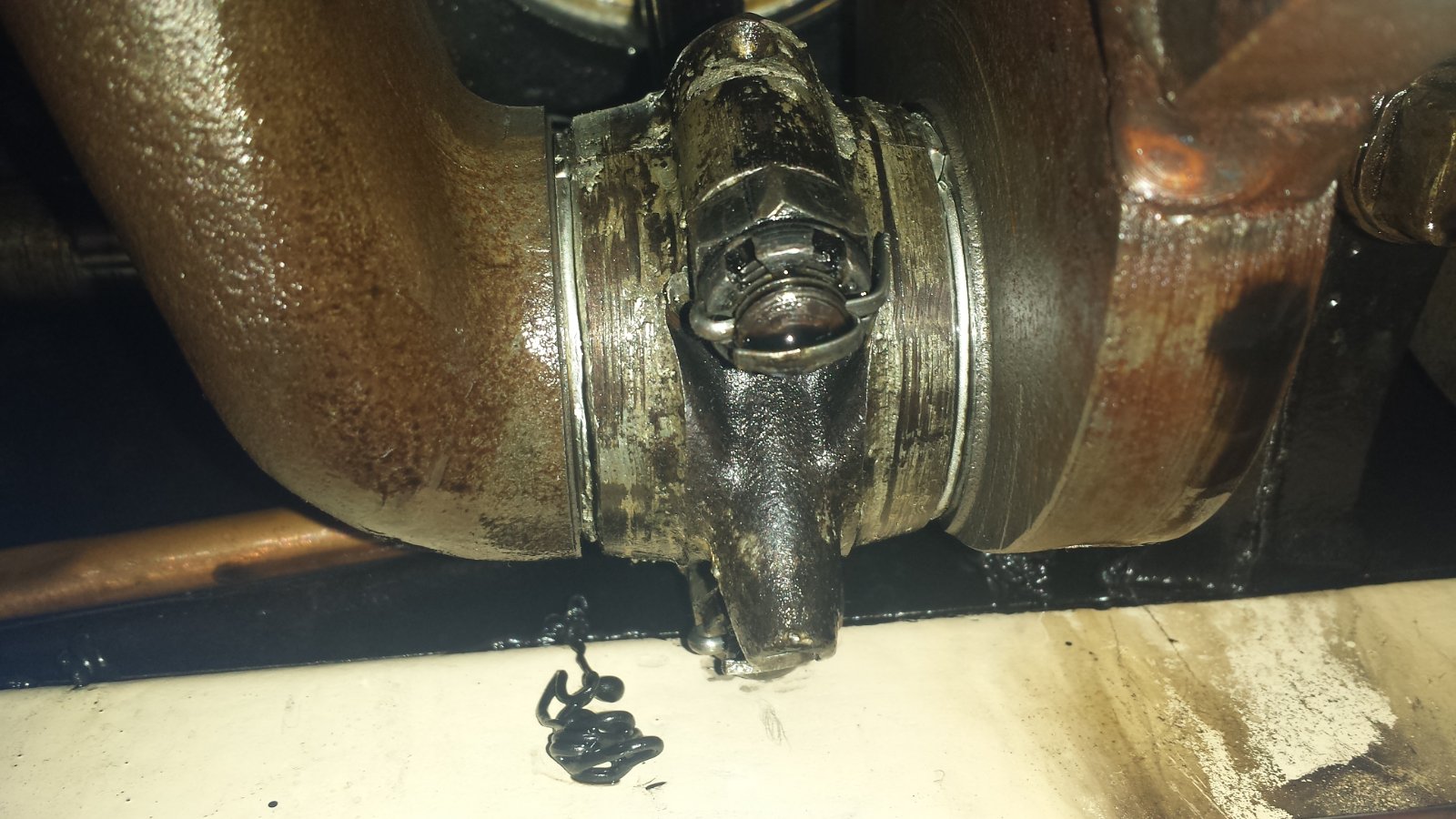

Post by Michael Davis » Tue Aug 27, 2019 6:51 pm

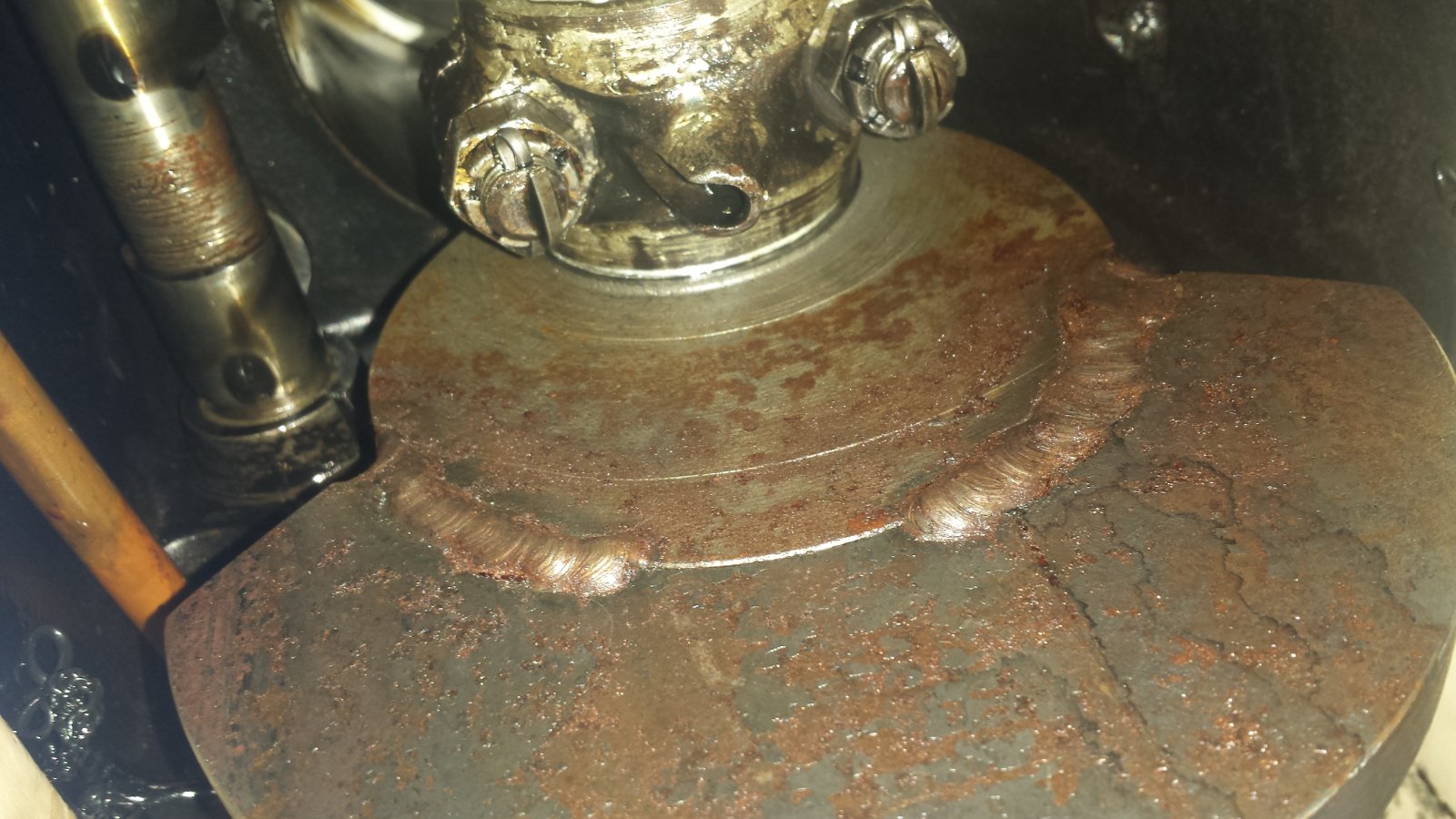

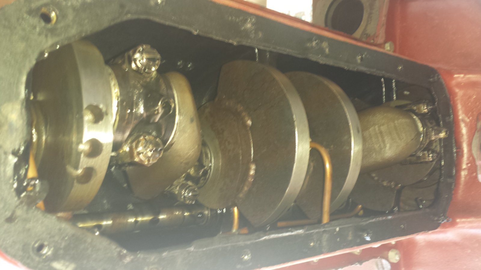

I pulled the head and pan cover, Crank is threaded. Engine is bored 120 over measured 3.865. Pictures of crank below.
Thanks for looking and all information .
Mike
Michael Davis
Posts: 297
First Name: Michael
Last Name: Davis

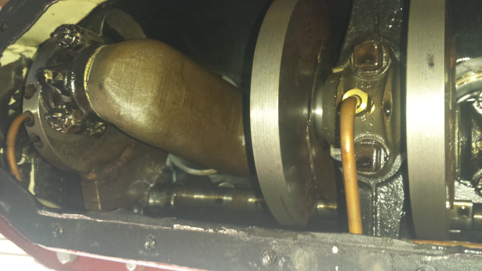

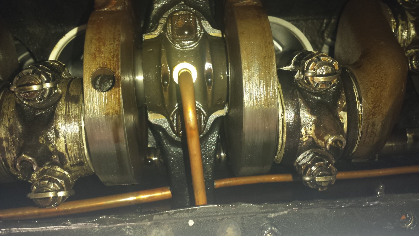

Post by Michael Davis » Tue Aug 27, 2019 6:55 pm
more pictures
Les Schubert
Posts: 1364
First Name: Les
Last Name: Schubert
Location: Calgary
Post by Les Schubert » Tue Aug 27, 2019 7:38 pm
Very interesting engine, different than I would do it (but that doesn’t make it wrong)!
Pressure mains, but dipper rods
The mains use T caps. I figure 1-7/16” is the maximum safe diameter there.
Are the rods A? Must be considering the dippers.
Interesting
Thank you for the pictures
Kevin Pharis
Posts: 1655
First Name: Kevin
Last Name: Pharis
Post by Kevin Pharis » Tue Aug 27, 2019 11:08 pm
Model A rods for sure, and they look full length. That means it’ll have the high wristpin Jahns pistons in it. Pistons are really good for top end oiling! ;) Valves look oversize, and there must be a VW pump on the back of the cam
