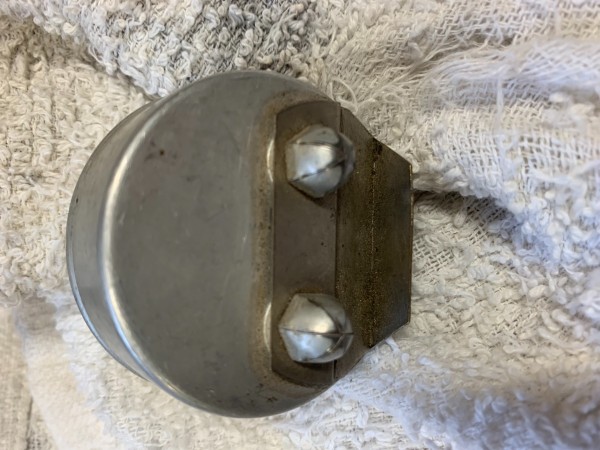

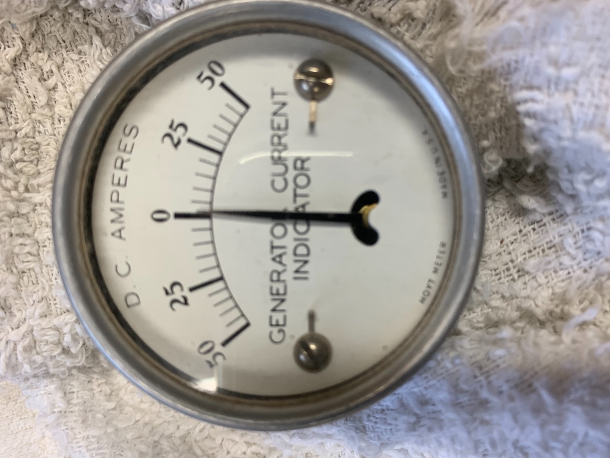

I have this generator current tester. I’m not sure if it’s for T’s or how to use it. Any ideas?

Had one similar some years back, easy to use, just put the back of it along any live wire or + battery cable and will read the amps in the circuit.

Thank you, I can’t wait to see the current draw when using the electric starter

If you use that to measure current draw, you still won't know how much current the starter pulls, and you'll destroy the meter, to boot. Even just spinning and not engaging the motor, the amperage will wildly exceed your meter's rating.

Agree with Scott on that, fine for checking the running amps but would fry it for cranking amps.

Thank you guys for saving my tool. I would never though the starter would draw over 50 amps

FYI...70 amps free running, 150-160 Amps cranking engine and 450 Amps stalled at 12 pounds of torque. A really good starter will push a little over 13 pounds, and will have even higher amperage, but 12 was the spec.
