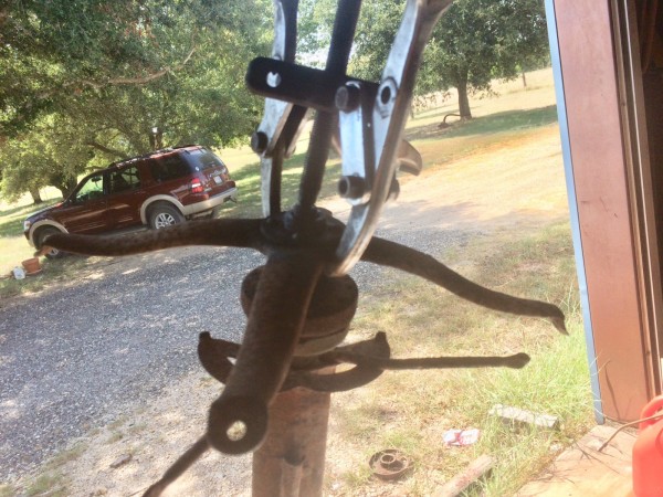

Tim, the handle can be freed up. hardest part might be getting it off the car. Then heat the sleeve to cherry red and allow to cool. Use a hammer to beat on the sleeve, backwards and forwards for its length, and round and round. This will break down the binding rust. Check for movement. Repeat heat and pounding if necessary. Once you have even the slightest movement, add some penetrant/lubricant and work away at increasing that movement. It will happen, and you will wonder why you didn't do it sooner. I buy seized crank handles when I can, free them up, and offer them at swap meets.
Hope this helps.

What Allan said....but let me add one extra step....quench with water. Always on dissimilar metals rusted together. I too get enjoyment separating rusted Model T cranks.....

George, if you unscrew the cover and remove the wheel, cover and centre shaft, the job will be much easier.Now you can get some heat into it without causing any damage. A couple of cycles of heating/cooling should break it loose. Setting it up in a press may be a better way of applying pressure.
