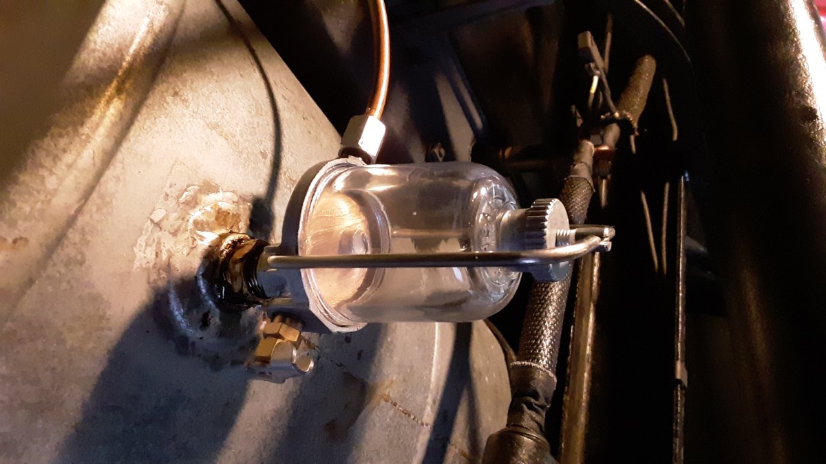

Post by Doug Keppler » Wed Aug 28, 2019 8:49 pm
Attention, NOT FOR THE PURISTS
My car had a cast iron FSB with the brass valves. I used valve lapping compound to try to seat the valves (both the shut off and the drain valves) to no avail, could not get the #$%* thing to stop dripping. So I went to Tractor supply and found this bowl for a Massey Ferguson tractor, half the price of the one from Langs. It cant be seen unless you climb under the car and it has a glass bowl so you can see what's in your gas, a fuel shut off and a filter screen, in my opinion an improvement

Re: A different option to the fuel sediment bowl
Post by Doug Keppler » Wed Aug 28, 2019 8:50 pm
Cant figure out why some pictures post 2 times

Post by mgarrett » Thu Aug 29, 2019 9:07 am
Doug,
Don't be scared! I've been using one of these on my 27 Speedster for 5 years without any issues. Unless you're planning to do some rock climbing or high-center on some off-road trails I wouldn't worry about it. The tank sits high enough to avoid most road obstacles you're likely to encounter. The transmission housing would strike a road object long before it would imperil the sediment bowl.

Post by Henry K. Lee » Thu Aug 29, 2019 11:09 am
Considering it is approximately 24” from the road surface and the glass bowl is supported by a “rubber” gasket and a plastic lower support on the bail. Really?
Energy is being absorbed. Old fatigued metal that others are trusting with their lives scares me the worst. Just my opinion with justification.

Be afraid, Hank ! Really afraid. :lol:
Seriously, sure, it's a long shot, but if you roll down an improved gravel road at a good clip, you'll be surprised how many rocks will hit your floor-boards. Much less of a possibility cruising pavement and running over homeless guys.
