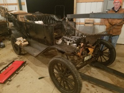

Before the cold set in Mark Eyre and I got the engine in my '13. This is a major upgrade for the car as it has been running an '18 engine for probably 70+ years. There is a lot more do do to get ready to tour but I am happy to be at this point now.

The 13 is one of those cars that just likes to run. With the exception of one bolt on the passenger side, the engine was in and bolted down inside 30 minutes. Mark's pan straightener was a godsend.

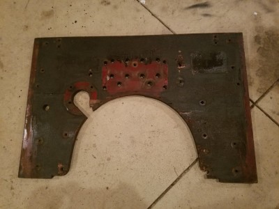

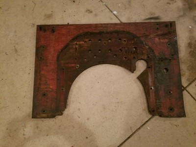

Well, that is a good and fair question Larry. I agree that the location of the patent plate on my car is very strange. What I wanted, when I pulled the dashboard apart was some clear evidence that the patent plate was moved...or even evidence that it had ever been located anywhere else on the dashboard other than where I found it. To my surprise that evidence just wasn't there. Attached is a photo of the disassembled (and very rotten) dashboard. Candidly, I would like to be proven wrong on this point as it would make the job of reassembling the car in a non-controversial manner easier.

Looking over the photos you can see that oddly, the car didn't seem to have a patent plate at all. Or at least it must have been missing for a very long time, as evidenced by the color of the dash behind the coil box vs. behind the patent plate. I'm curious what the rest of you think.

What type construction is the inside of the firewall? Wooden blocks tongue and groove together? Or multiple laminated layers? An original firewall should be blocks T&G (technically not T&G, but something similar I forget the name of). A later replacement would most likely be layers. Either type should have a finished veneer on both surfaces.
If the firewall is a later replacement (they have been available since the mid '50s at least!), that could explain the unusual data plate location and lack of nail holes in the proper location.
Also, compare the data plate's serial (car number) number with a visual assessment of the cumulative dating of the various (apparently) original parts of the car. Fords were changing quickly in those years. Although 1913 was not nearly as severe as say 1912 was, someone familiar with the '13s may be able to narrow the car down to about a five month window. If the data plate's number indicates a '12 or early '13, and the car has late '13 features, it would indicate the plate is not original to the car.

Firewall doesn't seem to be drilled for the RHD mixture, but pretty late for these old eyes. Is it drilled both sides?

A possibility here is that the firewall was replaced back when they were still offering them, and that could account for the lack of a rhd carburetor adjusting hole on the drivers side. Next, as I recall, and you can see from the photos, this car had an early large patent plate installed on the right. Do you believe this plate could be original to the car? I doubt it, and when I saw it I recall the serial number was very early, possibly a 1912 build date. If the car was built in 1912 there should be screw holes present for an angle mount speedometer. Where are they? By early calendar year 1913, they adopted the flat mount speedometer, so there could be evidence of that too, not to mention the cutout in the upper floorboard for the speedometer cable, and of course the rest of the unit on the front wheel and spindle arm.
