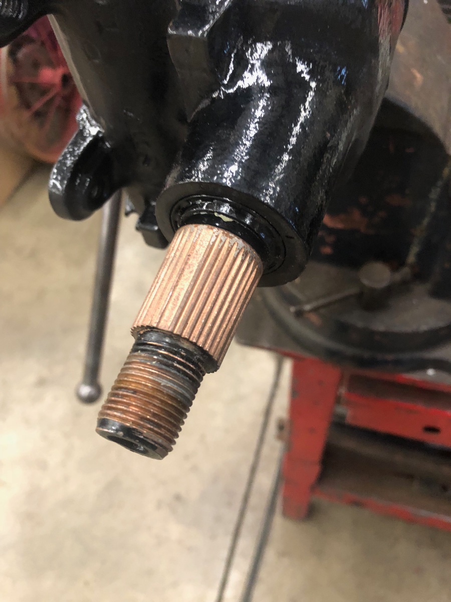

Use only USA made parts, ie, original Vega Saginaw Steering Box in good condition or new from a US manufacturer. They start at $350.00 new, used can be found from around $50.00-$100.00 and around another $30.00 in seals, grease, etc. On some mods depending on your front end set up, the original pitman arm works fine.

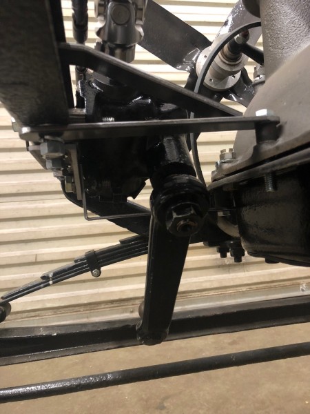

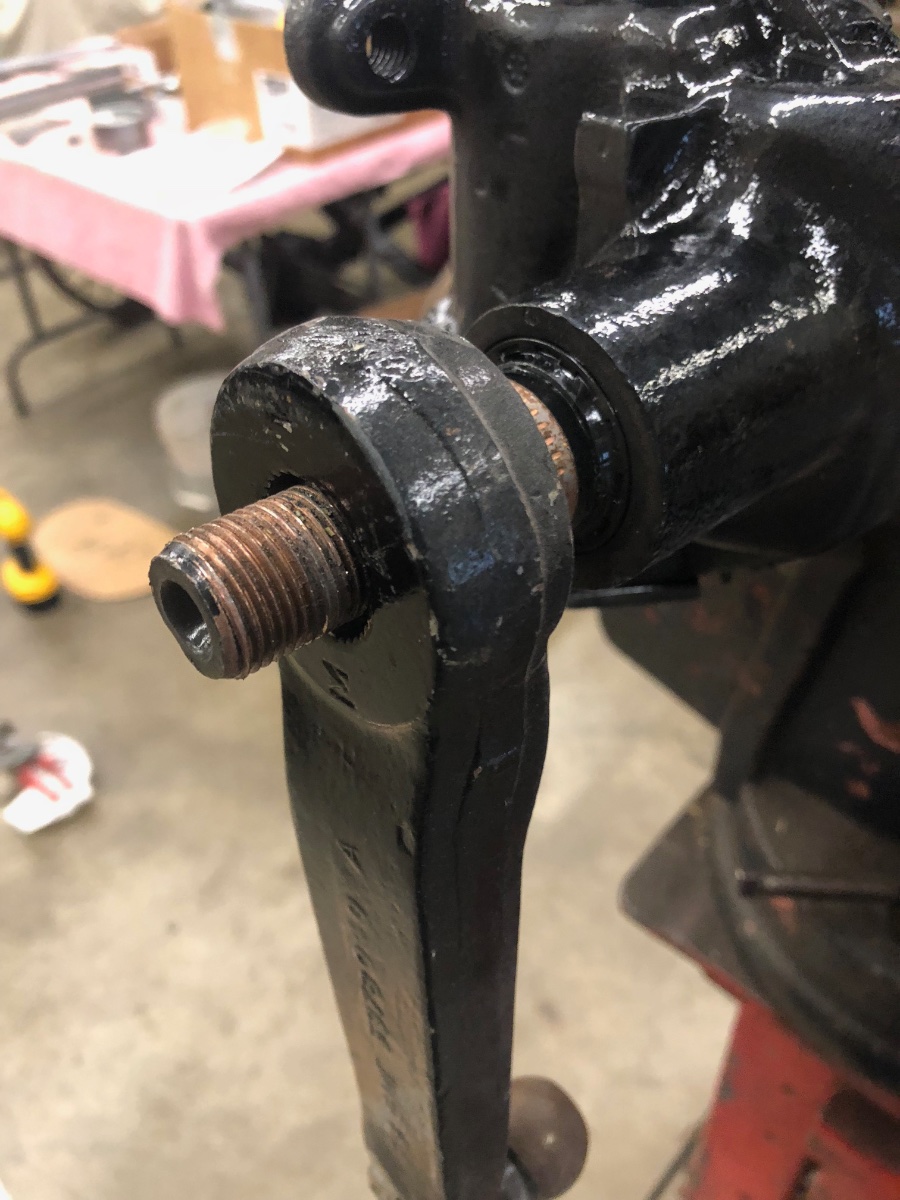

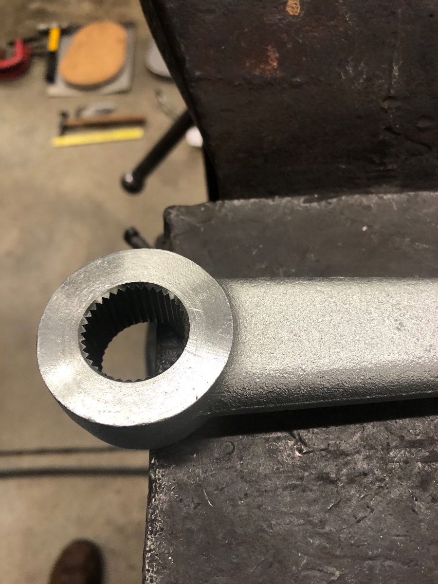

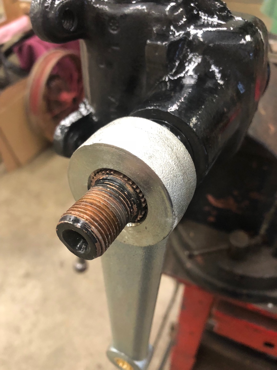

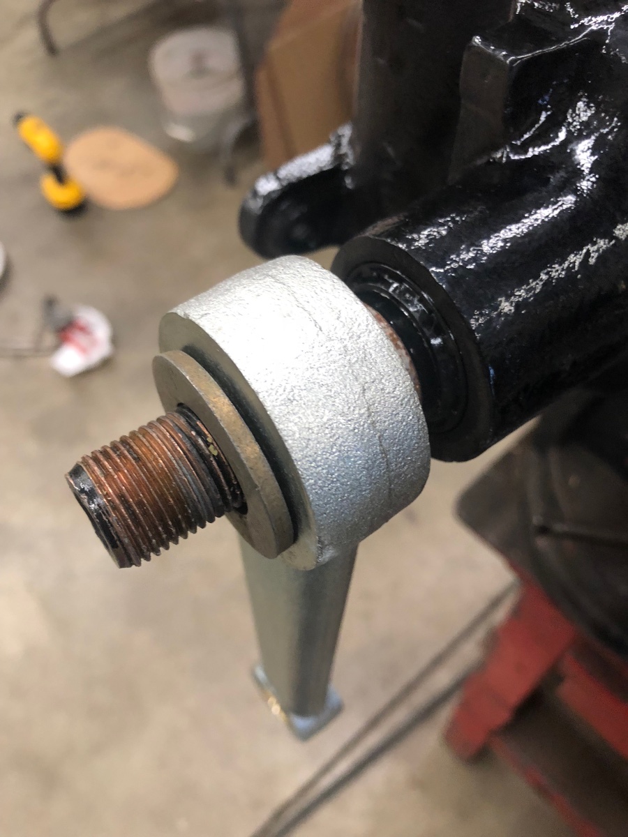

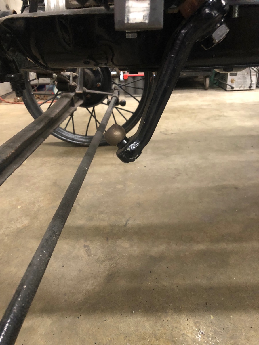

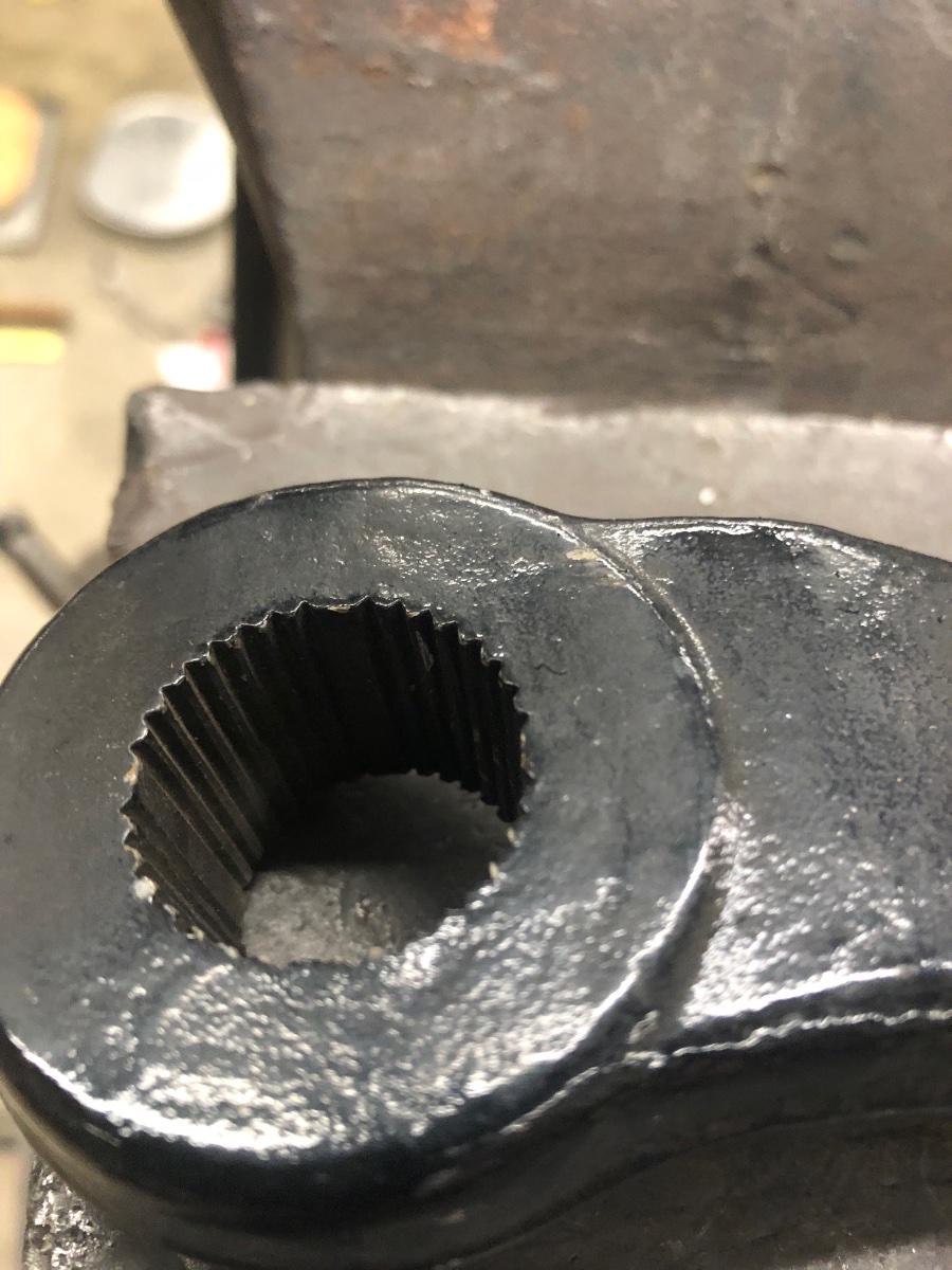

As you can see from the photos, the silver overseas made pitman arm slides way to far onto the shaft and wiggles, (not good). There are 90 degree master index notches on the originals, but you can if needed use a triangle file and re-index the factory pitman arm.

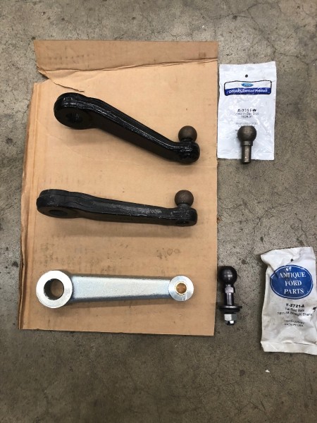

Here are some different styles of pitman arms so there are more by length, drop, and angle from the supplier.
This Speedster is using a conventional front end except for the drop axle. An original pitman works great here.

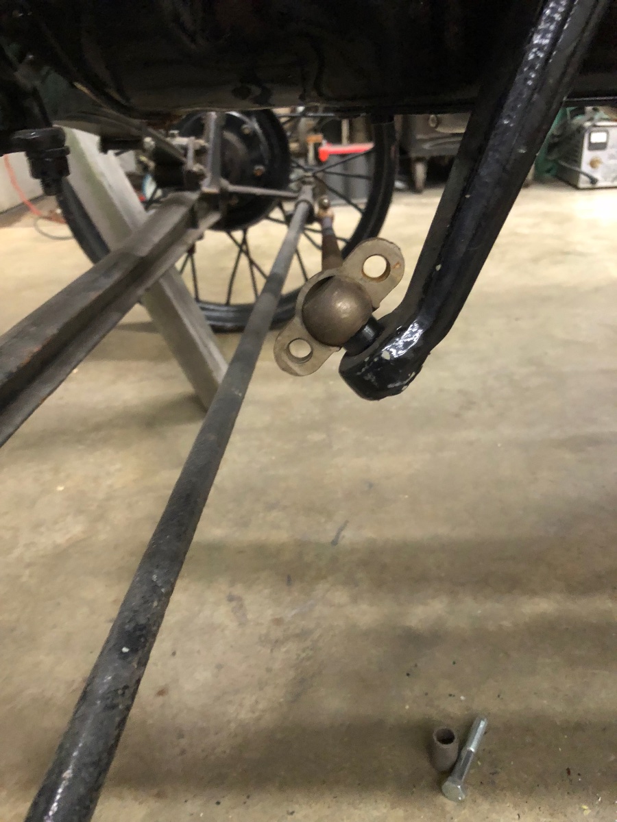

Your can use either a bolt in ball as shown or a replacement one for a Model A as shown (welding required). There are options. I find that pressing a sleeve into the oversize hole if using the bolt in style works great, then re-drill as needed.

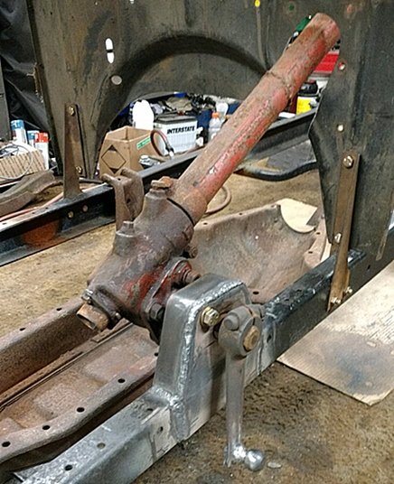

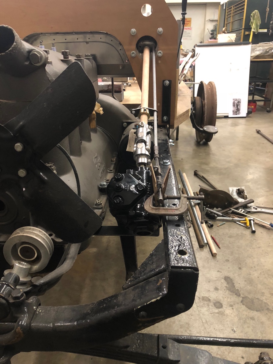

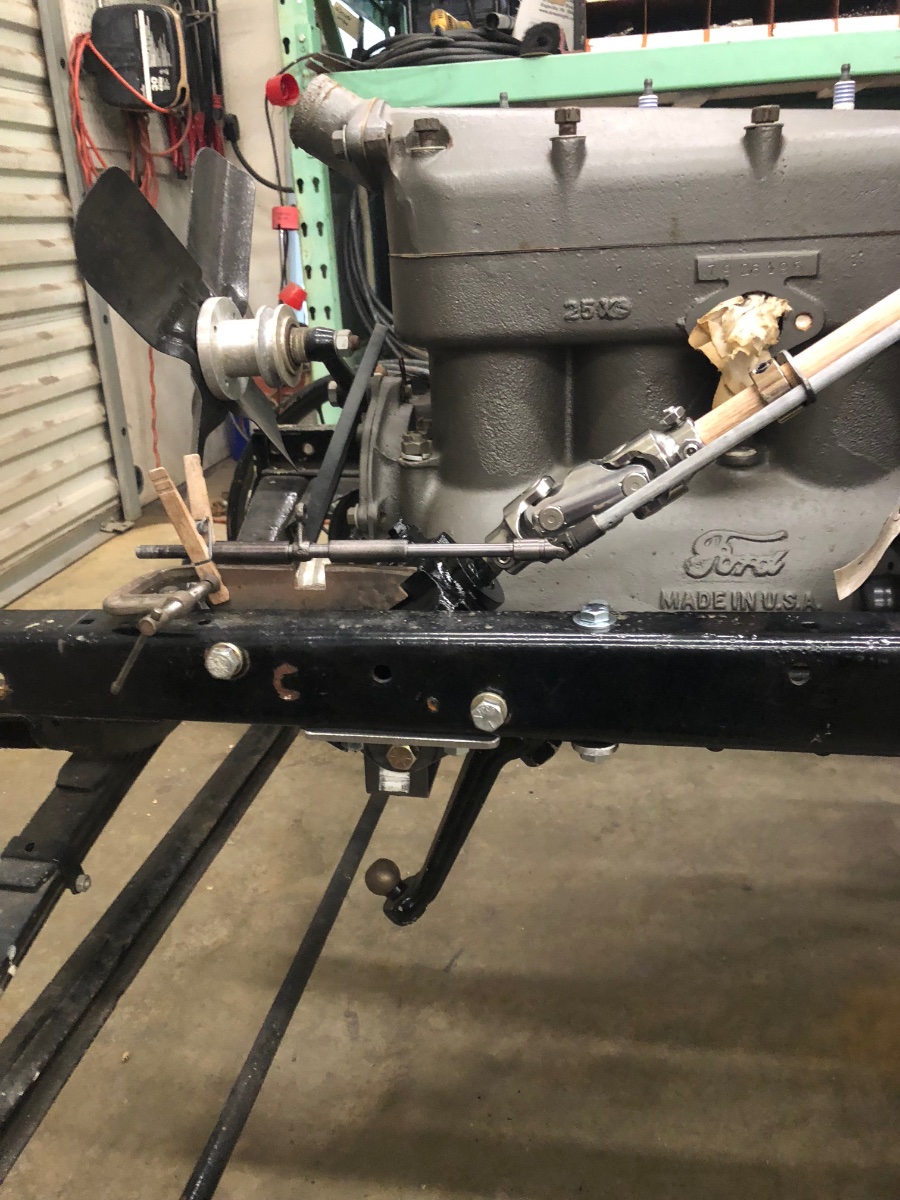

Now comes the setting of the box, be patient and take your time. The geometry of steering as stated by the early books of the 1910's thru 1930's says it best, "The straightest of angles (pushing and pulling) must be maintained in order for the components to work in harmony". I just can not stress this statement enough. I have seen so many beautiful modifications fail due to a high angle coming from the pitman arm. It will under steer and load up. Think of an old car you had as a teenager that turned around a corner, but when you were coming out of the radius, you had to turn the wheel a lot to straighten up, understeer due due worn components. Same applies to poor geometry. Every action has a reaction.
Now we find the sweet spot where to mount. For this application it is a setting approximately 1 1/2' in a vertical line from the back edge of the center link to the front edge of the ball in the pitman arm. (see photos)
I will be providing other templates for these brackets so do't panic.
Since all the torque has been redirected to the frame instead of the firewall (those gears are in the box now) we must brace the frame at both the lower and upper sections. Do NOT weld on the frame! These frames are of a high carbon steel, micro fractures will occur. I have seen others break!
You can see by the photos, the spark mechanism can be maintained with another modification. Simple. I use wooden 3/4" dowel rod for mock up purposes. For those with deep sumps, I machine a cut out or take the milling machine to remove excess fins, and weld in a recess if needed.

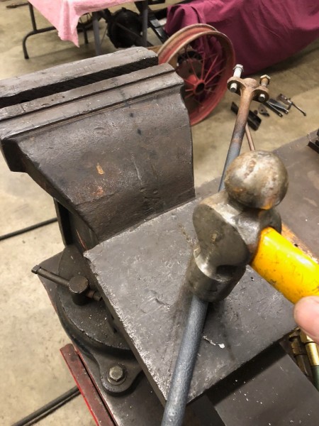

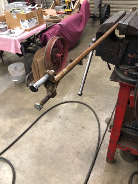

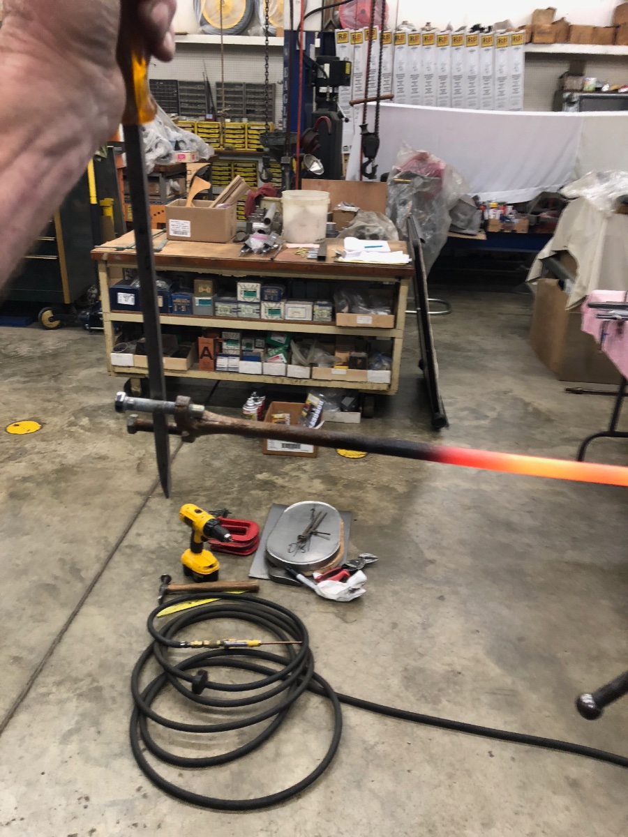

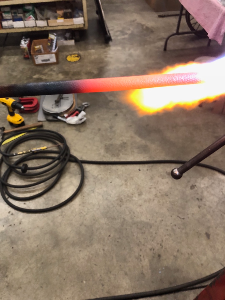

Had a little more time so I started the twist modification and reforge of the steel. The drag link needs to be twisted approximately 84 degrees to the right.
Good fit, ready for more in the next few days.

Another option for the drag link is to use model A tie rod ends. If you have the ability to thread some 3/4” heavy wall tube

Hank, are the reproduction drag links with the new threaded fittings on the end, not the correct length for your application? It would have made setting the angle of the ball ends a piece of cake, at a cost of course.

Allan I have found that the shortest of the factory links works best, but all will work. You have to take a triangle file and remove the master keys from inside a factory pitman arm that is it and rest one to two notches over.
