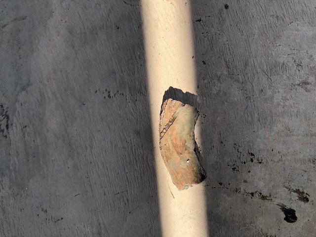

Well pulled the rear end out again. This is three times in two weekend. I am getting really good at this.
Dropped a nickle to a club member that really knows just about anything T related.
He said don't drive it another foot.
The problem is with the thrust washer has broken.
I had to do a preliminary check on the ring and pinon to verify that they are usable.
This is fell out when the rear axle rotated and spilled all the gear oil that I had just put in.
Now I hope I have place an order for all the necessary replace parts.
