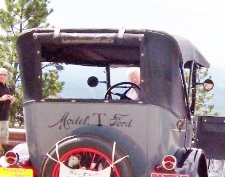

Post by DanTreace » Tue Sep 10, 2019 12:32 pm
Had a local vinyl sign company make this adhesive sticker from scan, they installed, as I usually get air bubbles under those decals :shock:
Done in 2004 and still looks like new today.

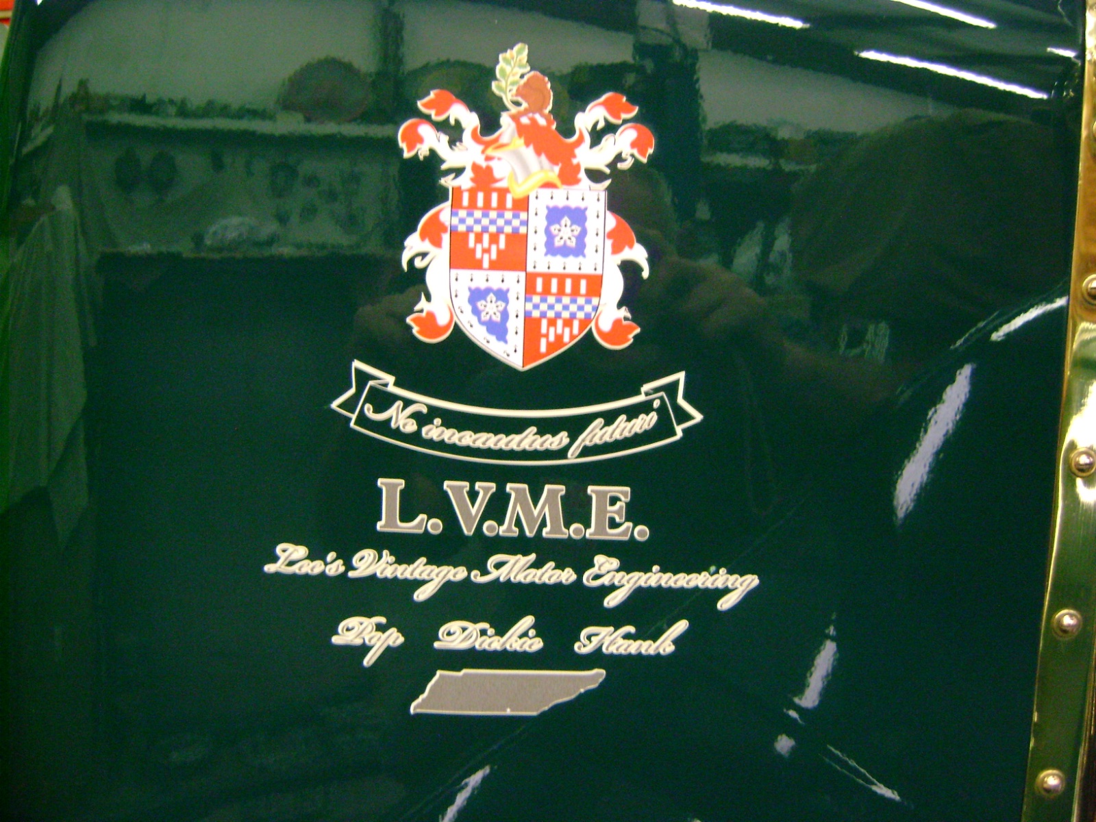

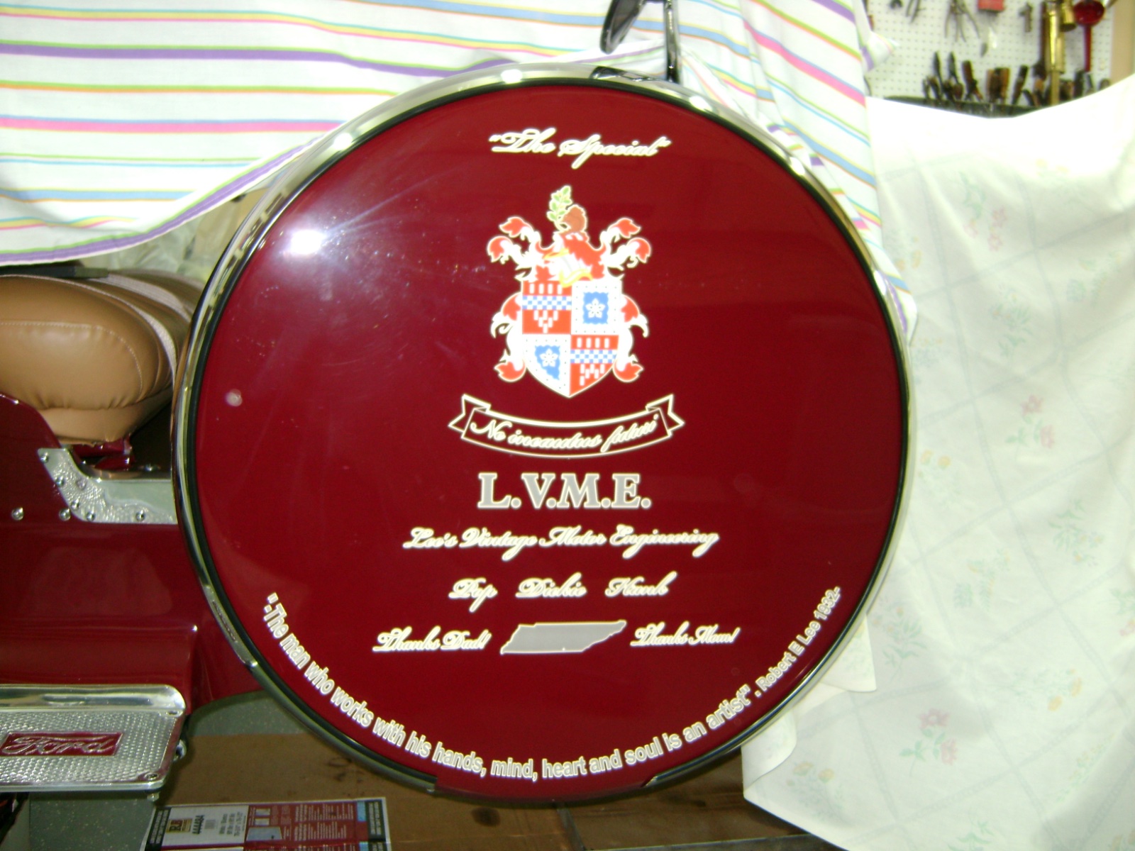

Post by Henry K. Lee » Tue Sep 10, 2019 7:40 pm
Had glare but the detail is excellent .

Very nice Henry !

Post by Henry K. Lee » Tue Sep 10, 2019 8:01 pm
Another with better detail, photo taking that is!
As stated by others, a good quality is key. Would loved to have these hand done, but those with the talent are hard to find in my neck of the woods.

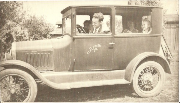

People have been putting graphics on T's for years.
The old forums are a gold mine of information.

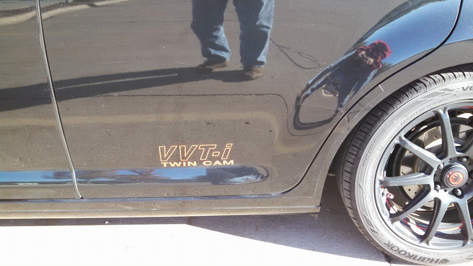

Post by TRDxB2 » Wed Sep 11, 2019 1:12 am
I put this vinyl decal on the side of my daily driver in 2009 and 70k miles ago. Was claimed to use 7yr vinyl - still looks good after several 1800 mile Interstate trips in all kinds of weather. Hit it with the sprayer at the car wash, not recommended, and the Dealer's auto washer after maintenance. Put it on as Jim described. Best part is if you need to take it off for some reason in the future - no problem.

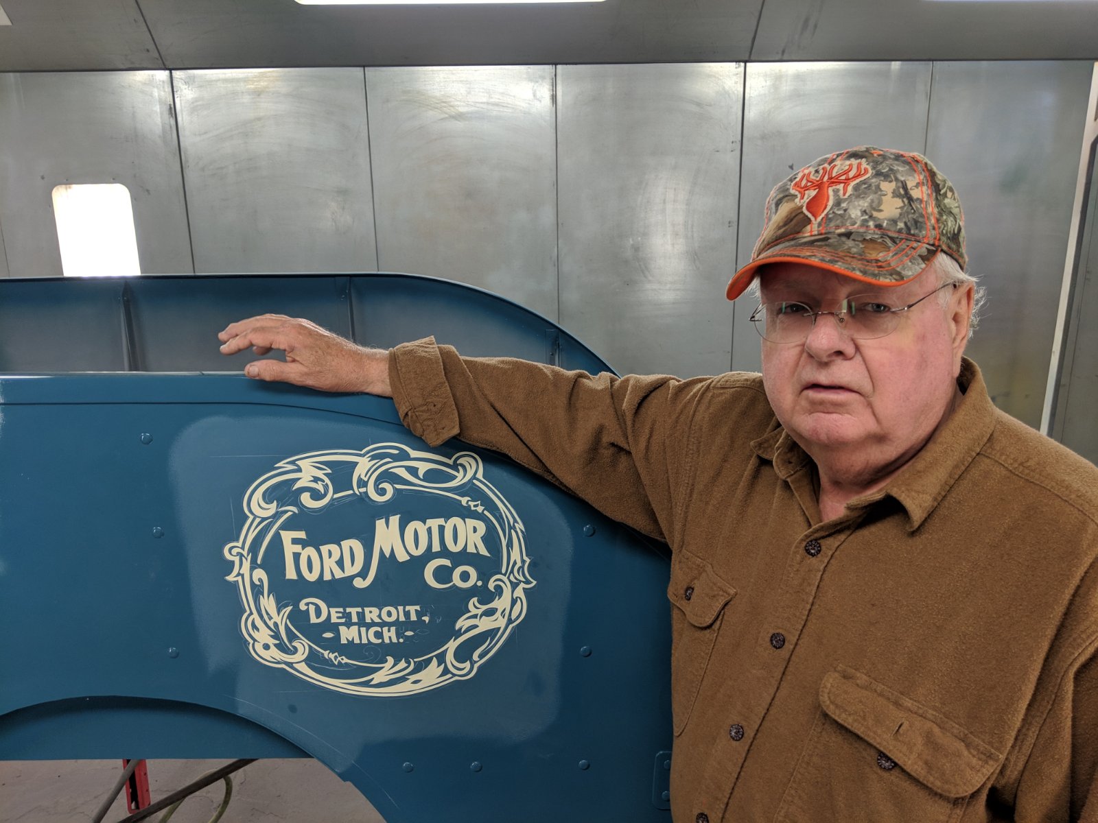

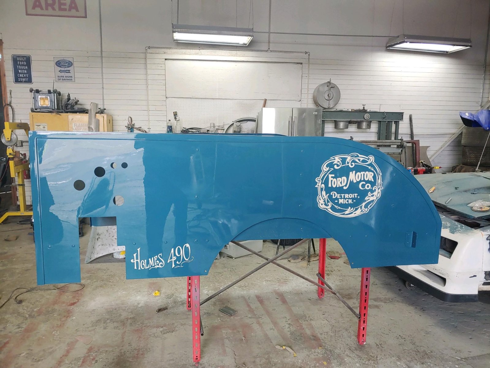

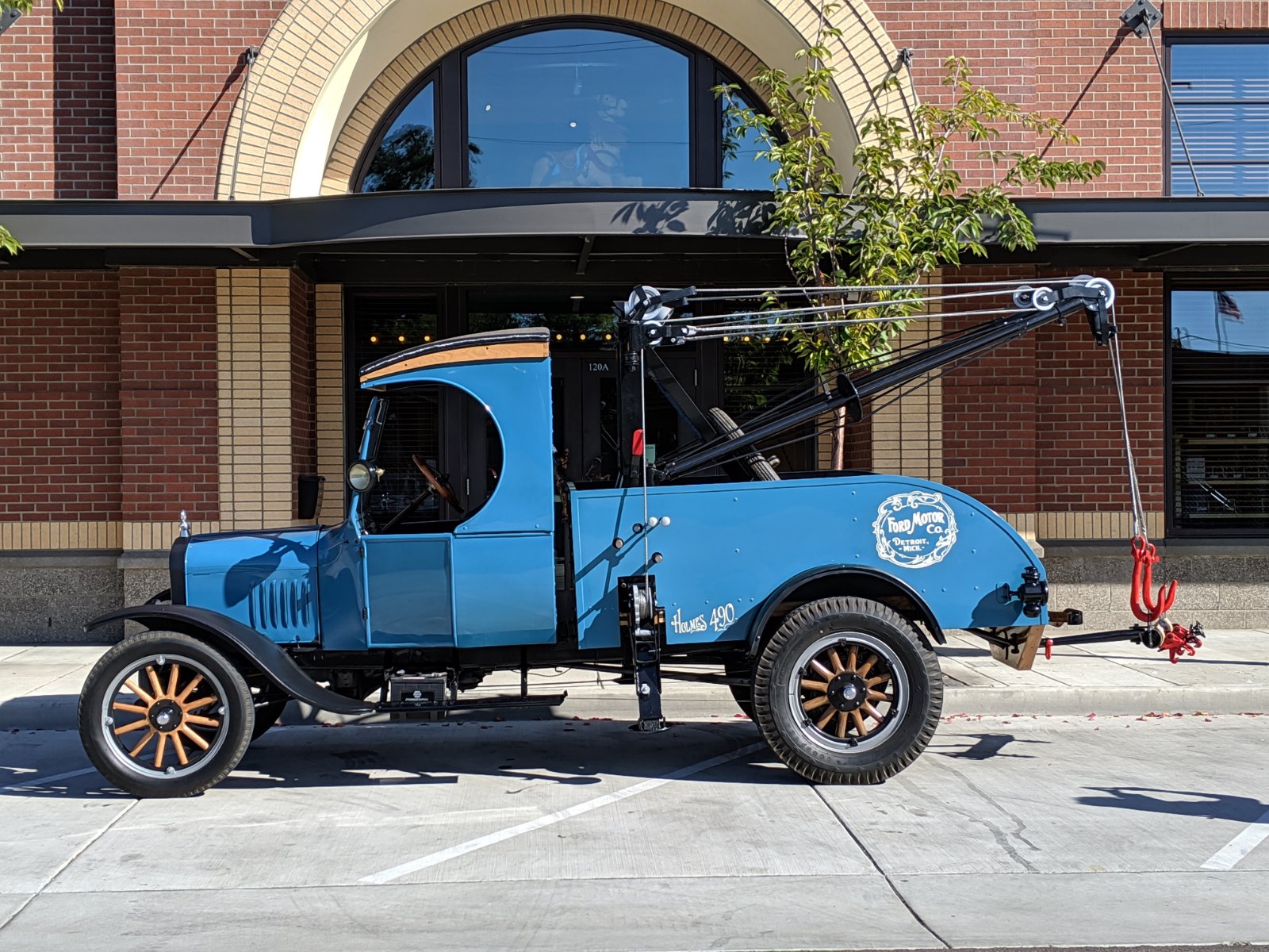

Post by 1925TT » Tue Sep 24, 2019 12:06 am
Go for graphics. I got mine hand done and under the clear coat. No regrets at all. It's a dying art, but this guy was amazing. Nothing beats looking real close and seeing those brush marks.
Look around for sign painters or ask around at custom paint shops. They can probably point you toward someone still doing it.

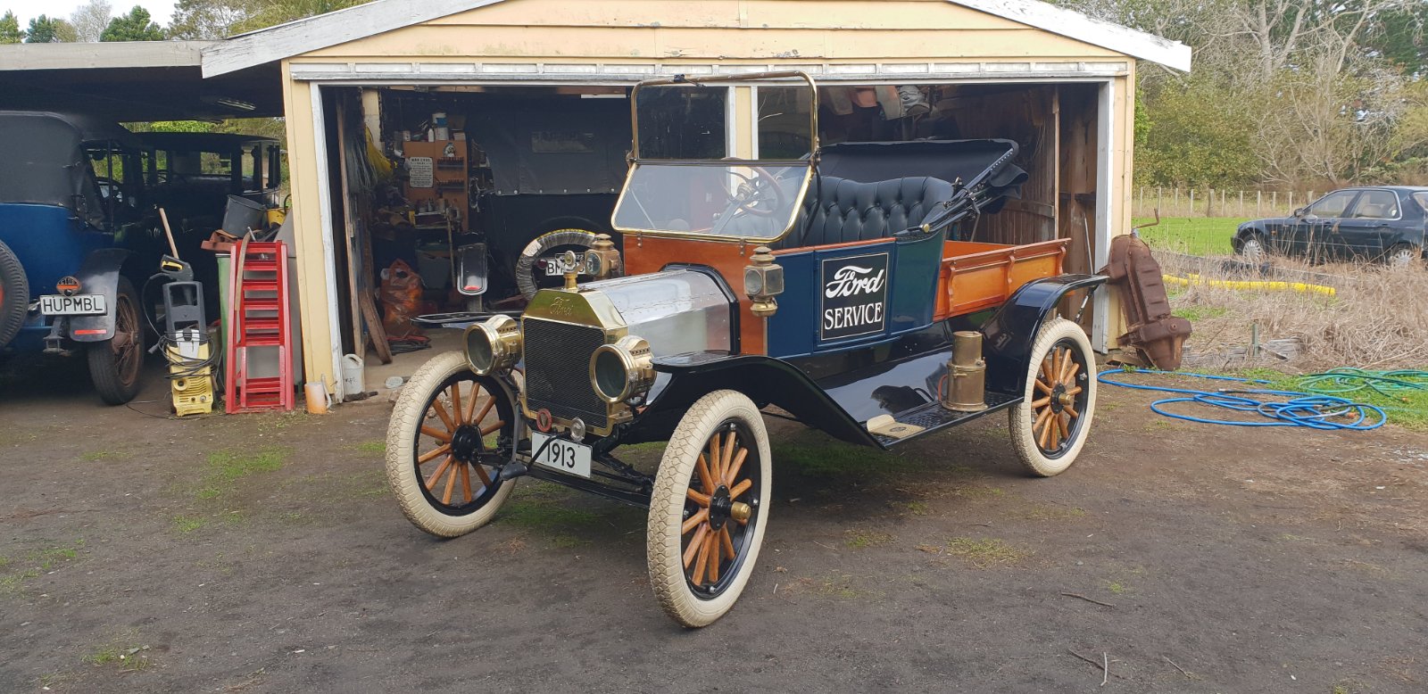

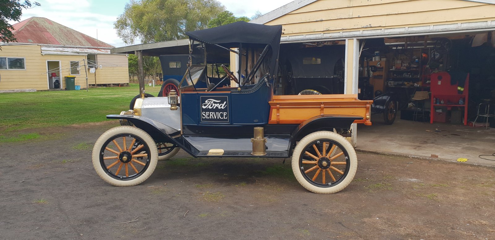

Post by Lawrence » Tue Sep 24, 2019 5:41 am
Magnetic sign
Magnetic sign

Post by Lawrence » Tue Sep 24, 2019 5:48 am
Just finished restoring my dads roadster, and the magnetic signs work a treat, can place them on the other t's if I like. Took the idea off and old black and white photo off the internet of the same bodied pickup as a service car. Cheers chris

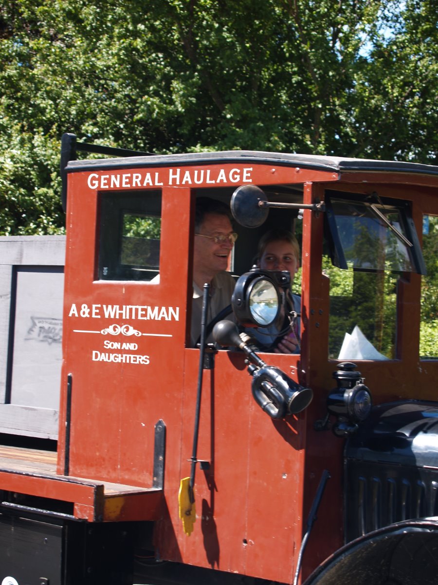

Post by A Whiteman » Tue Sep 24, 2019 6:06 am
I use vinyl decals from the local sign writer shop. They cut from a graphic. My TT has had them for over 11 years now, still look just as good as when applied.
(1 son and 3 daughters so the 'daughters' is a little larger by ratio ;-) )

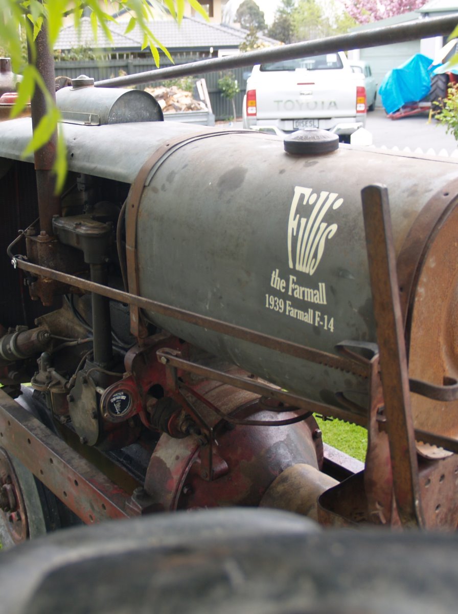

Post by A Whiteman » Tue Sep 24, 2019 6:10 am
Looks good on my tractors too :-)

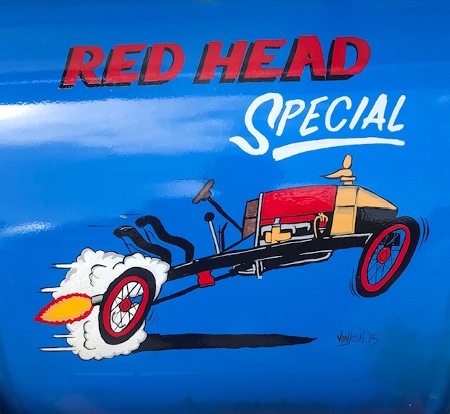

Post by andy72 » Tue Sep 24, 2019 2:04 pm
I had a local artist paint my gas tank
