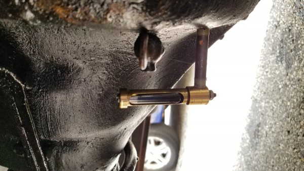

Hey guys, just installed an oil sight gauge. The oil level doesn't appear to change. It was at this level (above the upper petcock) before I added a quart of oil. And it was still at that level after I added a quart of oil. No oil came out of the upper petcock when first opened and just a little trickled out after adding the quart. How do I get rid of the vacuum in the tube so the reading is trustable?

The top should be vented

What Scott said. There is probably a vent hole in the top, but it may be blocked by a non-original gasket. :)

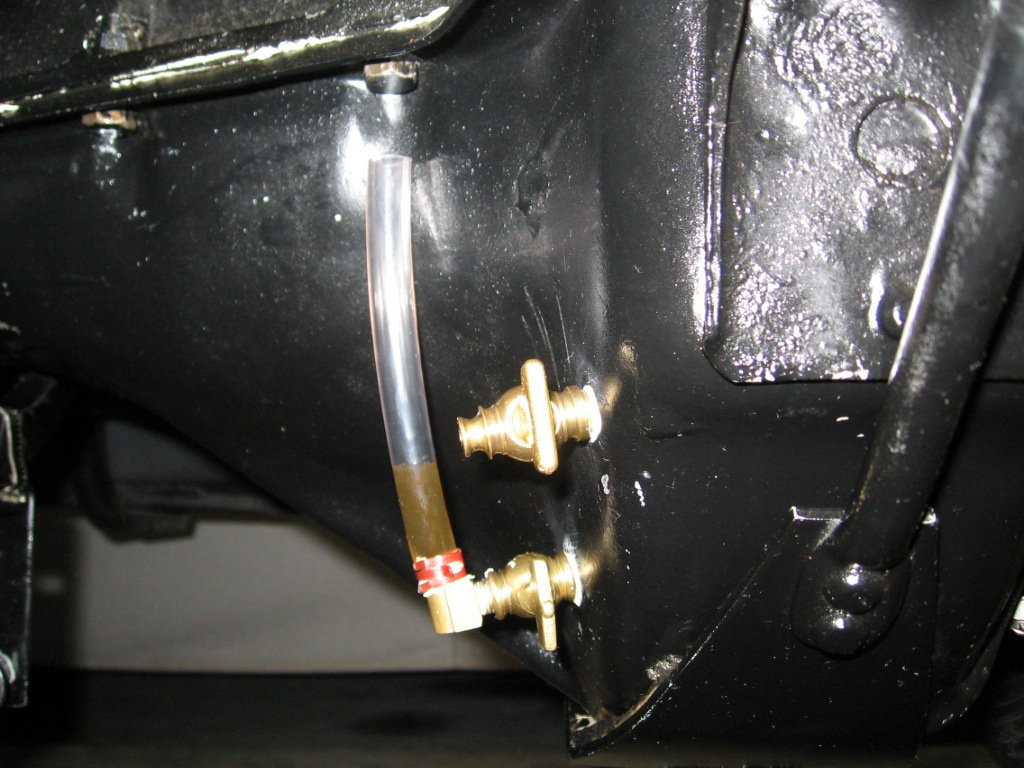

If I was at home I'd post a picture of my oil sight tube. Just a short piece of clear plastic tubing clamped on both petcocks. To check the oil I just open both petcocks and watch the oil reach its level. When the level is down to halfway between the petcocks I add a quart. You drive with the petcocks closed so if you lose the tube you lose no oil.

Steve's oil gauge:

Martyn Vowell had one of those unventilated sight gauges on his car. He thought he was good till I checked it by unscrewing the cap and watched it empty itself. Fortunately he was only a qt./ 1/2 low. We vented the cap and no issues since and he keeps the petcock closed

I took the sight tube off, no vent hole to be found. So I drilled one in. Now it reads correctly. For how much I drive this car, I am happy to have this quick way to make sure I have enough oil. Back to driving!

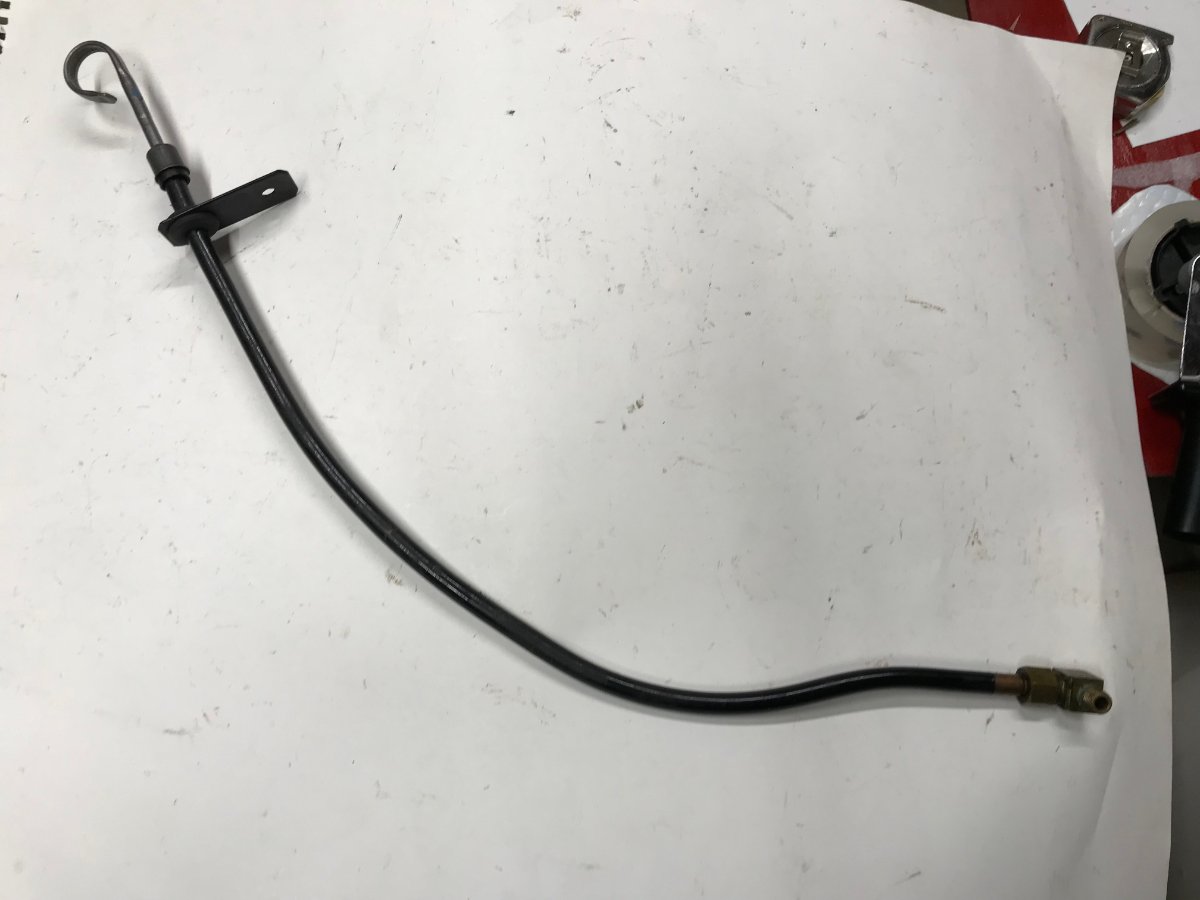

I almost bought a sight gauge but then decided to go with the dipstick sold by antique auto ranch. With my bum leg and less than perfect knees, I was looking for an easy way to verify oil level. Anything that required turning the oil petcocks on a regular basis had little appeal. I've had the dipstick installed for about 850 miles and am quite happy with it. Yeah, it's not "period" but I drive my car and consider it to be an important safety item.

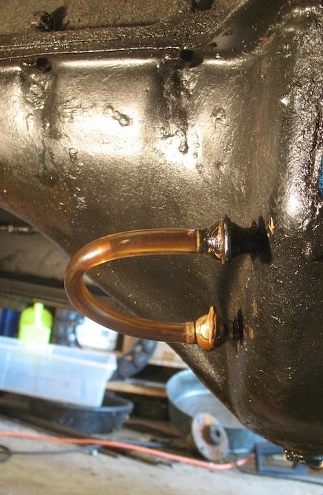

Steve, your idea of a piece of tubing for a sight gauge is interesting and indeed you can stay safe by shutting off the stopcocks when not in use. I had always assumed a sight gauge was designed so you could lean over and take a look at the gauge thereby determining oil level without having to lay down on the ground under your car. This advantage is lost if you have to open the stopcocks to read the gauge. The Jelf gauge does have the advantage that you don't have to dribble oil on the ground, however you must open both cocks simultaneously.
Mark's version requires only opening one gauge making it half the bother of Steve's version. A bit of gunk can get into the open tube, but that probably isn't a large issue and is outweighed by being able to tell how high the oil level rises even when the top cock is submerged.
