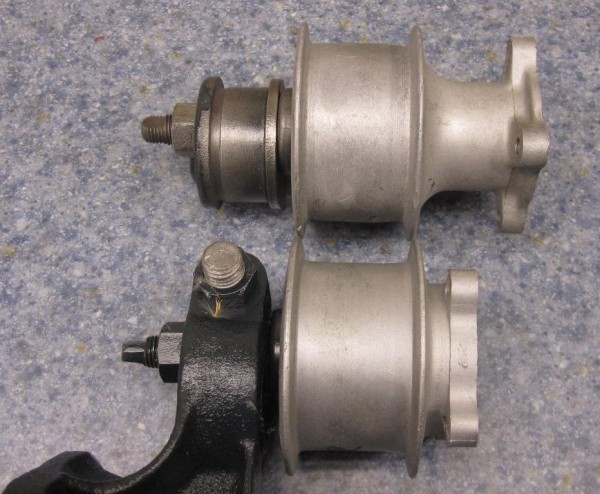

The pulley I removed looked like the one on top. The new pulley with ball bearings looks like the bottom. I installed a 2" spacer and boy can you feel the air going into the radiator. With the old pulley you could barely feel the air going into the radiator. I ran it in the shop for about 15 minutes and the temp ranged from about 190 at the rear of the head to 210/230 at the water outlet. At the outlet the temp would go up and down some. Radiator temp about 180. I think I got it whipped just before it whipped me.
PS
The radiator one row of tubes that are flat, 1" wide 18"' long and with 36 tubes. Is this the proper radiator?
