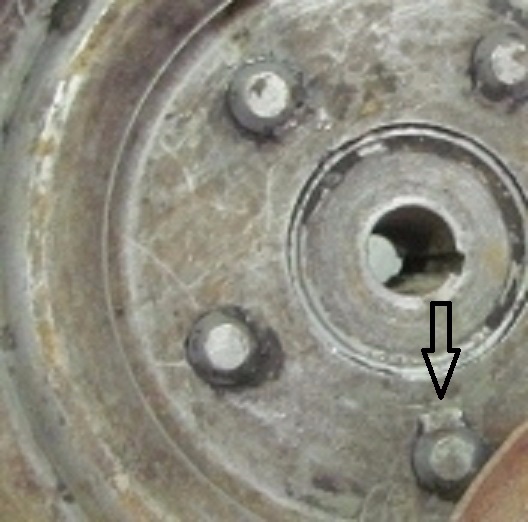

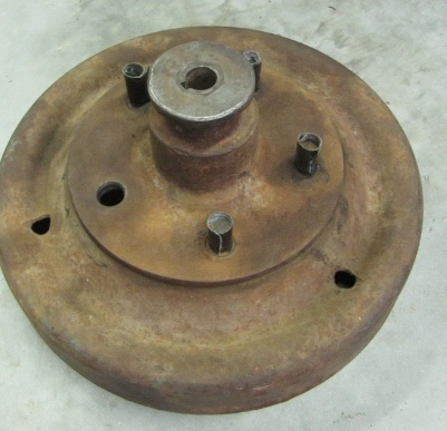

The Ford wire wheel rear drum (2889) is pressed steel, and has pressed in 'tabs' that secure the lug studs.
The Ford wire wheel rear lug studs (2888) have a flat on one edge to fit to the 'tab'.
IMG_8285 (550x413).jpg (115.99 KiB) Viewed 3057 times
There is some interference fit of the lug bolt to the hub too, but the tabs do the job of preventing twist. But some used wire drums may have those tabs busted off, and some resort to adding a dab of weld glob to secure the stud. Note black arrow pointing to a 'tab'.
Rear wire hub on top of wire drumcopy.jpg (85.06 KiB) Viewed 3057 times
