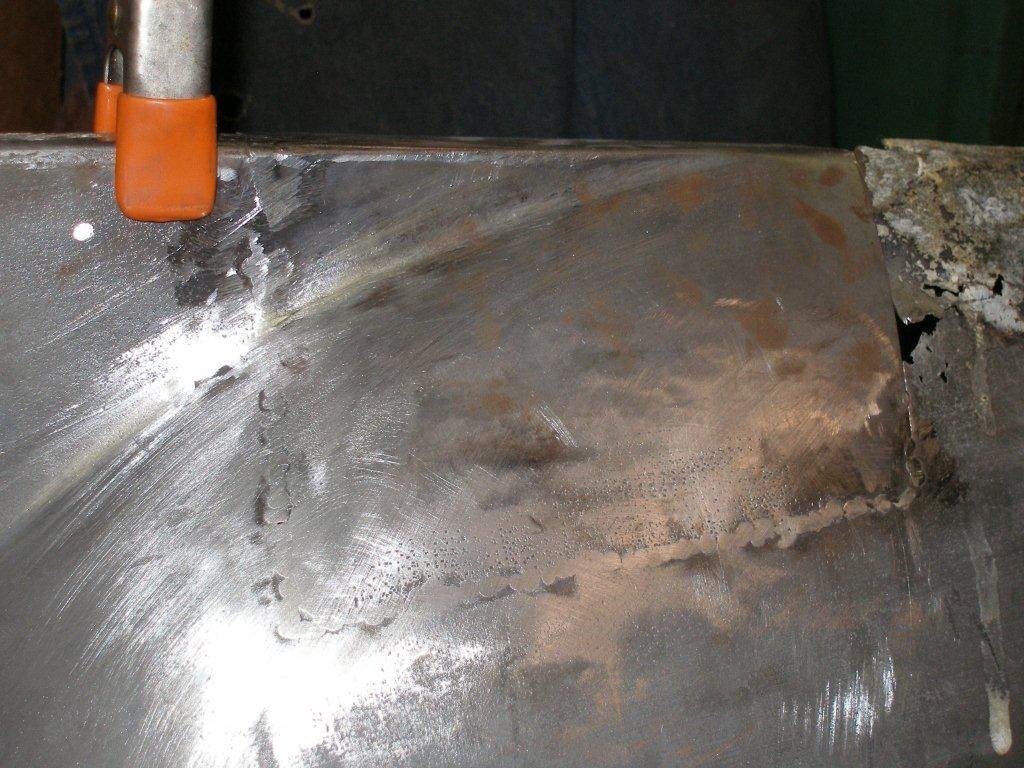

I'm surprised no one has mentioned "hammer welding" as a technique for patching or fabricating sheet metal forms. A good hand with oxy-acetylene can weld accurately butted pieces without using hardly any filler rod, and the result requires only minimal finishing. Parts are tacked in place then "stitched" to complete the seam, the "hammering" part meaning edges are brought back into alignment with a hammer and dolly block as needed as the work progresses.
"Back in the day"
many manufacturers did extensive gas welding in this manner to make complex forms on fenders and bodies as some shapes could not be stamped on dies even if production numbers could justify the expense of tooling. Most independent auto makers' cars were thus pretty much "hand made" up to WW II.
(Mind you, I ain't sayin' I can do it, but it's mighty impressive to see it done !
"Back in the day"
"Get a horse !"
- Posts: 6799
Re: Welding on a body
like this?:

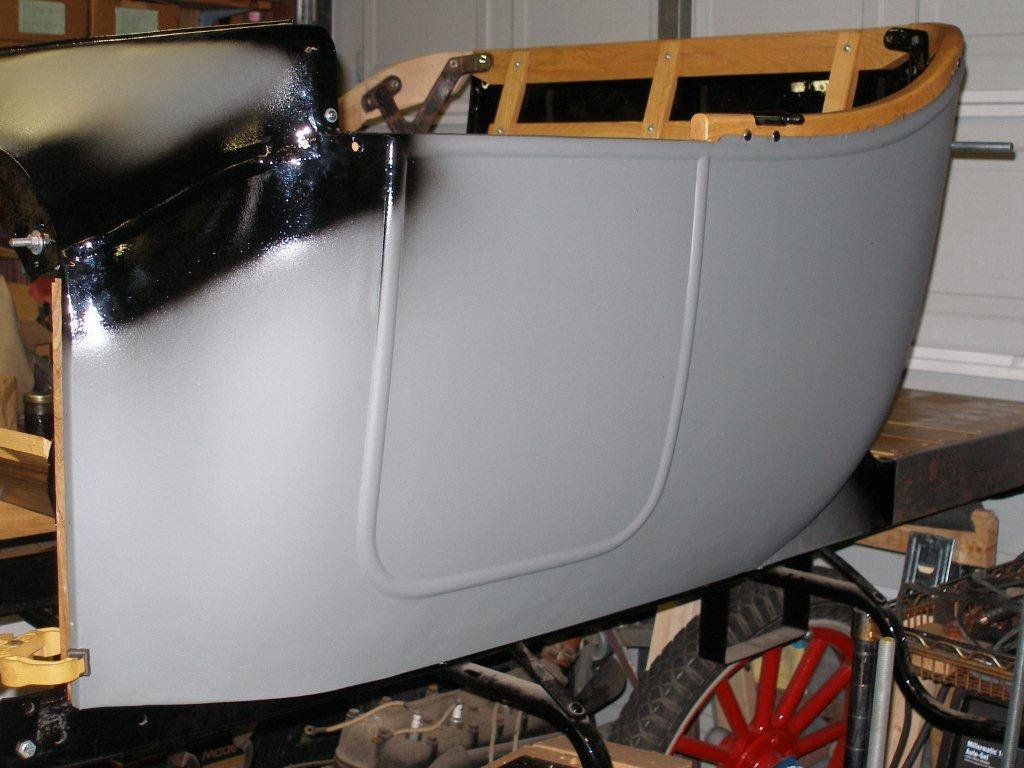

and ending something like this?

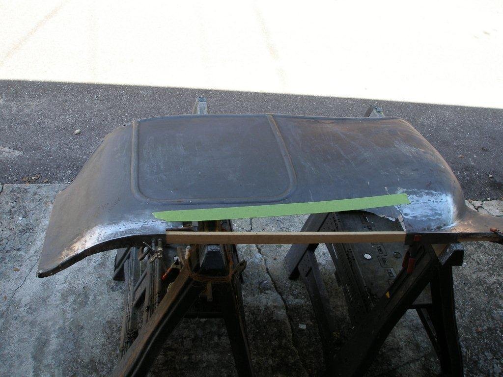

- Posts: 6799
I've never experienced expansion when hammer welding, except to create it to un-do shrinkage. If it did in fact expand, there are a couple methods to shrink metal without a whole lot of trouble.
This panel had a bulge in it like someone threw a bowling ball into the trunk...bulge is gone and panel is straight with no filler:
