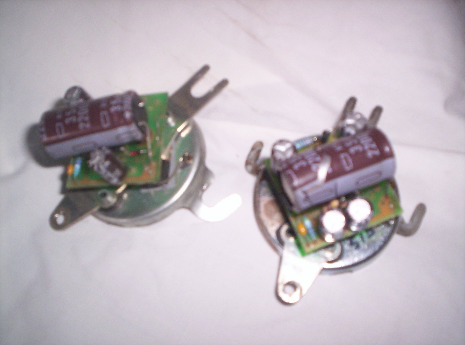

Kerry
- Posts: 1461
- Last Name: van Ekeren
Re: Vottage Regulator
I opologize for any confusion, my bad habit of always calling them cut outs, dug them out of the junk tin and as can be seen they are not just the diode cut out.
