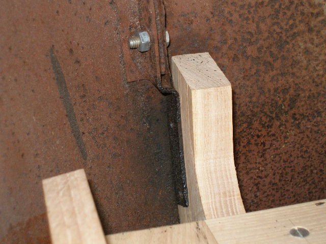

When I rewooded my '23 roadster, what appears as 100% rust, was really bare primer, with rust pitting pushing through. This picture is of an interior back panel (in brown primer) and a splash of black paint. This brown primer came off as heavy cream when hit with paint stripper. It took lots of stripper and much more time than listed on the stripper's label to get it to come off. It was TOUGH!
The black on the mounting tab is burned paint where I had to work to remove the original nuts/bolts.
