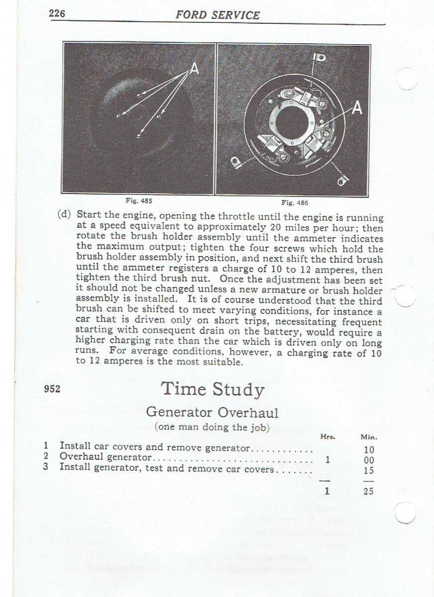

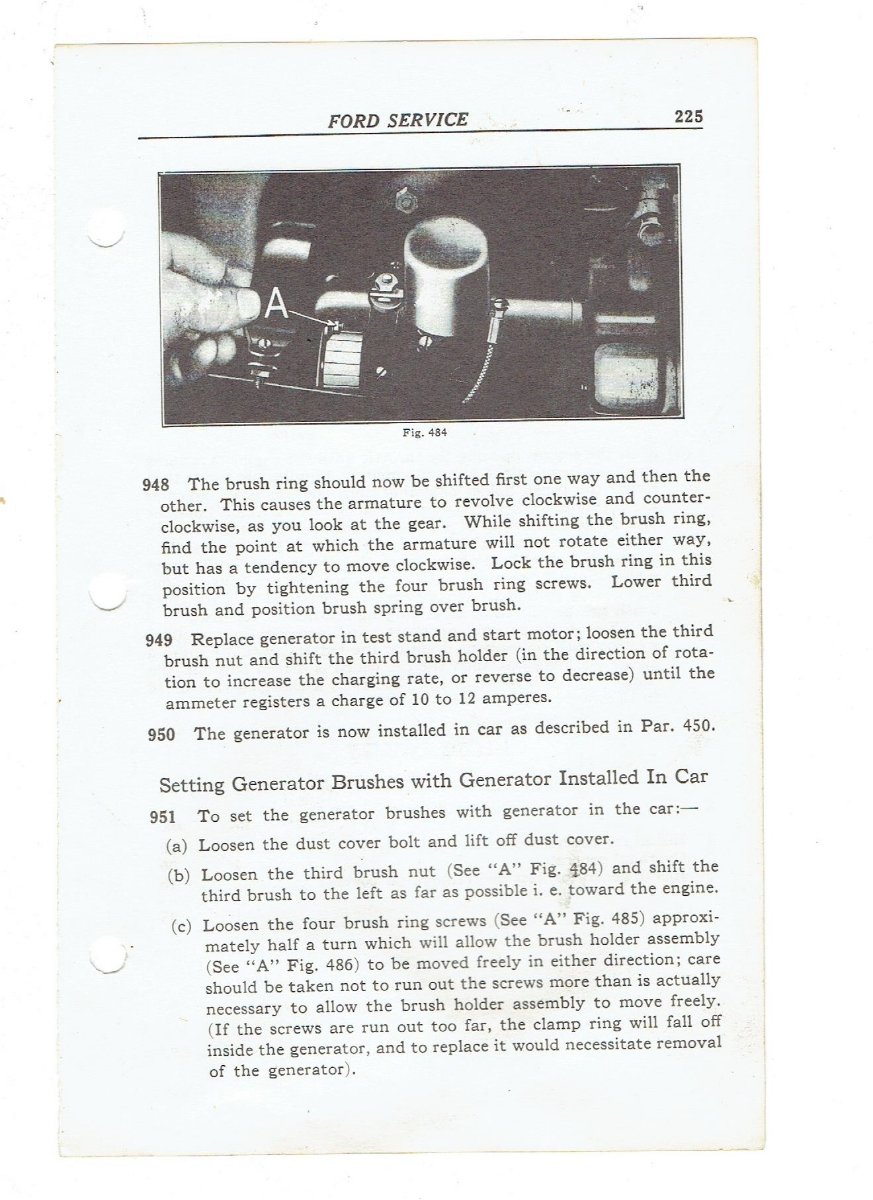

The brush plate is held in place with 4 very small screws, almost sounds like that plate has come loose. Can you move the whole plate, with the 3rd brush still tight to it. If the brush plate has come loose and none of the 4 screws are missing read the section in the Ford service manual on in car set up of the brush plate.

I think I will try the adjustment on the Brush Plate.If no luck with that I will see if I can find shorted wire or field coil
