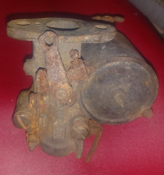

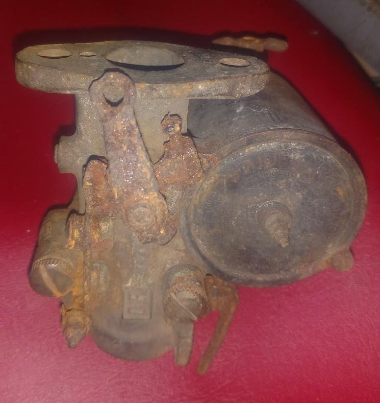

This one showed up today. This is especially for all the guys that think making the big bucks in the carburetor business is an easy way to get rich with no work.
Got home from a little concert tour over the weekend and this was waiting to bring me back to reality. I think it may have been damp a time or two and got a little surface rust on the steel parts.
2019 9 23 stromberg of rusty two.jpg (27.84 KiB) Viewed 6538 times
In reality, I kind of enjoy the ones that will take a hot wrench and a little hammer work to get ready to go back together. I have all new steel parts for these so once I get it apart it's not that big a deal to rebuild it. But I'd have to say this kind of thing is why I can't get as much done some days as I'd like.
Spent all day today working on a Rayfield that is made from unobtainium. Ruin a part on it taking it apart and you can spend your life looking for a parts carb for it.

This is beyond "weathered." Plus, nobody ever tells the people looking that he told the rebuilder to do it as cheap as possible and not to worry about how it looks when he gets it back. So if you send them a scummy looking one that is only rebuilt internally, the people looking at it think you didn't do much of a job on it and they would never send you one for their rig. Make sense? Does to me.
Take a look at the steel parts on this one. There is no rebuilding them.
Generally speaking, most T's leak enough oil that the carb will look "weathered" before long no matter how shiny it starts out.

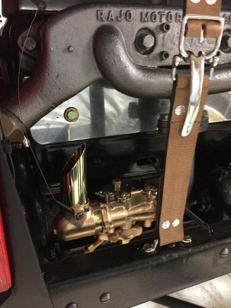

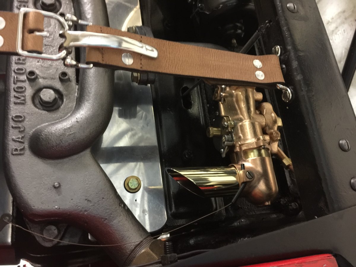

Reuben, those are just great carbs. The rank up there with U & J, Zenith S4BF and a couple others as my favorite trouble free carbs. I just sent one to Switzerland a few weeks ago and have two in the queue. I love em.
I took the liberty of setting your picture upright.
2019 9 25 kugel rayfield.JPG (49.45 KiB) Viewed 5925 times
I think there are about 50 Stromberg OF"s for every one of the Rayfields. I like your brass inlet tube, too. Zoom Zoom
Back to the shop. Always, back to the shop!!
Thanks for the picture of it mounted on your Rajo!!

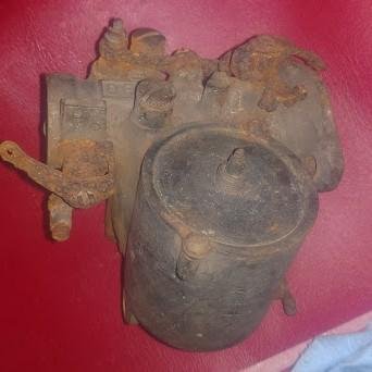

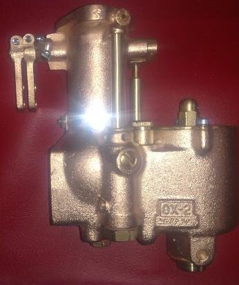

Here is where today went. Started the morning as a nasty, rusty crusty junk Stomberg OX-2 for a 27 Chrysler, the reason I have time to type this is because the new choke housing and levers are cooking in the powder coat oven and my feet hurt. About 10 hours standing on the concrete today. This is the 3rd one of these I tore down to get parts enough to make one good one out of it + I had a NOS economiser needle. I have enough parts left to do another one, though. Just took the good parts and put them on this one.
Off to New York tomorrow, engine is rebuilt, back in the car and ready to run except for the carb.
Along with this today I worked on an MV-2 Rayfield for a 1919 Auburn, it is ready to go back together and go in a box. They are a side draft air valve carb and a real pia to work on.
I also took apart an interesting air valve type early carb that was with the big pile of stuff I bought. No name on it, I don't recognize it but well made and may be NOS. Hard to tell under a 100+ years of dirt and grease mixed together. Also bead blasted three Stromberg OF's, have them in the Ultrasonic secret soup I soak them up in before the second trip to the bead blast cabinet.
17 minutes, the powder coating should be set and I can go put the choke housing on. Only 9:39 PM, hour to go.
