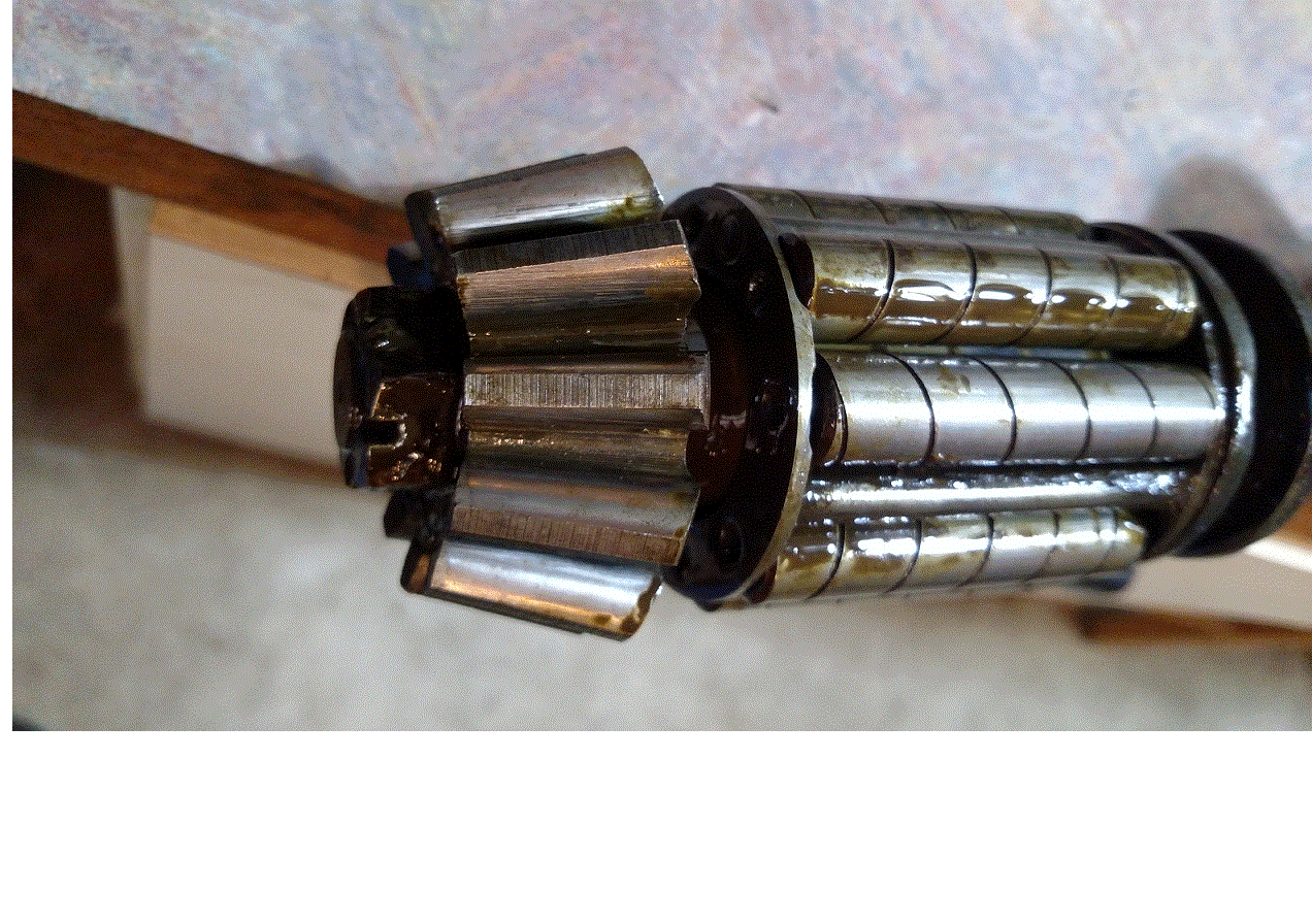

I pulled apart my spare torque tube and was encouraged by what I measured. The front bushing had been replaced and the clearance between it and the driveshaft was less than .001”. The shaft had .001” of wear compared to the adjacent diameter that was not in contact with the bushing so I suspect the bushing was reamed to fit. So far so good.
I cleaned and mic’d the bearing rollers. They should be .562” but .002” under is acceptable according to Glen’s book. The rollers measured .560” to .561” near the front but many rollers were down to .558” (.004” under) near the pinion gear where forces are greatest. I have not measured the spool I.D. yet. I still need to check the bearing fit with the cleaned spool over the bearing. If that does not reveal bearing clearance problems, does this bearing still need to be replaced?

If the car won't be driven much you could turn the bearing around with the big end toward the gear and probably get by with that. But for a driver I would ditch the stock bearing and install the FP version.

I was planning to install a sealed bearing in my car's torque tube until I discovered the condition of my spare. It's better than the worn out junk in my car. I think I'll go ahead with the FP bearing in the spare and not regret a what-if.

I would definitely run that one! However, the FP version is no doubt the best way to go.

I agree that the FP bearing set up is the way to go for a replacement. One of the best upgrades for a T you can do.
