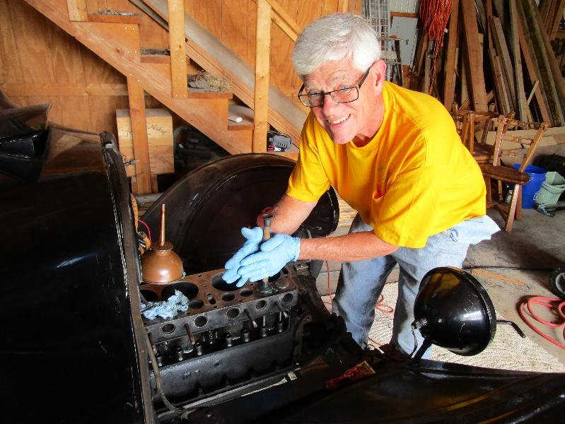

Is this one happy man, or what???
Some of you may recall my friend John, who bought a 1924 Coupe two years ago to match the one in family photos taken during the 1930's. You may also recall a couple weeks ago that I started a thread about the pistons in the engine and the poor compression/performance the engine exhibited. After removing the cylinder head and discovering oil crud on top of the pistons, we decided to do an in-car overhaul of the engine. The odd unidentifiable 0.031" cast iron pistons with FOUR rings have been a pain the rumpus from the git-go: no one makes rings for these oddballs with 1/8" rings grooves. Because the rings were well-worn with over 0.025" end gap (!), following the advice of some Model T people we ordered a set of 0.040" rings for aluminum pistons and began the tedious process of hand-filing the ends to reach the desired 0.016" gap. A lot of work, but the rings now are correct for the wear in these cylinders. But when I tried to install the rings, we discovered to our horror that the oil rings were taller than the two compression rings and wouldn't fit = unusable in these pistons. Seeing no other alternative, we bit the bullet and ordered new 0.030" aluminum pistons. While we are waiting for them to arrive, we lapped in the valves. John had not done this in over 50 years when he lapped in the valves on his 1949 Ford in the basement of his parents' house during the early 1960's. Here is a photo of John "enjoying" this Oh-so-pleasurable task on his Model T with his 76 year-old back. I think he is actually enjoying this rebuilding job! 'Gotta straighten him out on that...

If you had access to a lathe, just a few minutes work each piston to turn the oil ring groove deeper. Hope the new pistons work out for the job.
- Posts: 5620
- First Name: Henry
- Last Name: Lee
Re: Is this one happy man, or what???
Those aches and pains go away.., part of the therapy!

After doing an in car new valves and lifter job on mine this spring, I can say it makes much younger backs ache also. He does look happy tho!
