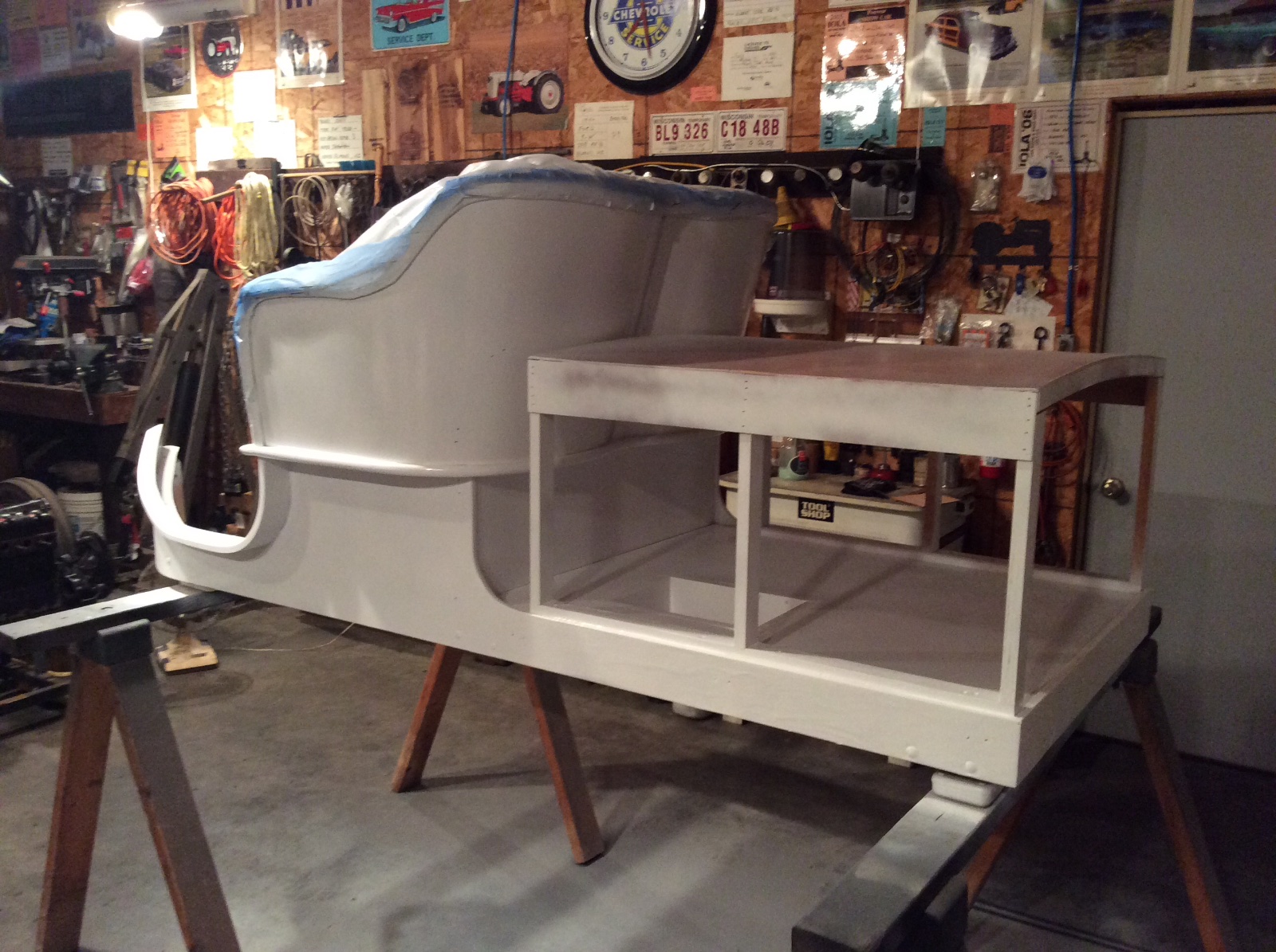

Be sure to build it with a trunk!

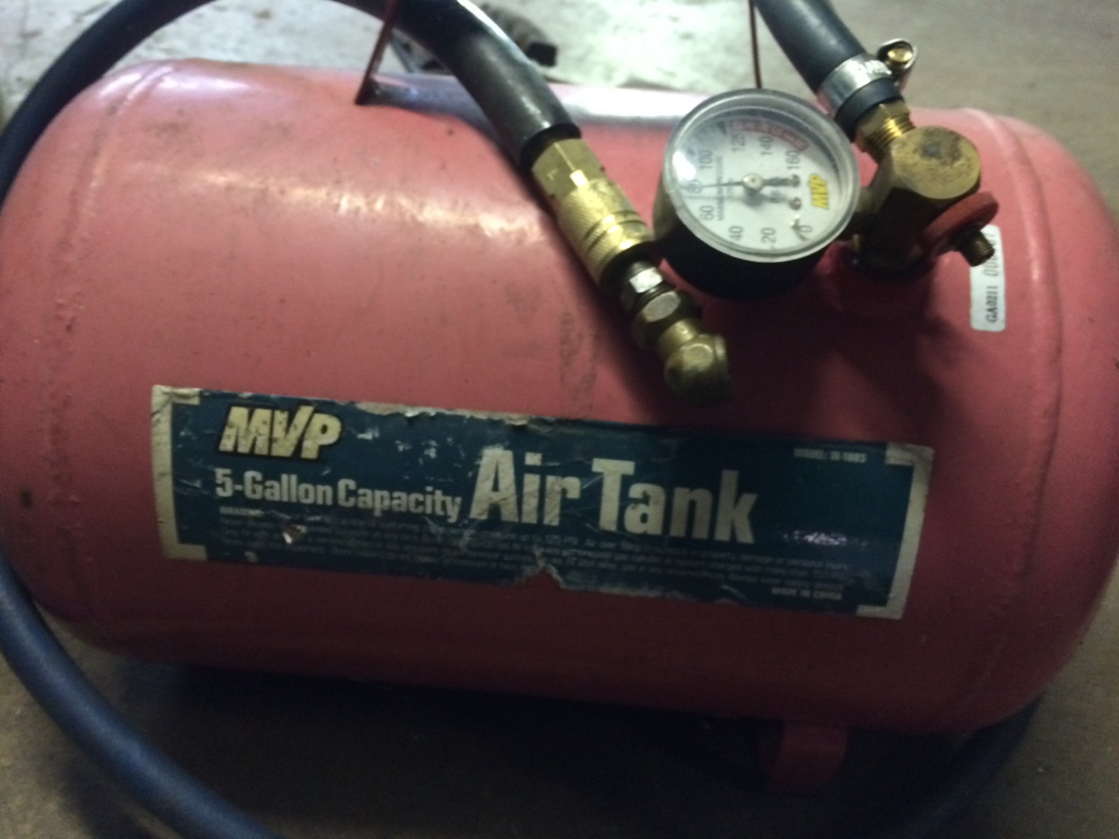

Air. Last year I drove 3000+ miles with no tire incidents. This year I was not so lucky. Having a flat near Mottville MI I was annoyed to have a flat but didn't think it a big problem. A few years ago I bought a foot pump to carry in the car. A couple of years ago I had to use it, and it worked well. Not this time. It would pump a tire up to about 40 psi and no higher. That's not good enough for clinchers. I was very lucky that a local guy saw me and stopped to see what the problem was. He lived just a mile down the road, and brought a bubble with 100 pounds of sailboat fuel to blow up my tire. I'm not counting on being that lucky again. I'm looking into an old time spark plug hole compressor. I've read that they're not made for cars anymore due to some problem with catalytic converters, but they're still sold for motorcycles. I aim to pursue that possibility sometime after Hershey.

This tank would work well.
I use it mainly in my house garage where I don’t have air. I took the original hose off and added a little longer piece of regular air hose with a quick disconnect so I can put an air gun on it or whatever.

Looks like you're going to need one of these too ...

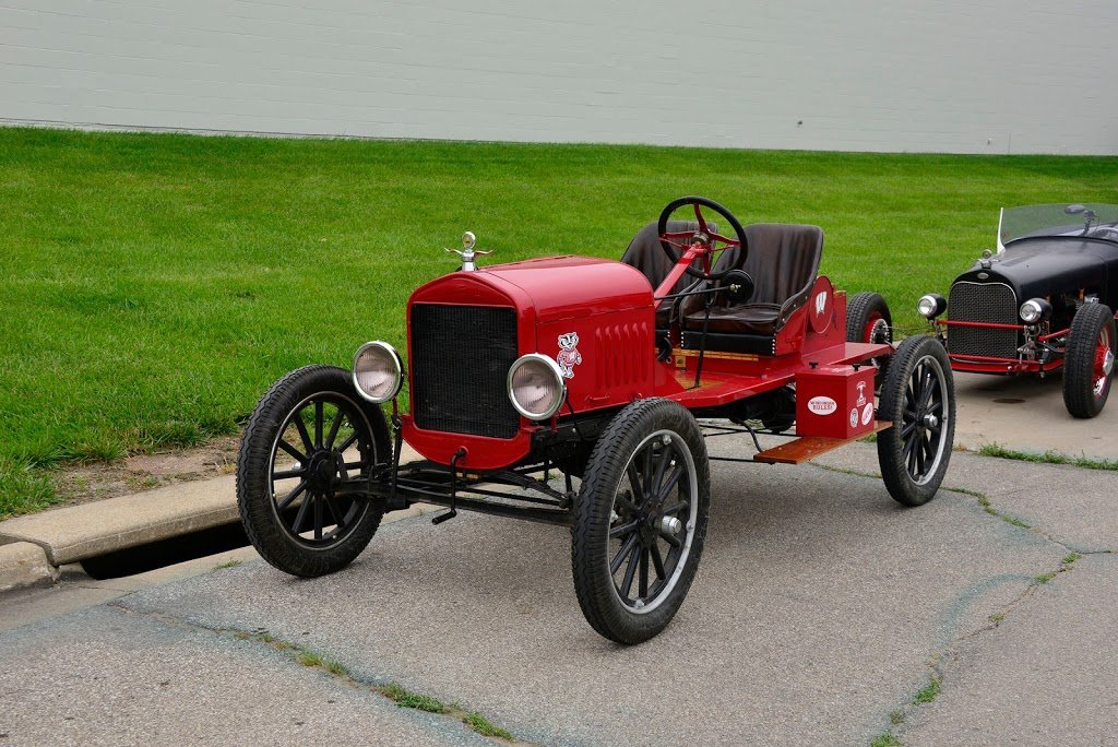

Chad, here is a photo. 40 mph is fine with me.
It doesn't carry as much stuff as a touring does, what with tent, suitcase, etc.

Ahh you have tons of room, a buddy and I drove my speedster into Yosemite for Christmas. Yes, it was a bit cold. We had suitcases tied onto the back.
