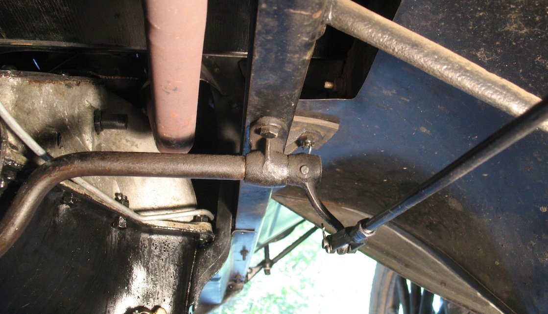

There's a saying that with a Model T two gallons is plenty and one gallon is not enough. I always carry extra gas on the running board, so if I get down to the sputtering point I put in two or three more gallons and refill the can at the next filling station.
Some people will hate this, but I avoid vapor lock by running the fuel line under the exhaust pipe. As you can see, there's a lot of space between them.
