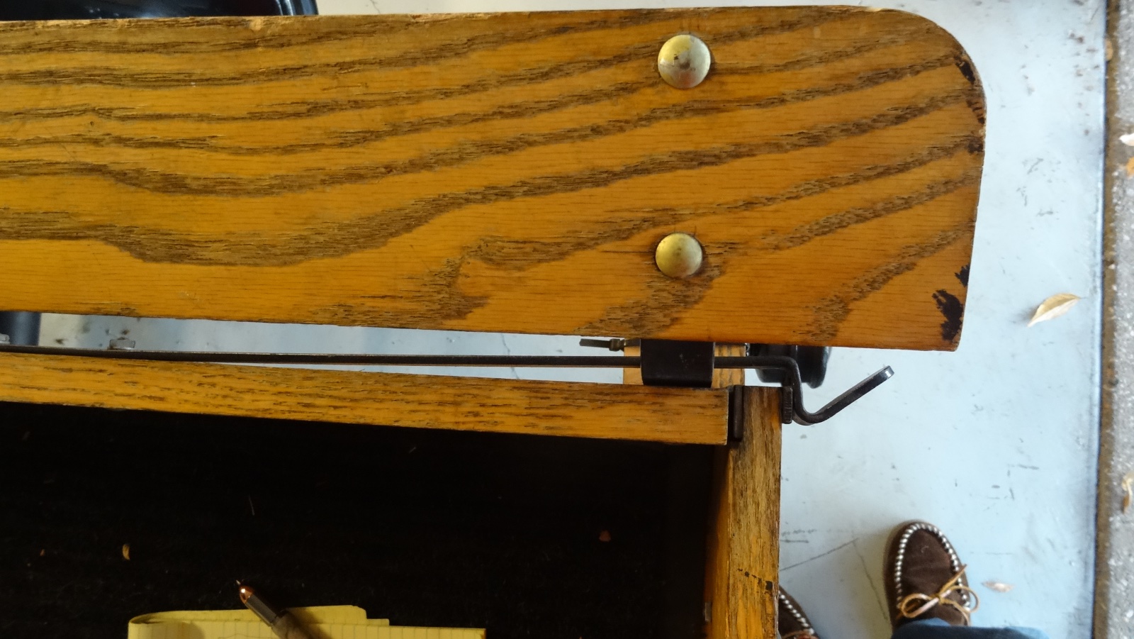

Here's an alternate Idea for closing the tailgate on a wood pick up box. It works great. Push the latches out to open and "slam" it to close.

That’s a dandy. Is there a raised bead that sort of locks the brackets closed on the tailgate hinge once you slam it shut?

I did mine that way and it works really well. Takes a little tweaking to get it just right but it is a great option in my opinion.

It doesn't need a bead or shoulder as it will only open when both latches are pushed outward at the same time. Also doesn't require much of a slam, in fact mine closes with a firm push.

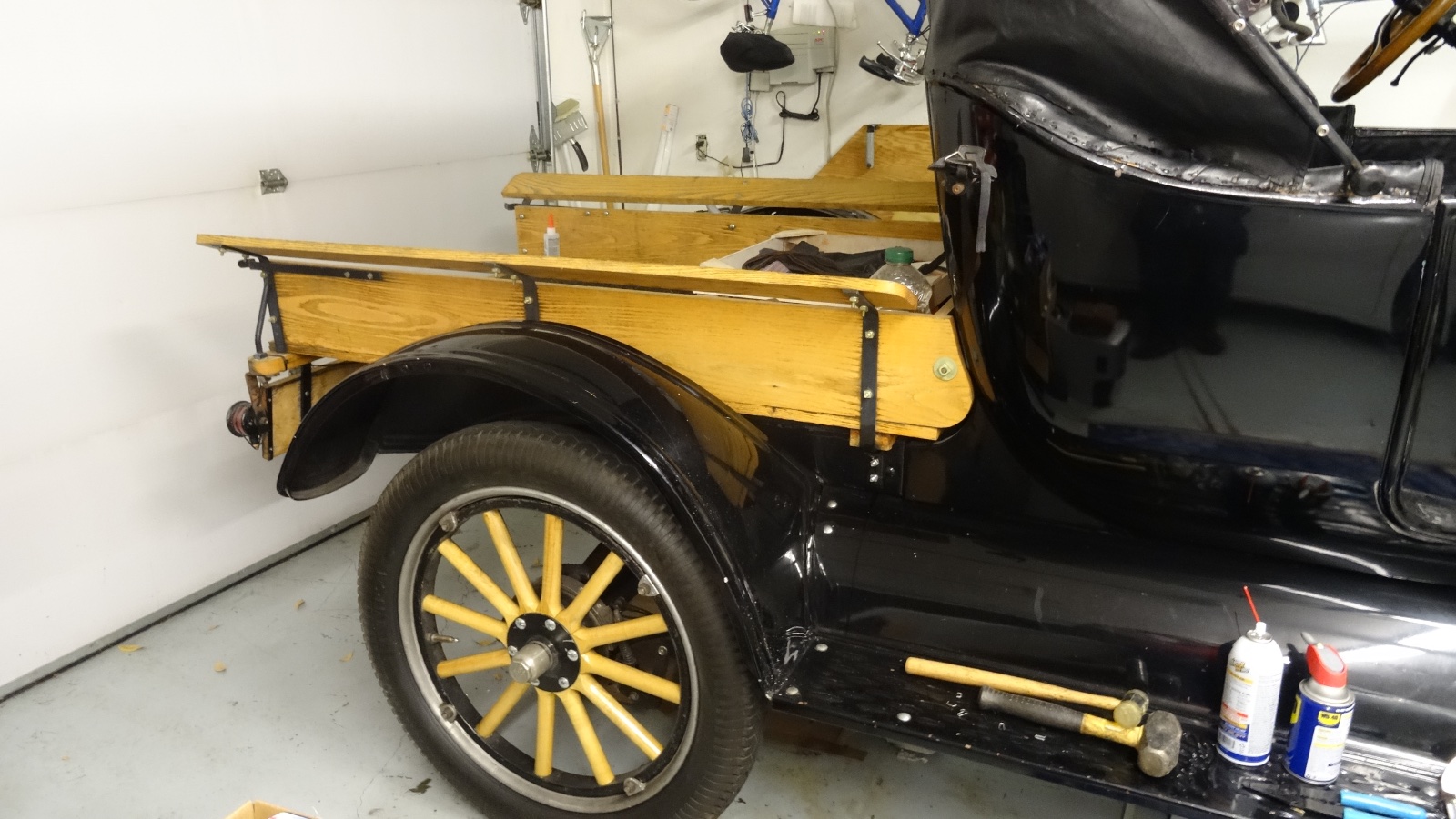

The picure above is my Speedster box and is about 3/4 the size of my Runabout. Here's a few pics of my Runabout:
DSC00677.jpg[/attachment ][attachment=1]DSC00680.jpg

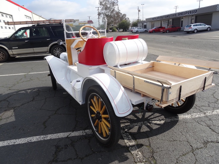

I found a picture of my speedster with the box.

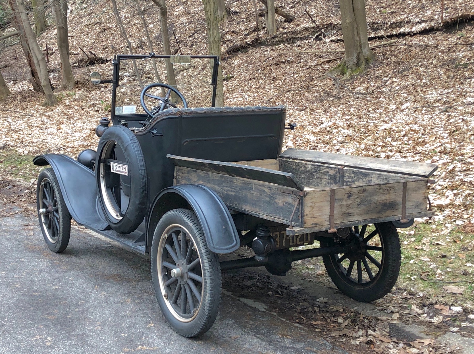

Re: Another Way To Close The Tailgate
Post by John_manuel » Wed Oct 02, 2019 9:01 am
My gate hangs down like that when it is open. Does anyone have a clever way of supporting it level with the bed? I would rather not use chains and thought of fabricating some sort of pull out or spin out support. I also toyed with a bracket of some sort which would attach to the gate and slide through a retainer on the inside of the bed. Any one done this?
